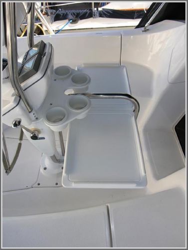

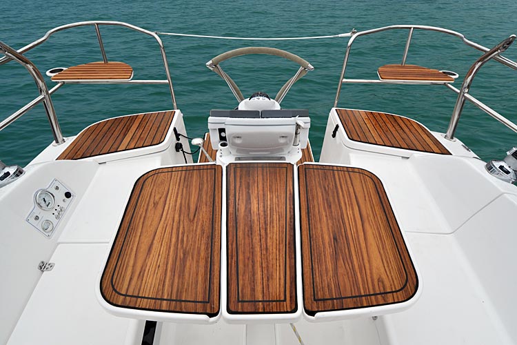

I have a 2009 Hunter 33, and after a couple of years of frustration, have decided that it's time to make some modifications to the cockpit layout. There are two specific issues that I want to address.
First, the placement of the C80 is directly in my line of sight if I want to sit down directly behind the wheel while at the helm (it is mounted high on the pedestal above the other instruments). This means I can either stand all the time, or sit to one side or another - both of which I do, but for long trips, I would prefer to be sitting directly behind the wheel. Alternatively, I could create a 12-inch-high cushion for the helm seat, which isn't ideal. I noticed that the new 2011 H33 has placed the C80 on its own mount (available from NavPod) sitting on the cockpit table behind the other instruments. This seems like a decent option, although it does take up a fair bit of space on the table. Has anyone made this modification, and if so, what are the pros and cons? Alternatively, NavPod sells a 24" wide pod that accommodates the C80 and 4 S60 instruments. I'm thinking this may be too wide...
Second, the cockpit table is more useful as a foot brace while underway than it is for dining in the cockpit. With both sides extended, it provides little space and no comfort for even two people to dine, due to the placement of the cup holders (which I will be taking out), as well as the central post that supports the table. In addition, while extended, the table prevents any movement in the cockpit (in fact, getting out from under the table is all but impossible without collapsing the sides). To fix this, I want to make a new table similar to that which exists on the new H33 - longer fore to aft with less side overhang. I also have a second option here - to eliminate the central post and create a table that folds down into the front of the instrument console. First question - does anyone have any templates for either of these modifications? Second question - I've only seen one H33 where the central post (table support) was taken out. While it seems to provide much greater freedom of movement in the cockpit, has anyone tried this and found any detriments (such as the lack of a foot brace while heeled)?

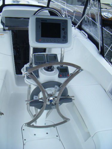

I took the navpod out last year, running a wire for the VHF DSC and was amazed at how much it opened up the viewing. The new 33 that was at the Toronto Boat Show had the same pedestal as ours. The second pic has the space for the upper bar, just not installed. The first one I think was just a prototype, although it has the upper bar.
Haven't done any of the changes, but have wondered about them. We would miss the cupholders tho, as they become a catch-all for all kinds of small stuff while we're out. I think we would miss the foot brace of the table legs.... use it all the time. I do like the idea of a narrower table. Typically it's only 2 of us that eat in the cockpit. If we have friends on board we usually eat down below where there's more room.

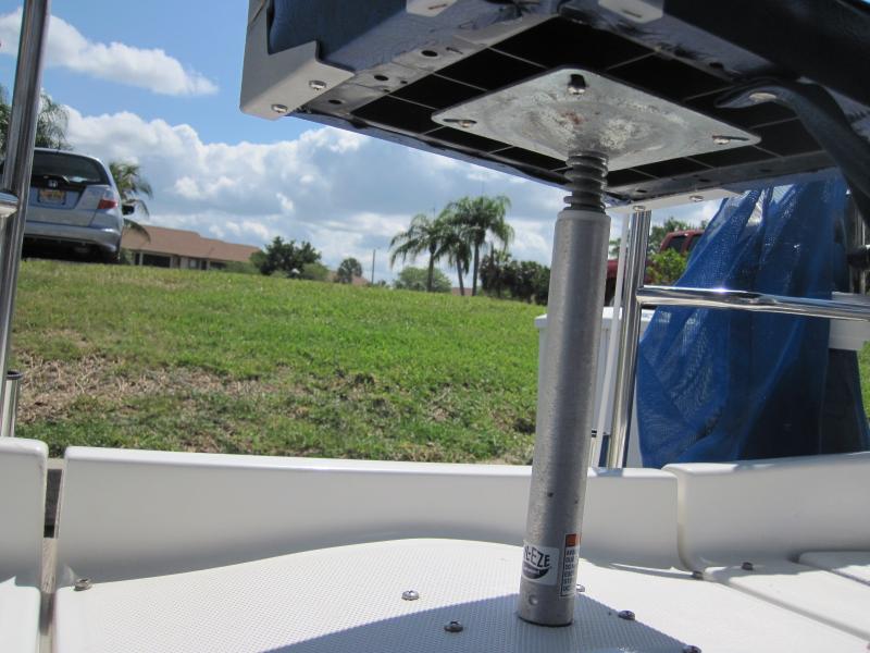

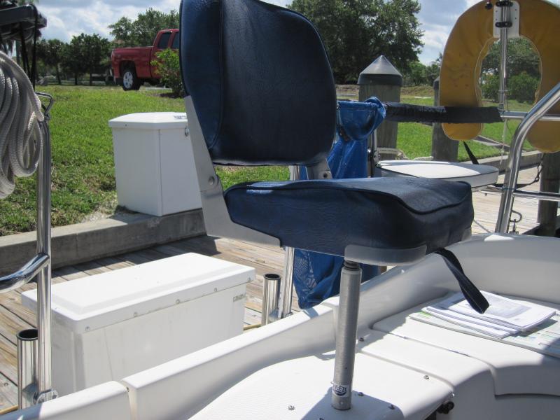

I solved the sighting problems, I bought from Helm Seat a seat that mounts[removeable] to the back rails. It is solid and comfortable. I had seen it on a friend's Catalina and tried it out. My wife loves it as she can now see the pointy end of the boat.

Excellent ideas - thank you! The inclusion of photos gives me a much clearer picture of what I will face. Scott B, do you have any that you can share of your mods to the C80 placement? Also how much work and expense was involved? The option of adding a helm seat or cushion seems like it might be the easier route at this point...
I only removed the Navpod and handle to install wires down the pedestal support. I reinstalled everything once complete. Pics I was refering to were form the original post pictures from Hunter.
Only other option I might consider would be smaller table. We make sure we lock the support rod under the spring clip under the table anytime we use them now and don't try to stand up with the table in place. So far we've managed to finish most meals.... ;)
