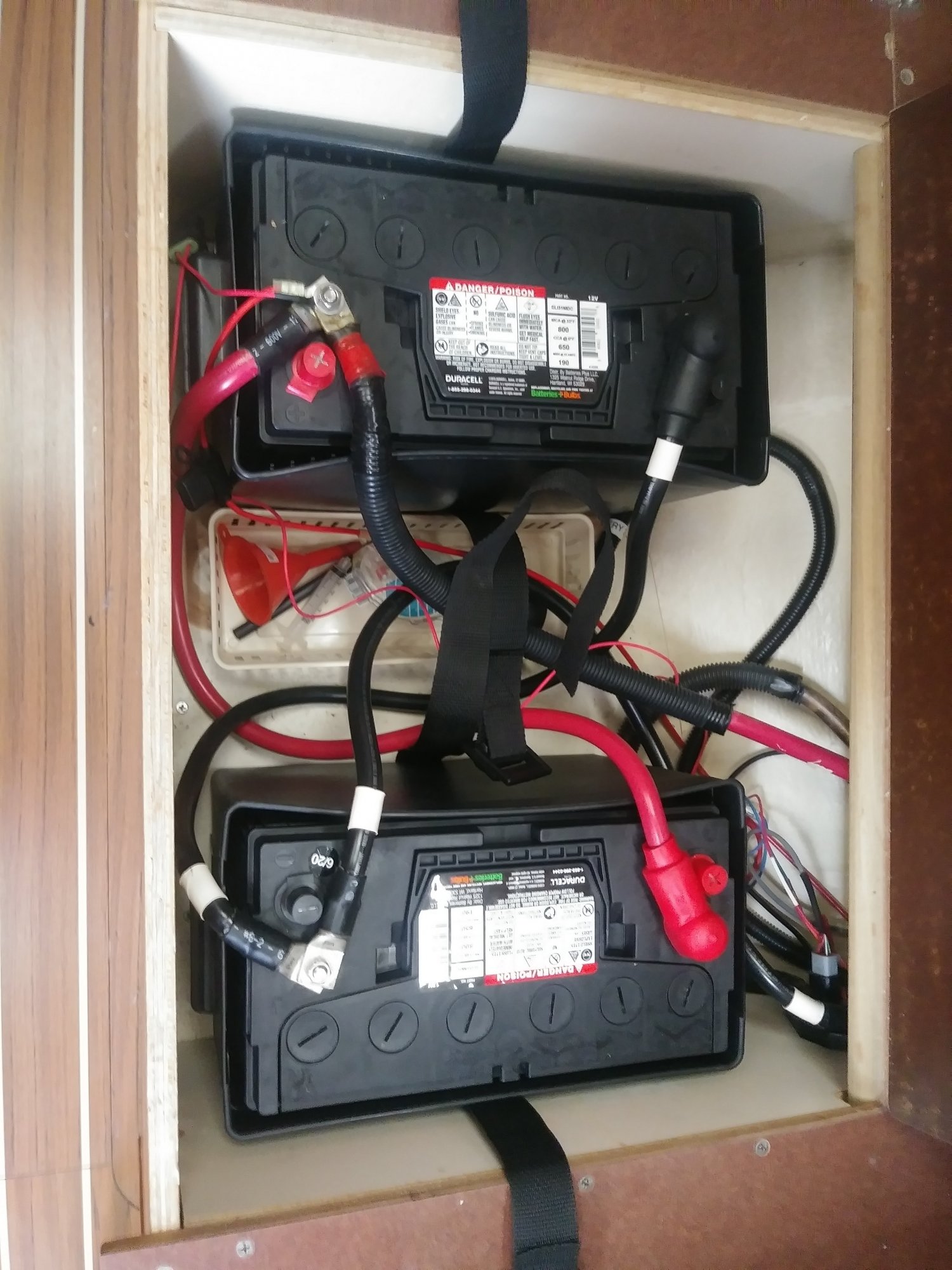

Hello all! We are new to this forum and recently purchased a new-to-us 2005 Hunter 33. I would like to setup a decent battery configuration for day sailing, with the occasional overnight. Today we have two Interstate SRM-31 deep cycle lead acid house batteries, which offer 98Ah each, but realistic power with parallel configuration is 50%(?) so 98Ah total I assume. I'm hoping the group could answer a couple questions:
  1. The boat does not appear to have a separate starter battery? Is this common with the Hunter 33?
  2. I would like a basic solar configuration to help with battery charge while under sail. Unless my math is wrong, I believe I would need 200 watts of solar just to recharge these batteries in ~8hours. Does anyone have a similar configuration they can share details about?
I am concerned about power use, especially considering there does not appear to be a spot for a starter battery. While sailing, I believe we would need to rely on the batteries for:
  1. Lights. We have replaced all bulbs with LEDs. Of course they won't be used during daytime hours.
  2. Instruments (wind, depth & speed) but we will use Navionics on an iPad as our primary navigation.
  3. VHF Radio.
  4. Fans 4x12V in the cabin.
  5. 12V fridge, but we will likely bring a cooler for day sailing.
For now, I thinking (with a great amount of hesitancy) these batteries will suffice based on our projected sailing activities for the upcoming season, so I would like to keep on to a fairly tight budget. Any thoughts or advice would be appreciated! :rolleyes:

What are the dimensions of the battery space you are using? Looks like you have a bit more room in the box then the batteries currently stored. Our member @Maine Sail has provided a response to batteries here with a lot of data on their capacities and make up. More info is on his web page at Marine How To - DIY for Boaters - Marine How To.
My take on this in a practical way. I have limited space so if I select the 6 volt battery I will need 2 of them to get me 12 volts. If I choose a 12 volt then if one battery goes dead, I may still have a second to serve serve my needs for a while. Lead is the heavy part of a battery. To get a battery in the 65-75 lb range means more lead is used in it's manufacture. The plates are bigger. They can provide more cycles. They will be designed for deep cycle service. Then I explore the best size to fit my space. Next I look at the specs for the capacity at 20-hr discharge rate. I know that I will only get 50% of the capacity in regular use. Having narrowed the specs down to what will fit on my boat I prioritize the price of the battery.
I found locally in the NW that Dyno a manufacturer in Seattle makes a battery for Sweeper and Aerial lifts that meets my criteria. At about $160 each they give me 135 Ah each or 135 Ah to consume with 2 batteries. That means I can sit at anchor for about 2.5 days without starting the engine. A small light weight (35 lb) starter battery is all that is needed to kick over the diesel engine.

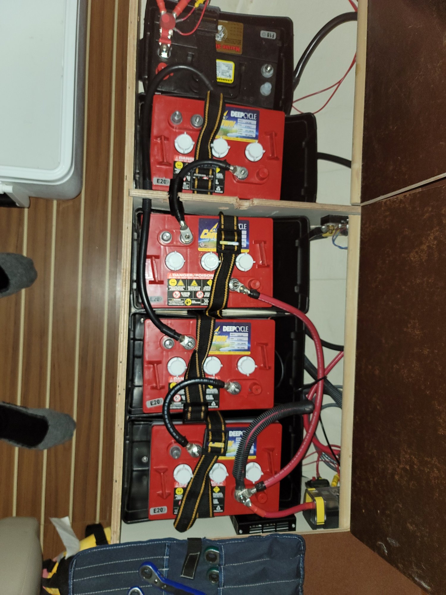

Sep 20, 2006
2,952
Nice boat, we've enjoyed ours for 14 yrs now. I have 4 Crown golf carts under the settee beside the chart table and a Group 27 start battery that only gets used if everything else dies. I have a 350w solar panel mpounted above bimini. We anchor out all the time and run fridge 24/7, the top load freezer runs partial as a fridge, lights, occasional movie on the tv, stereo etc. Typically have 100% charged by 11:00 each morning and could go a couple of days in cloudy weather. We've been out 5-6 days without having to start the engine and are only restricted by holding tank, water tank and beer supply.
A couple of golf cart batteries will give you 220 ah. and yes I would definatley hook up a 3rd start battery for emergency use only.
