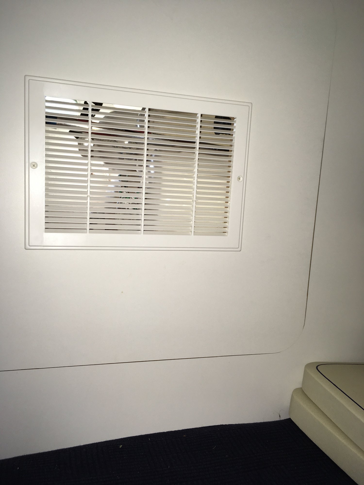

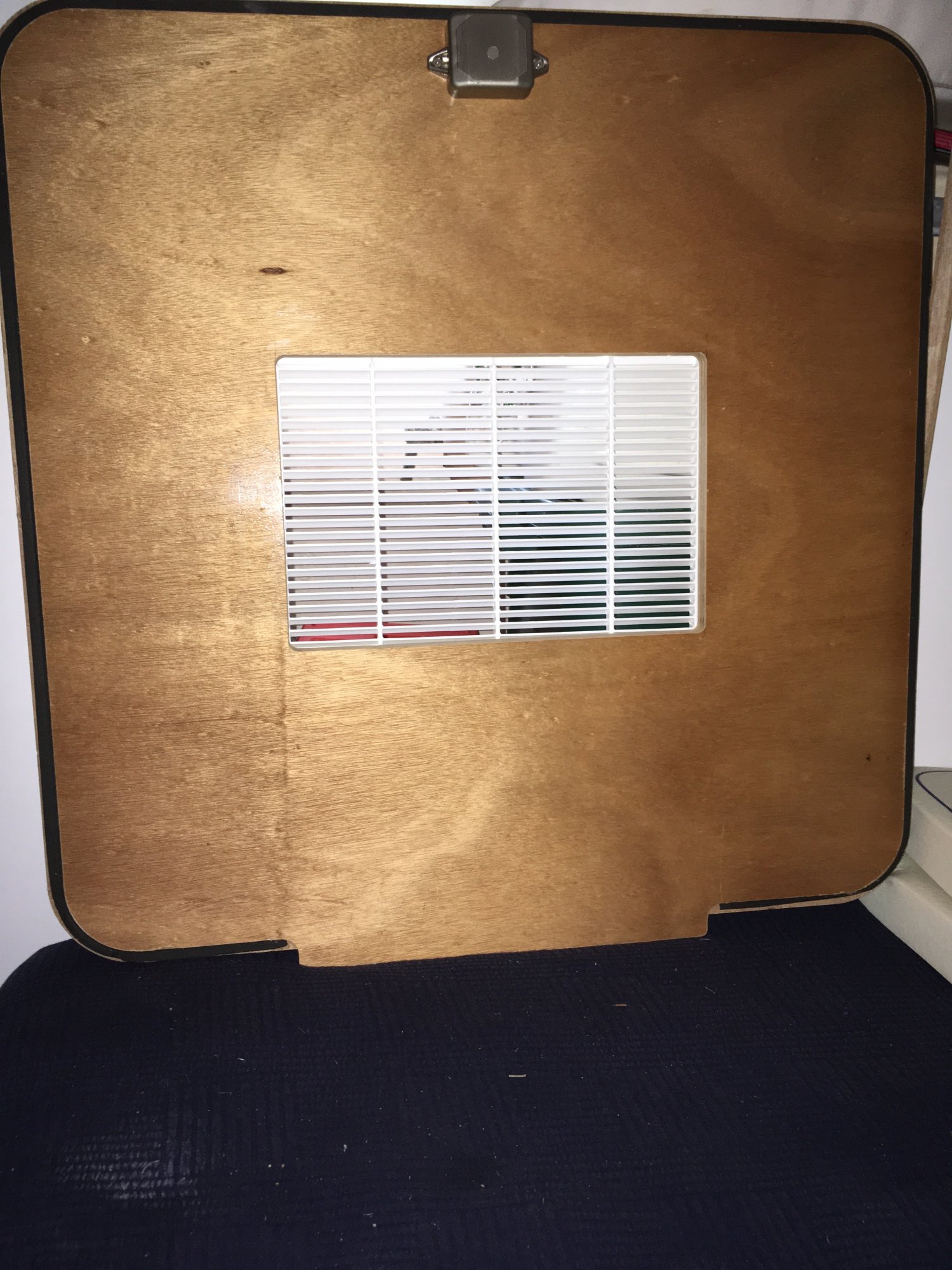

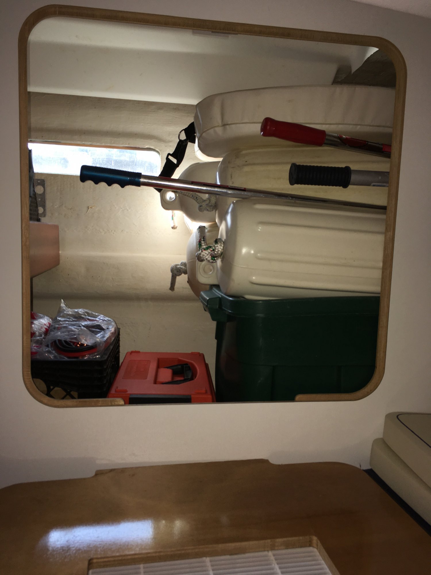

I had an ‘88 hunter 33.5 years ago. The stbd lazarette is huge, same as my current boat. My present boat has a Factory installed removable panel to allow access from the aft berth to the lazarette. I estimated the panel size at 2’x2’.
I added a vent as I have an air handler on a shelf in the lazarette that supplies A/C into the aft berth. The cold air duct is not visible in the photos; the white vent that I installed on the removable panel serves as a return air vent for the air handler in the lazarette that is fairly air tight.
