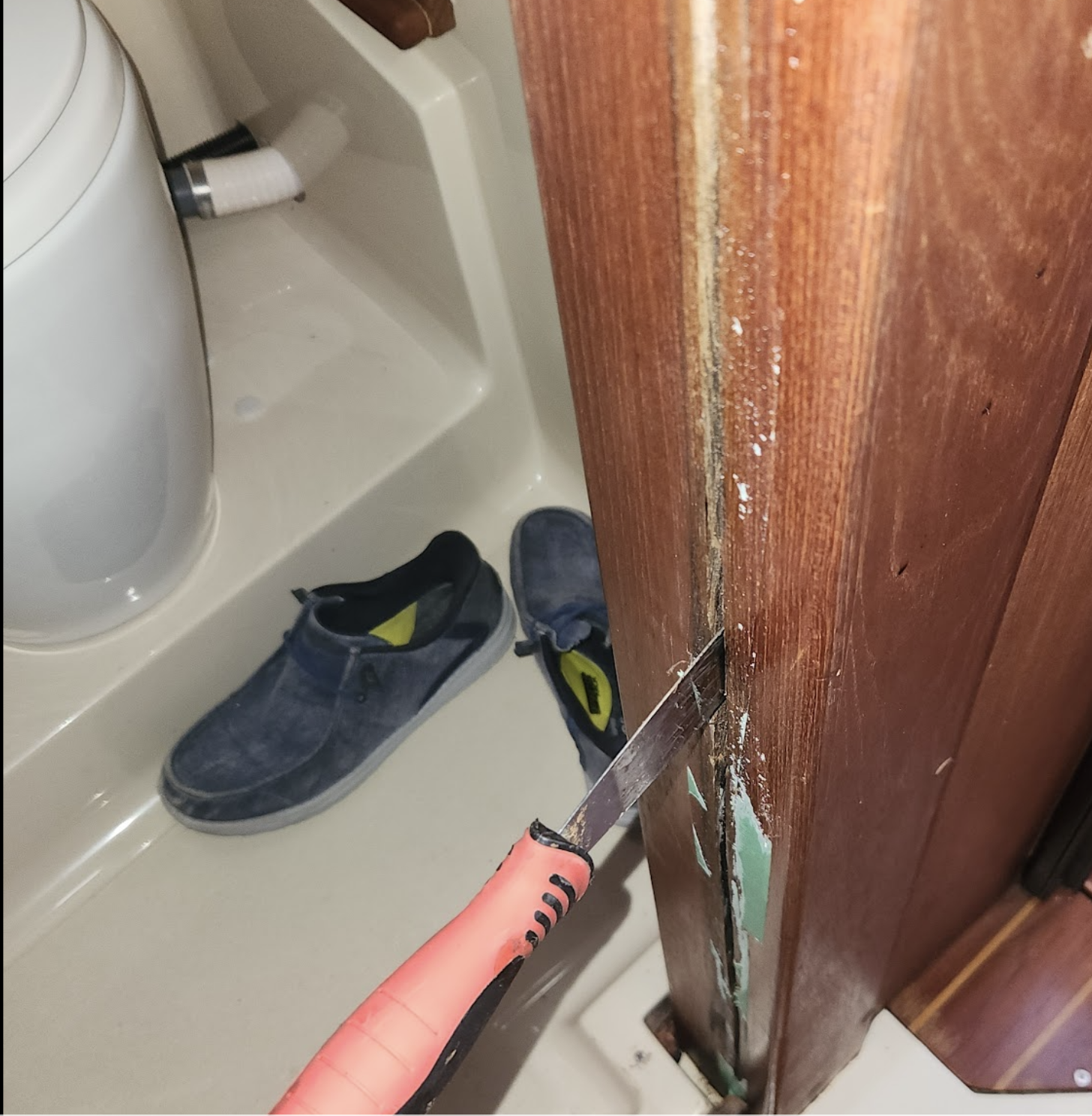

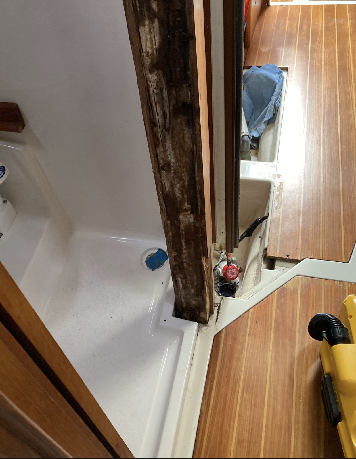

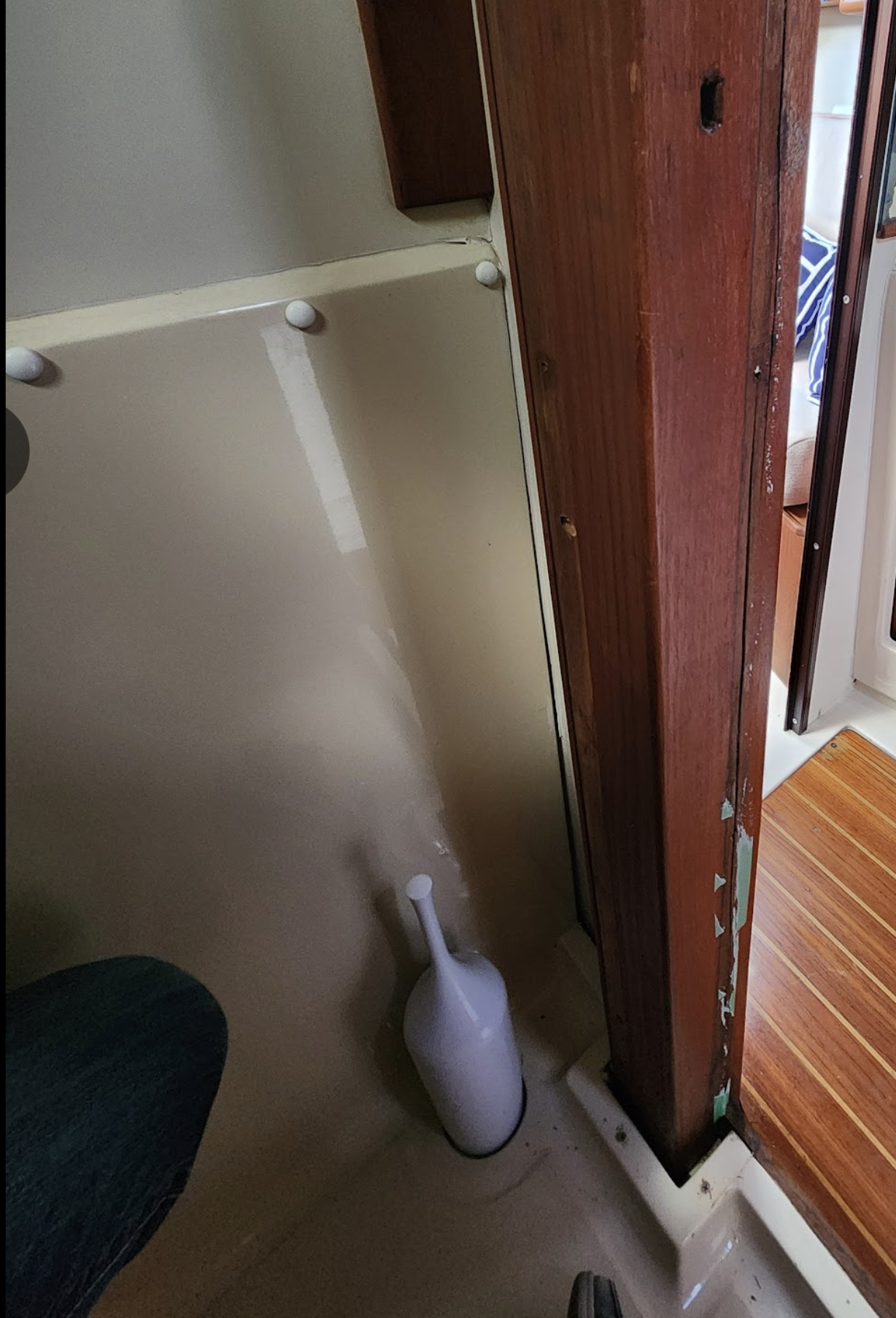

I discovered significant rot in the wooden compression post on my 1990 Hunter 33.5, likely caused by a long-term skylight leak near the mast step. The upper fiberglass structure and lower pedestal appear intact, and there is currently no obvious deck depression.
The post is approximately 3¾" × 4", and at the worst area I measured roughly 2" of internal rot, with sound wood remaining behind it.

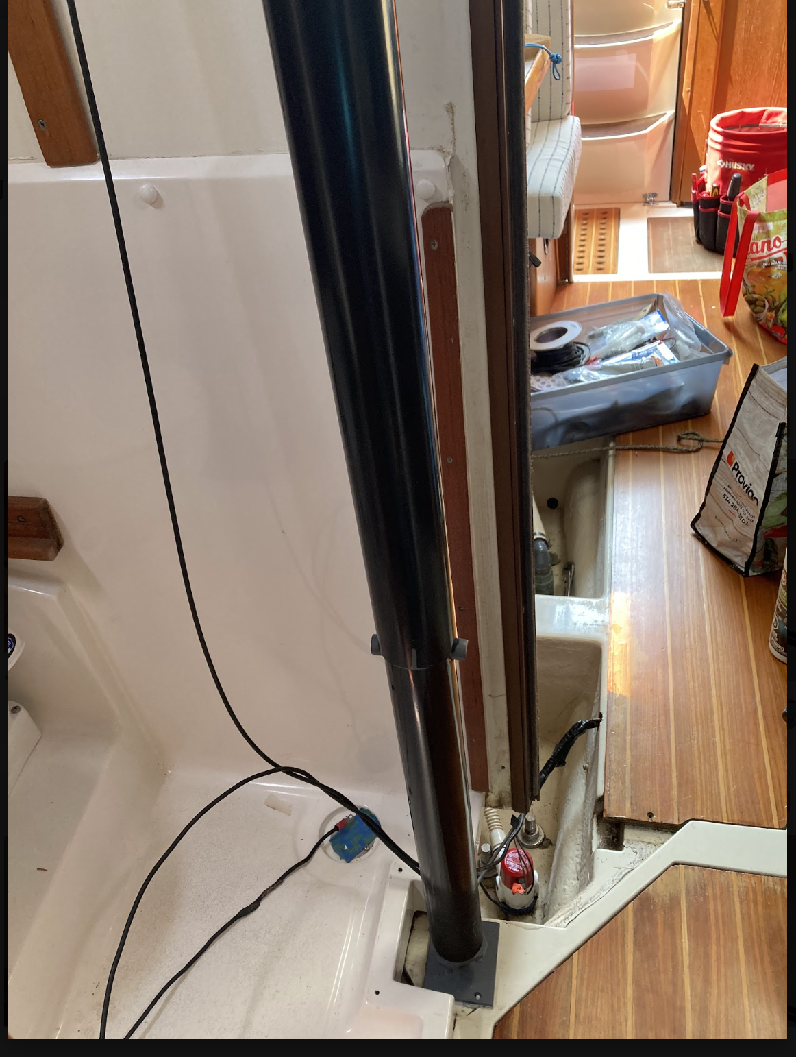

I’ve been researching repair options and found another Hunter 33.5 owner who replaced the post with a permanent adjustable steel jack post after removing the original wood post. He did this with:
  • a steel load-spreading plate at the top,
  • adjustable steel post,
  • steel base plate at the bottom.

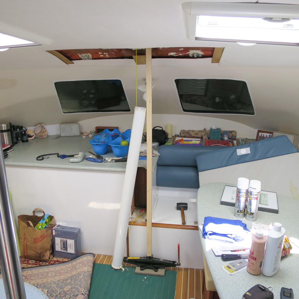

I have removed a compression post from our previous boat (40' catamaran) without removing the mast. If you loosen the rig, the only compression that needs to be overcome is just the weight of the mast, and this isn't much. I used a scissor jack and a 2x4. I could get the 2x4 directly under the mast step. I can't tell if you can do this, but you do want the support under the mast and not just on adjacent deck. Also, our post was chocked in place top and bottom. After removing the chocks, I only had to raise the mast/deck a small amount to remove the post. I can't tell if you need to raise it a lot or not.

Thanks for the info everyone. I think I’ll be going along these lines, installing a jack post permanently. Sry for not being clearer.
My concern now with this sister ship retrofit is lightning strike protection!!
