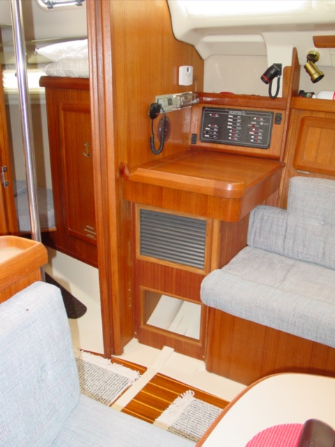

Amos Cape, I have the same boat. Same year also. We raised the nav-station and built a shelf underneath to support the 16,500 BTU unit. From this location I ran 3 vents. One to each cabin. Installation of the plumbing and electric is also pretty easy. Sorry I don't have pics handy at the moment but have posted them on here before.

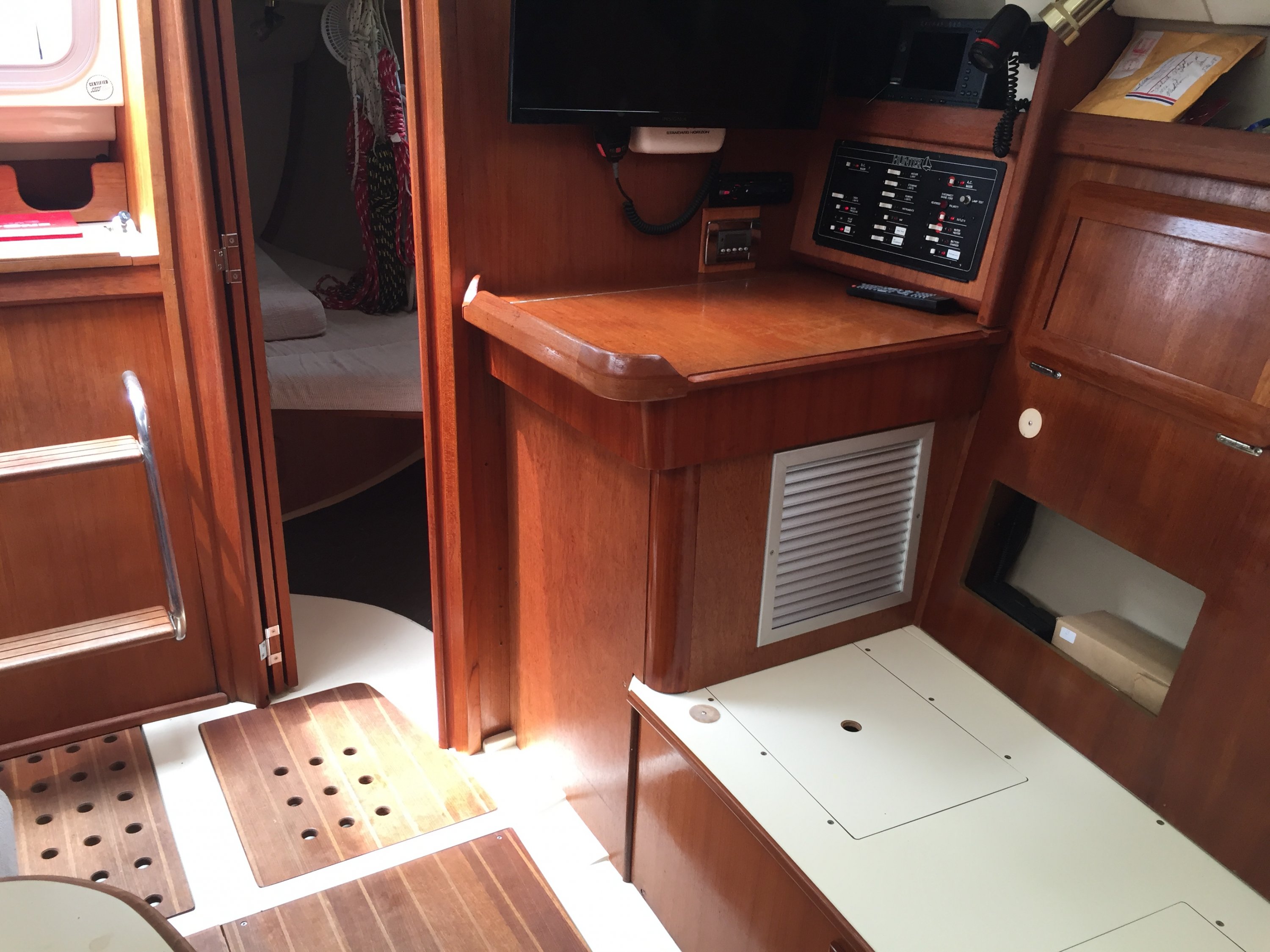

We raised it till it met the under side of the electric panel. About 6 inches. The shelf for the A/C unit is the same height as the port settee. This left space below for shoes and such. I found a picture of the finished installation.

That is very nice work Jeff. What kind of wood was used for the new area that you added. It looks to be a very good much.

Mahogany plywood for the cabinet box and Teak for the trim. Then I used Lemon Oil for the finish.

There are three 4" vents. One in each cabin. The plenum of my air conditioner allows for three connections. Since the aft cabin hanging locker shares a bulkhead with the A/C unit I ran two ducts thru it. The first vent feeds the main cabin and is visible in my picture. It's located just below my radios. The second duct run in the aft cabin locker comes out the back of the cabinet near the top feeding the aft berth. The third duct run is located behind the settee cushions and under the bottle storage area. Several 4" holes need to be cut. It continues thru the head sink cabinet and into the V-berth port cabinet. My cabinet has several shelves in it. I drilled 4" vertical holes thru them to allow the vent to exit the forward side of the cabinet near the top. It sure is handy that these cabinets are screwed together. With a little disassembly the drilling process is a bit easier.
Here in the mid-west my 16,500 BTU unit does a fairly good job. It gets rid of the humidity in the heat of the day and allows it to be some what comfortable down below. The thermostat climbs to the upper 80's. I did install exterior Sunbrella mesh hatch covers on the cabin roof to cut down on the solar gain. At night this unit will freeze you out. It'll take the boat down into the 60's without missing a beat.

Jeff that was the best location for this boat for shore. I installed 4" pvc for the ducts. Installed four vents, two in the main area one in the v berth and the aft. Thanks for all your time.

Amos, I'm happy this install went well for you. It looks GREAT!!! Glad you contacted me and I was happy to help a fellow sailor. I'll bet it's quite comfortable sleeping with the A/C.
