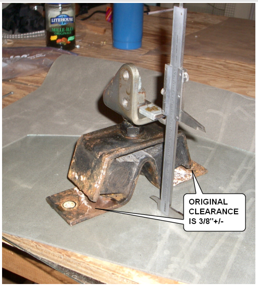

First step is what caused the misalignment ? The motor moves the most. The shaft not so much so ignore that for now. While you are disconnected, does the shaft move vertically or horizontally ? What do your motor mounts look like ? Is it close to these clearances ?
Does your engine move around easily with the shaft disconnected ?

What is the engine, a 2GM-20F? Do not start replacing parts wholesale. I would have the prop cleaned and balanced. check the valves lash in the engine. Inspect the motor mounts for breakage and softness. ( to test mounts lift the engine up at the mounts with a pry bar, if the mount is broken it will separate and lift clear. If it is soft it will stretch and elongate.) Align the engine and shaft until the shaft is turning in a concentric fashion with minimum wobble. At this point you have not spent in new parts and you may determine whether there is adequate improvement or not. For a 20 year old boat a certain degree of vibration in the drive train is anticipated. If you are not satisfied and decide to replace parts, do the motor mounts first and realign, follow with the cutlass bearing , and leave the shaft replacement for last as a last resort.
