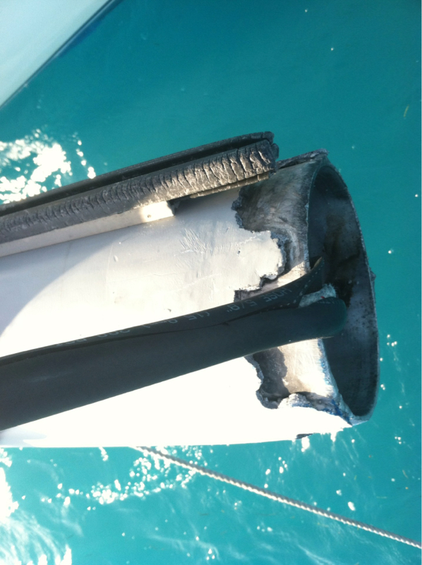

Hi all, I'm seeking advise on a Hunter Vision 32 I purchased back in December (my first sailboat). Last month she de-masted about 12' above the deck where a previous owner had made repairs after hurricane damage. New mast are no longer available and I have been unable to locate a used mast. If anyone knows of a salvage mast or even a lead on one that would be fantastic! Otherwise I'm looking for a shop to do a proper repair on a spun aluminum free standing mast? Advise?

The mast on our HV'36 is sleeved so I don't see any reason why a shop couldn't do this for you.
You may want to do like Ron suggested and speak with a company that make light/signal poles. You next best bet would be a fabrication shop.
I know a fellow tha had a Freedom had to have a new mast made from carbon fiber, but they are not cheap.
What is your insurance company saying about the situation? I would pass the question on the repair back to them.

I assume you already did this, but if not, the place to start is with the PO. If you can contact them, they may be able to point you to whomever did the repair before. This failure should permit them to figure out how to do a better fix this time.
Otherwise, I would tend to look to a large airport and find out who does aircraft repair. They have a lot of experience with aluminum welding and fabrication. I suspect you don't need a new section as much as a repair where the sleeve section is. Hunter can probably point you to the mast manufacturer if a new mast is needed.

I actually spoke with the engineer who designed the masts, they are now Isomat on the east coast. Its a long story but having them rebuild a mast is too costly because of setting up the machining tools for one is mast. The option is a carbon fiber mast. Purchasing the mast isnt that expensive, having it shipped to you, set up, maybe a change in boom, etc is what costs. The price the engineer gave me was $15 to 20K. This guy actually tracks all mast failures made for the Hunter Vision Line both 32 and 36. I don't recall his name but he was friendly enough and I'm sure you can find him thru Isomast. Eddie Breeden at Hunter is the one how sent me down that pathway. Perhaps the mast from a parted out Vision like what Spurgeon Marine is offering is the best solution for you.
