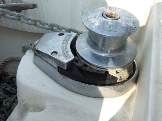

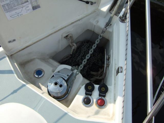

here's pic of my windlass.

Thanks for the pics Ken, now i know what type of windlass to look for. Thanks again. Do you any problem whith your chain since it is travelling a few inches horizontally before going into the anchor locker ?

I find the depth of locker is shallowed by the rodes and chain piling on top. hence has to help flak the chain forward as I recover otherwise the chain will jam after a short wihile of retrieving. not a difficult task anyway.

Thx again for your help Ken. I check with my dealer, and the windlass i need (same like yours) is discontinued, since Lewmar bought Simpson Lawrence they dont make sprint 600 anymore. This windlass was designed for hunter only (Chain exit in the front, and i cant find a simillat model). I need to reconfigure the anchor locher. Thx again for your help and the pictures.
