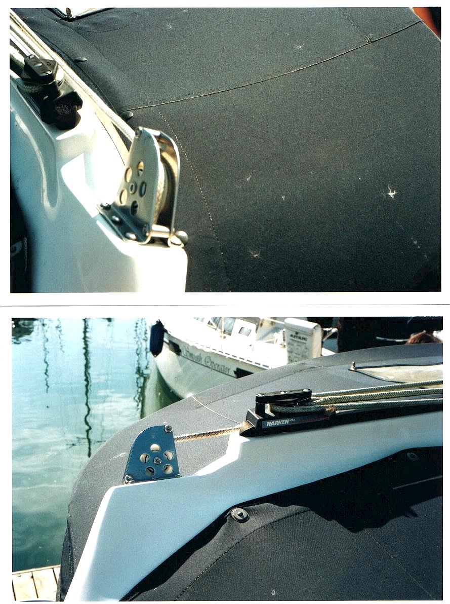

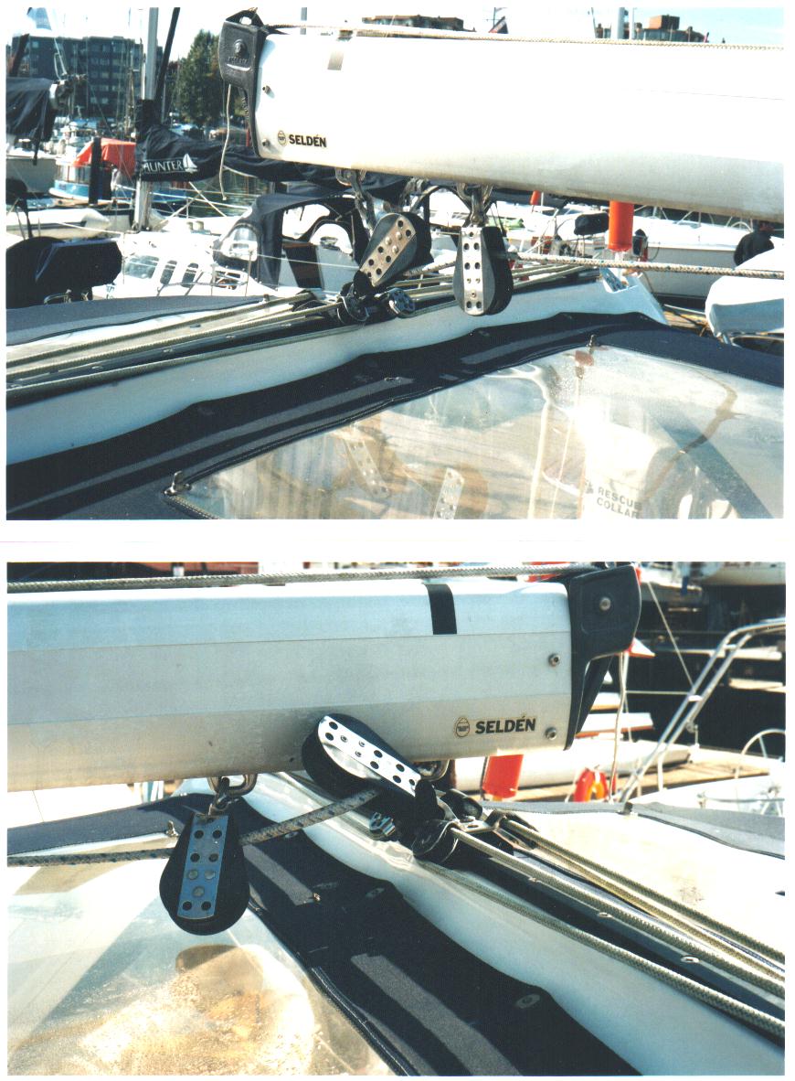

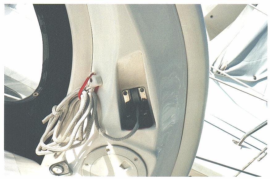

I have a 1997 Hunter 310 with the main sheet traveller on top of the arch. The traveller cleats are part of the track and are also on top of the arch making it difficult to access if the Bimini is installed.
I see from the Hunter drawings that subsequent boats, after hull #216, have the traveler lines run down through the arch and cleated below on the sides of the arch. I am trying to decide if I can modify my arch to run the lines through it to the cockpit and am hoping that there is a 310 owner out there with this arrangement that could send me some photos.
Thanks for any assistance

Jan 4, 2006
7,754
This is not mine but I took some pictures of the demo boat when I was buying mine back in 1999. Shows how the lines are fed down through the FG arch to the cockpit. From what you describe, I don't think it would be too difficult to install.

Thanks Ralph
Great photos and just what I was looking for. Amazing how you always seem to have what I need!!
I will do some further invesrigation. The arch is molded differently from mine to accommodate the entrance and exit points but the cuts don't look so large as to affect the structural integrity. I guess the trick would be to get the internal lines running true without any chafing.
