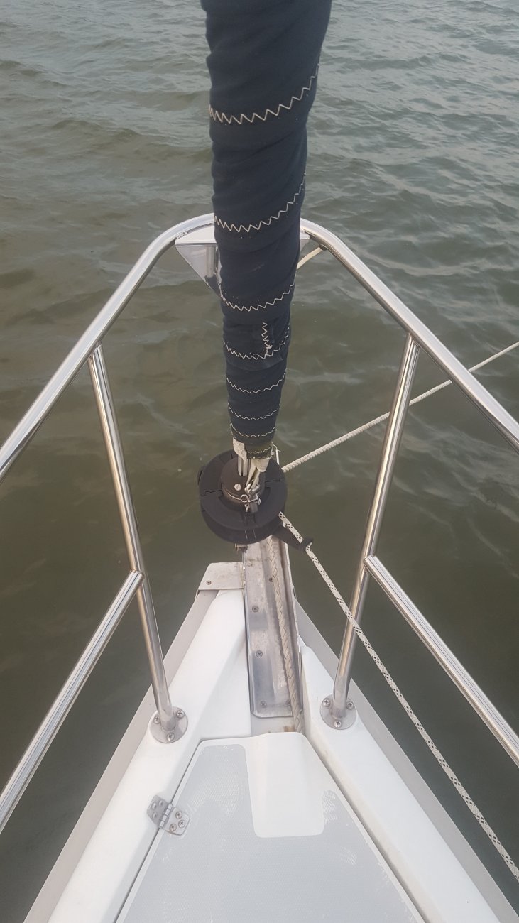

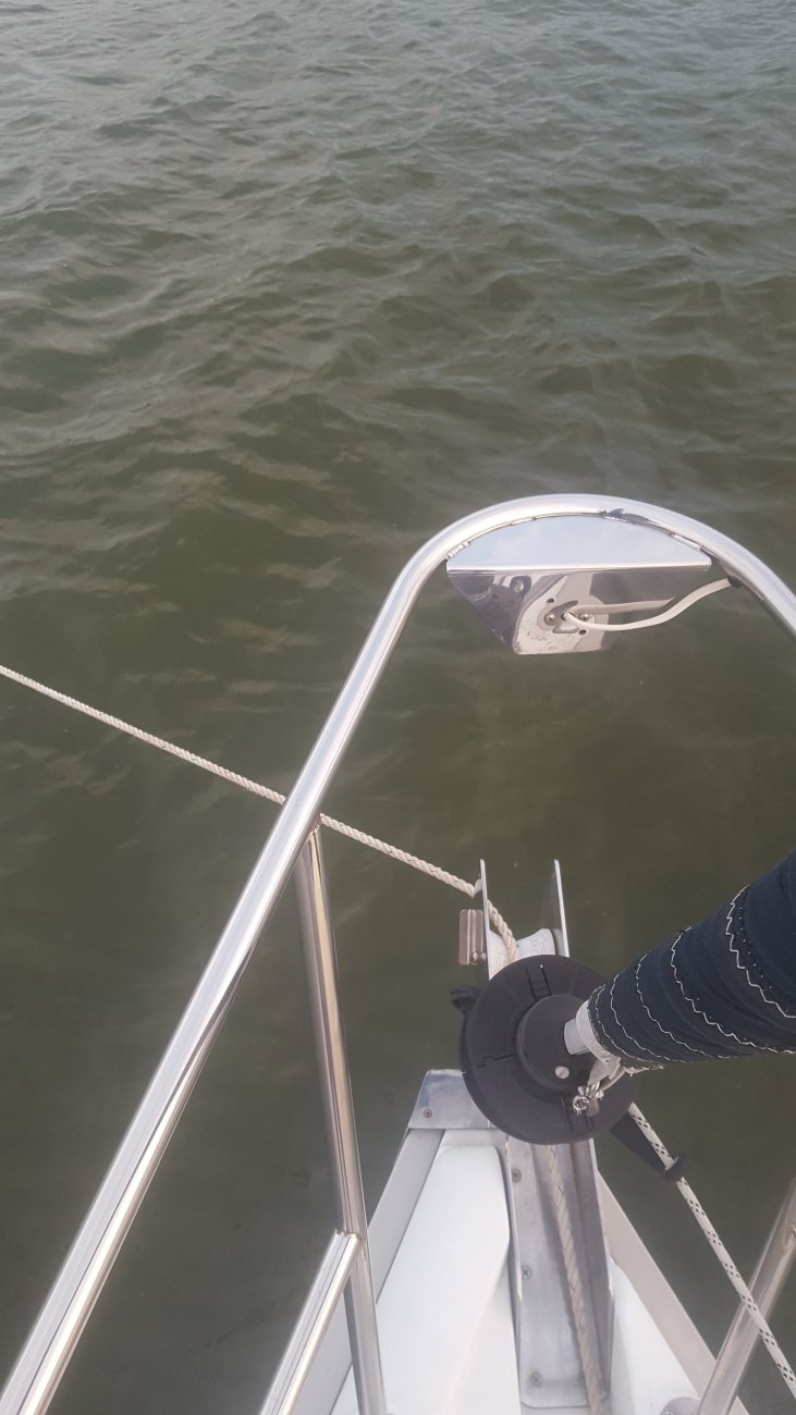

I have a 96 hunter 310 with a shoal keel. One thing I've noticed compared to other boats I have been on is we never stop moving at anchor. Even if there is no wind we just swing back and forth on the anchor line. Is it the shoal keel or something else I'm doing wrong that is causing this. It's very annoying at night because I have a hard time using landmarks to see if were dragging since even in calm water we move side to side.
I've attached two pictures and a video
to show what I mean. You can really see in the video the direction the water is moving and how we are moving perpendicular to it vs being in line with it.
