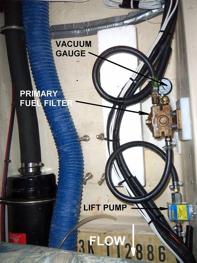

Sorry to be the bearer of bad news , but the stop valve is at the tank. While you've got it shut off, do yourself a favour and install a 1/4" dia. ball valve inside as a stop valve.
Below is a shot of the inside stop valve and an arrangement of how to change out the primary fuel filter with the filter body sitting in your lap. No more fuel draining down into the bundles of wiring as installed in the factory.

Thanks so much @Ralph Johnstone. As it turns out, a friend showed me this afternoon how to change the fuel filters so I can do it myself in future. (YouTube videos were just missing important bits for me. Anyway I do better being shown once and learning hands on.)
So, rather than remove the batteries to get at the fuel tank and the shutoff valve, what we did was merely pinch the fuel line, just before the fuel-water separator, to stop the flow of fuel and that worked great!
