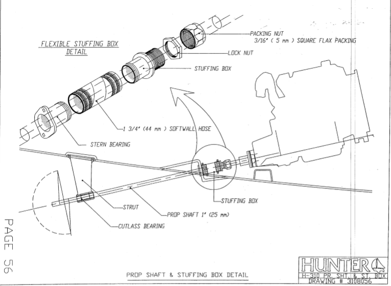

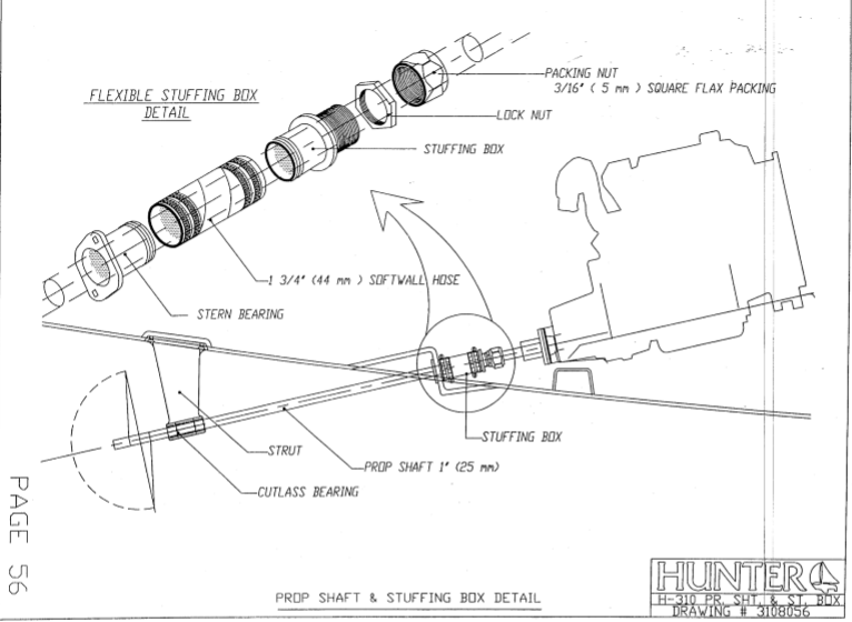

a) stuffing box hose - 1 3/4 inch (or 44mm) inside diameter and around 4 inch (110mm) long
b) cutlass bearing is 1 inch shaft, 1 1/4 brass outside diameter and 4 inch long

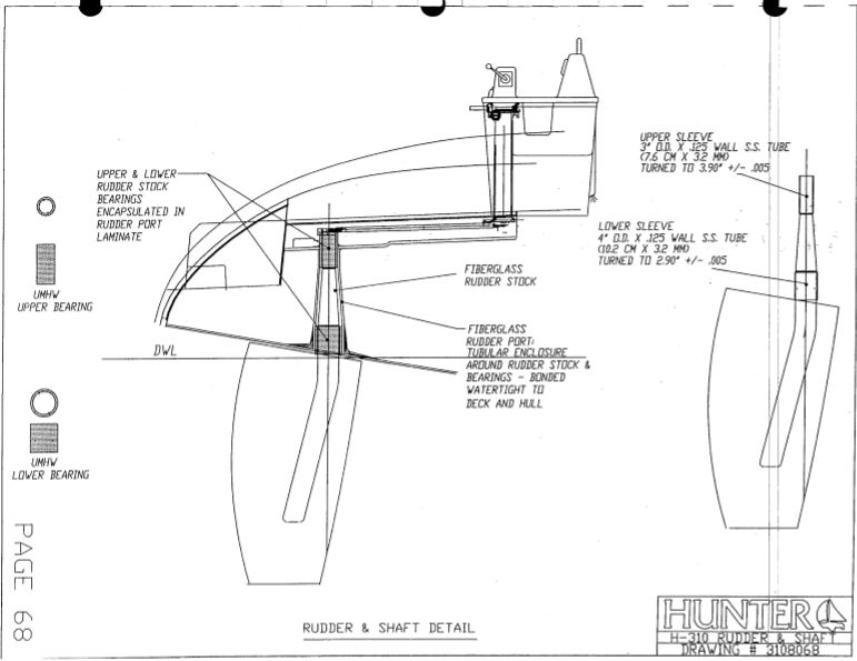

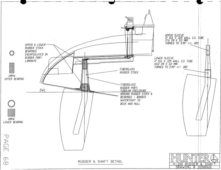

c) rudder bearings (2 of) are 3 inch inside (top) and 4 inch inside (bottom) but what are the outside diameters and length - also, has anyone used a single long bearing in lieu of the 2 separate ones
I've attached extracts of the 310 manual of the cutlass and rudder diagrams noting only partial specs supplied FYI
