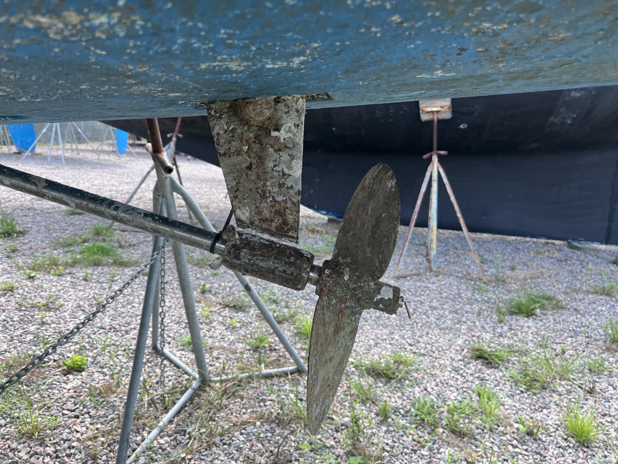

this piece is not detached, and i need to confirm that its steel or aluminum, any experts out there?

What part do you mean exactly? I haven’t heard of a prop carrier assembly by that name. I can think of the prop shaft (stainless or bronze), strut (bronze), stuffing box (bronze or a mix of various materials if it’s a dripless), or maybe the shaft coupling (steel).
May 17, 2004
6,197
The sleeve is called a cutlass bearing. The prop is attached to the prop shaft, which carries the torque from the engine. The “hull extension” is the prop strut. The bearing allows the shaft to spin within the strut.
If the shaft wiggles side to side or up and down in the cutlass bearing then the bearing is probably due for replacement. Some tips for its replacement are at Replacing A Cutlass Bearing (Sleeve Bearing) - Marine How To.

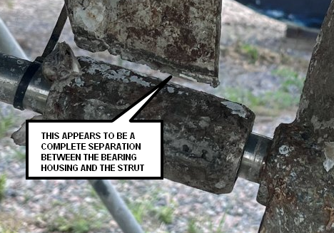

there is a thin line separating the prop cylinder carrier from the hull extension.
From what I see, if I'm not mistaken, the cutlass bearing housing is completely detached from the strut. Most unusual.
Whatever the cause, the prop cannot be turned in the water without causing severe damage to anything within striking distance. The strut relies on its full, initial strength as a complete casting to keep the prop in place.
As @Davidasailor26 has mentioned, the strut is bronze. Brazing it back together is a recipe for disaster. Unfortunately, the entire strut must be replaced.

The strut is usually a single cast piece of bronze.
It is not a repairable item. It is a remove and replace part.
