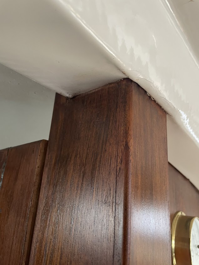

1. The compression post. Here is a picture of the current state. How bad does it look? Should I repair it now (the boat is in Long Island sound) or wait until I get to Philadelphia?

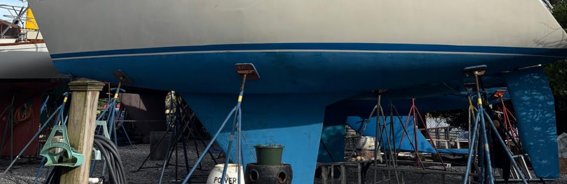

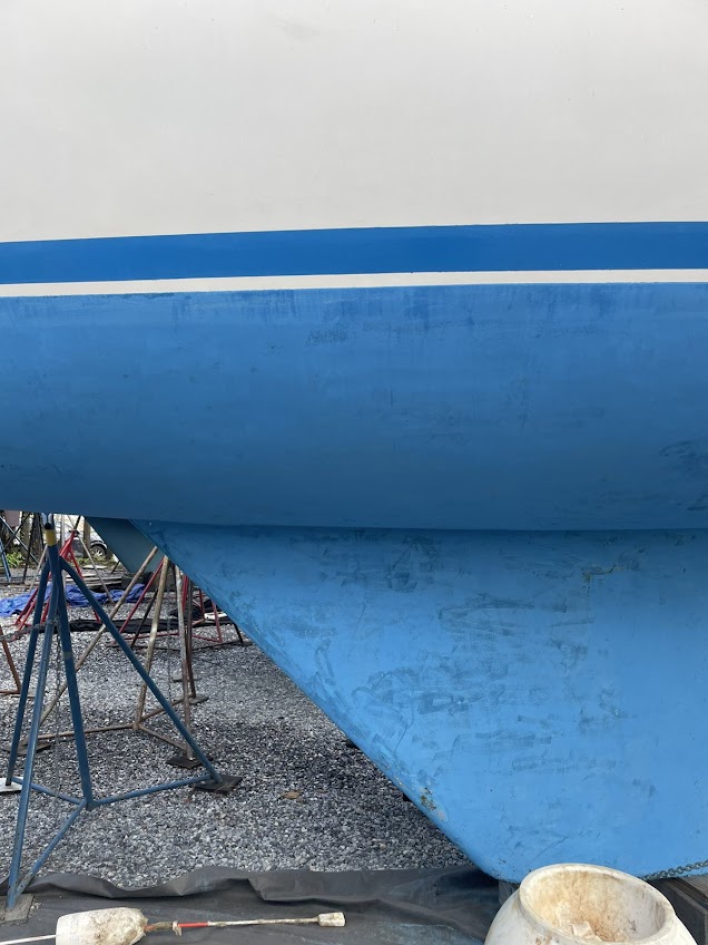

2. Should I stay with ablative paint (as the previous owner did) that I renew annually or should I go for hard paint? On the West coast, most of the boats used hard paint, it seems that for seasonal sailing and annual haulouts, ablative is preferred.
You should research replacing bottom paint. You can put ablative over hard, but not hard over ablative without removing the ablative.
The time between haulouts for new paint is not related to the type of paint. It is related to the number of coats of paint.
I don’t have any direct experience with the Hunter 31, but that picture doesn’t scare me too much. Curved surfaces like that are common places to have non-structural crazing in the gelcoat. If there are no other signs of issues, like loose rigging, softness or cracking on deck, etc, then I probably wouldn’t rush. I’m no surveyor though, so I could be wrong.
Plenty of boats use either in the part of the country. As Stu says once you go to ablative you can’t go back without taking it all off, so think about what you’ll want. If you do get ablative you might find you don’t need to do a full record each year. It’s pretty common approach to put a tracer coat in a different color below the top coat. Then refresh when you see the tracer.
Gelcoat cracking on an outside corner is not uncommon in boats. Sometimes the glass pulls away from the gelcoat before it has cured, leaving a small void between the fiberglass and gelcoat. Gelcoat is brittle and it will crack in those unsupported areas.
When a compression post is failing there will areas of depression on deck, on the cabin sole, and cabin headliner. A common place for problems with compression posts is underneath the sole where it meets the hull. If the post gets wet it deteriorate. Another area to look is the deck around the mast step, is there a depression? It could be caused by either compression post no longer supporting the mast step or it could be a wet and rotting core on the deck beneath the mast step.
It's difficult to make a firm diagnosis based on photos alone. A surveyor or rigger would be in a better position to render an opinion.
I've nothing to add David's or Stu's advice on bottom paint.
In the Delaware River, be sure to use an aluminum anode, not a zinc.
