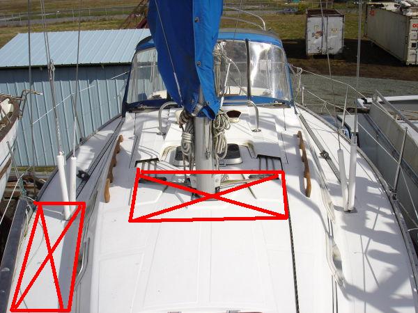

Does anyone have pictures of the cutted out area at the mast step or any other area where the deck has been cutted out for wet spots or delamination.
I am trying to determine the extend of repair to be done on my boat as mine show hunidity or aluminium plating inside the core!

The wood coring in the deck is as Steve says, plywood. In fact it is little 3" squares of plywood especially under the genoa tracks on the side decks where you have indicated. I saw this myself at the Hunter factory in 1986. Check that the screws holding that track down are properly sealed.
Directly under the mast is not plywood cored, but rather a 1/4" plate of aluminium then a synthetic foam material and then fiberglass. If you have any issues in the overhead it is probably because water or just the compressive force of the mast has distorted the wood inside the fiberglass beam. There are much easier methods to repair the overhead than what I described so many years ago.

Possibly the aluminum plates could indicate a false reading. I don't know exactly how the moisture meter works. If it is based on capacitance, maybe the presence of the metal plate may influence the reading. It seems that there will not be any moisture absorption under the mast area or where the line organizers are located as there is a substantial aluminum plate. Check farther forward toward the hatch where I know there is only a wood core for comparison and perhaps the anchor locker door. I believe there iare also embedded aluminum plates under all of the winches as well as the the turning blocks where the jib sheets come back towards the sheet winches. Also, there are aluminum plates under the line stoppers on either side of the companion way sliding hatch.
The area in front of your shrouds will have the wood core. Check to see if there are any cracks where water could have entered. Have the surveyor check the cockpit floor. That is were a number of these boats have seen water penetration.

The compression post and bulkhead are partly rotted a the top area but no deformation is noted on the cross beam. I have planned already to replace the post and hope that the cross beam is no too affected!
Moisture on Side deck is obvious and the deck is cracked near the chainplate and now that I know what is under, it will simplify the repairs planning.

You may want to consider cutting the area around the side deck with a skill saw. Remove the entire fiberglass piece. Repair/replace the existing rotten pieces, replace the fiberglass and then just reglass the piece into place.
I think if you can cut on the smooth area (rather than the non-skid) it will be easier to repair with little or no visual signs of the repair. You may need a pro to do the final glass work but you will have a quality job.
