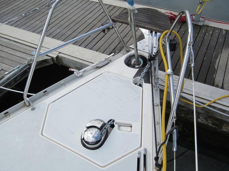

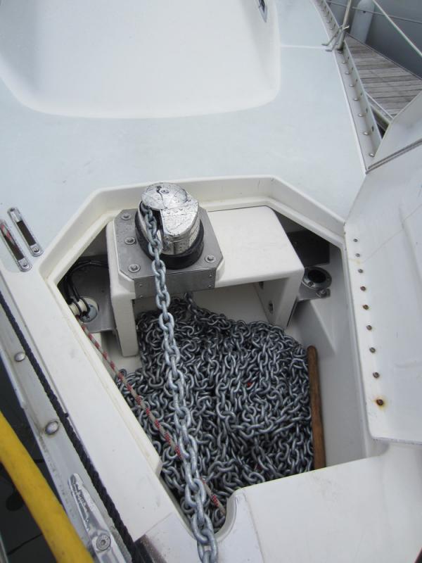

The windlass is a South Paciifc PRO VS1000 (vertical) This is mounted to a bespoke glassed platform that is through bolted within the rear of the anchor locker using 5mm 316 stainless steel brackets (see pics) This design keeps everthing within the locker so there is no potential for water penetrating the forecabin with any through deck installtion, not to mention a windlass protruding inside!
The locker lid has a suitable cut-out to allow the windlass to protrude through the lid when closed. A stainless steel guard plate has been fitted to protect the deck in the area where the chain runs and exits the bow roller.
The windlass is operated with the locker lid raised and controlled by a remote handheld switch that is wired within the forward berth and brought out via the forehatch when required. Because of the shallow design of the 30T anchor locker the chain does need to be swept forward (with wooden handle) as the chain is being recovered. Otherwise it will pyramid under the windlass and stall. In practise this is very easy to do and doesn't presend a problem. Once the anchor is recovered the lid can be simply closed over the chain. (for reference the locker can hold 50m of 8mm chain without a problem)
