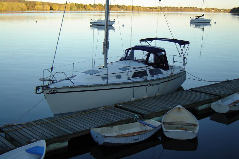

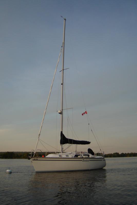

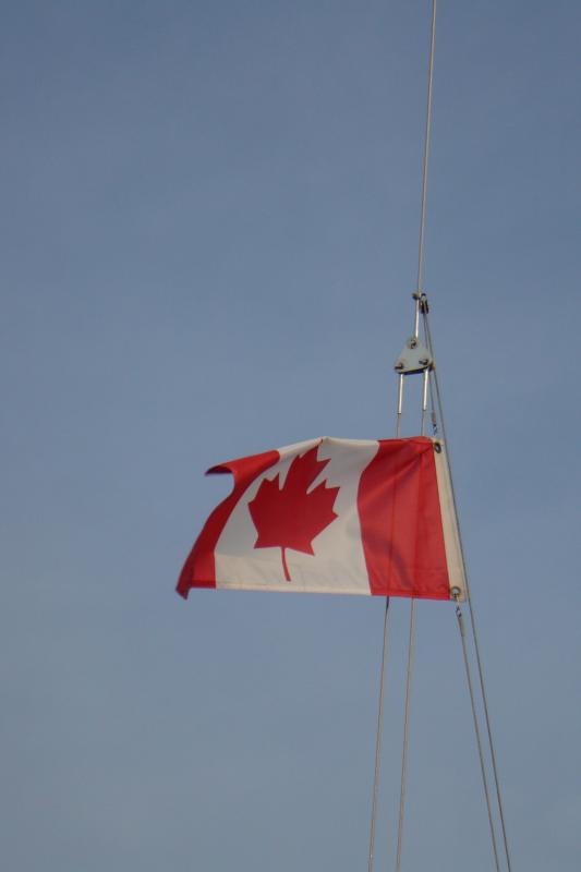

I have a backstay adjuster on my 1991 Hunter 30T. It is great for bending the top portion of the mast (remember this is a fractional rig) and giving a better sail shape. The mast on this boat is quite bendable. Sorry that the pictures are not that great but you should get the idea. The boat seems to be designed for such a device.

sailor-fred .. what do you have for an adjuster? A trolley car or a single sided pulley system? I notice you have a bimini, so does it interfere with it?
TommmD
Jul 22, 2014
49
Hunter Legend 355 Portsmouth, RI
Enlarged the picture & I can see it is a block from the port side: 8:1 or 16:1 with a block at the split.
