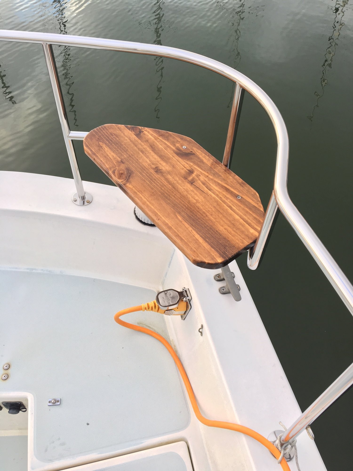

i got a stair tread from the box store $10. Found some stain in the garage. Cut to shape, sand stain,coat or two of clear epoxy. Then 5 coats of varnish screw them in place on the pulpit. Zing. Two of the best seats on the boat.
24,876
Here is a picture of the home made seat.
