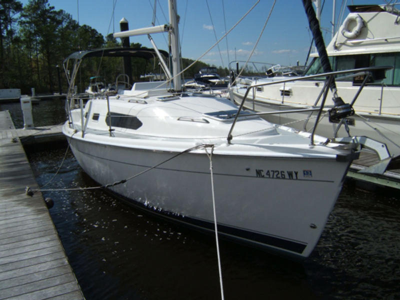

Heeling is likely the difference between, at the dock, and out for a sail, but moving water can also change the pressure on hoses, thru-hulls and cb trunks. Have you checked for moisture on the inside of the hull above the waterline on either side of the water in the bilge? Chain plates, engine exhaust, ...
What is that on the stem, just above the waterline? Is that an anchor locker drain?
