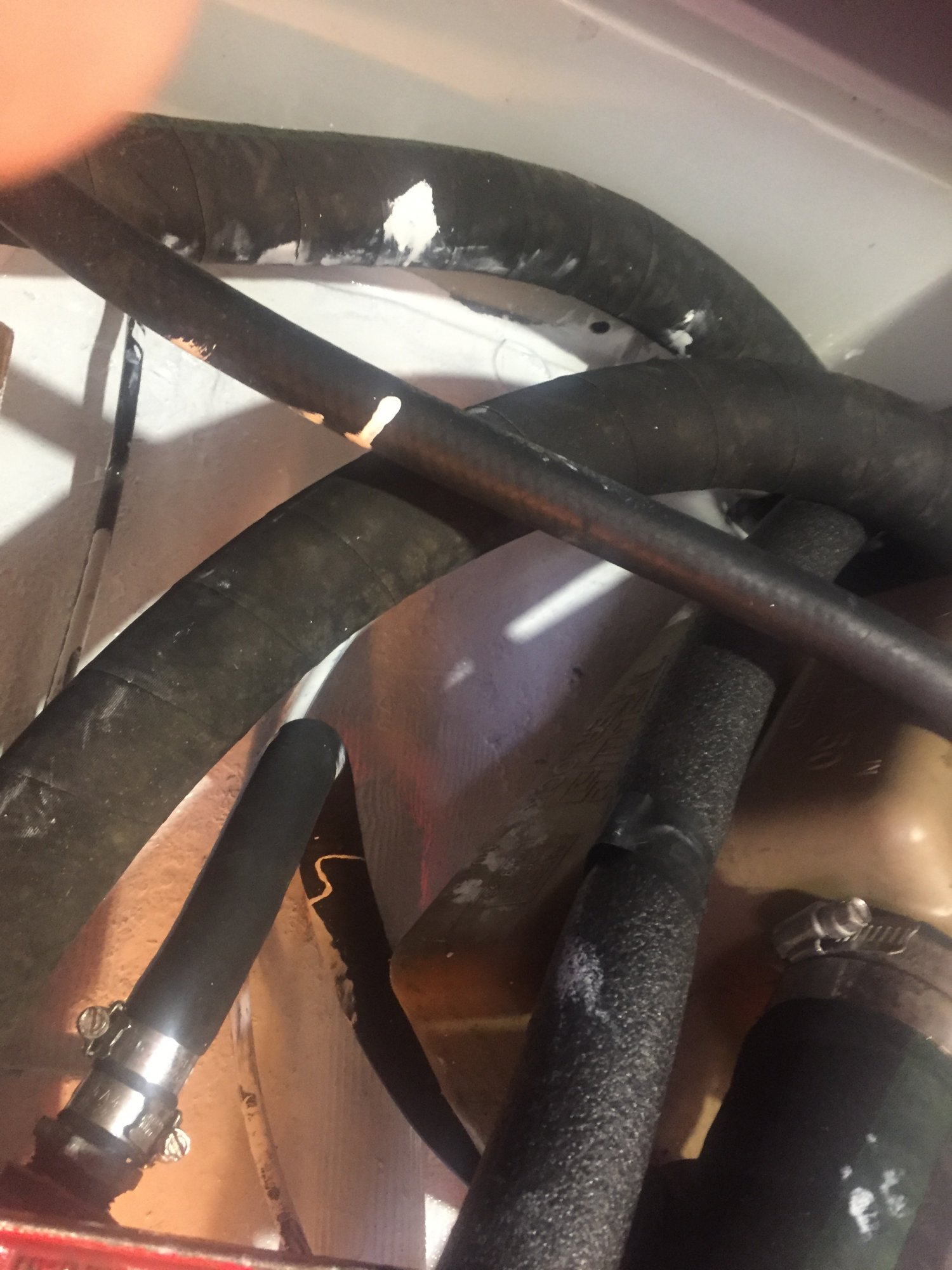

My compressor is located in my lazzarette, and coolant lines run across the boat to the fridge. Not ideal, but it works and I always have cold beer. I didn’t install it, and if I were to do it over again, I would try to run the coolant lines differently as they pass through my engine bilge and take up space around my stuffing box, exhaust muffler, etc.
