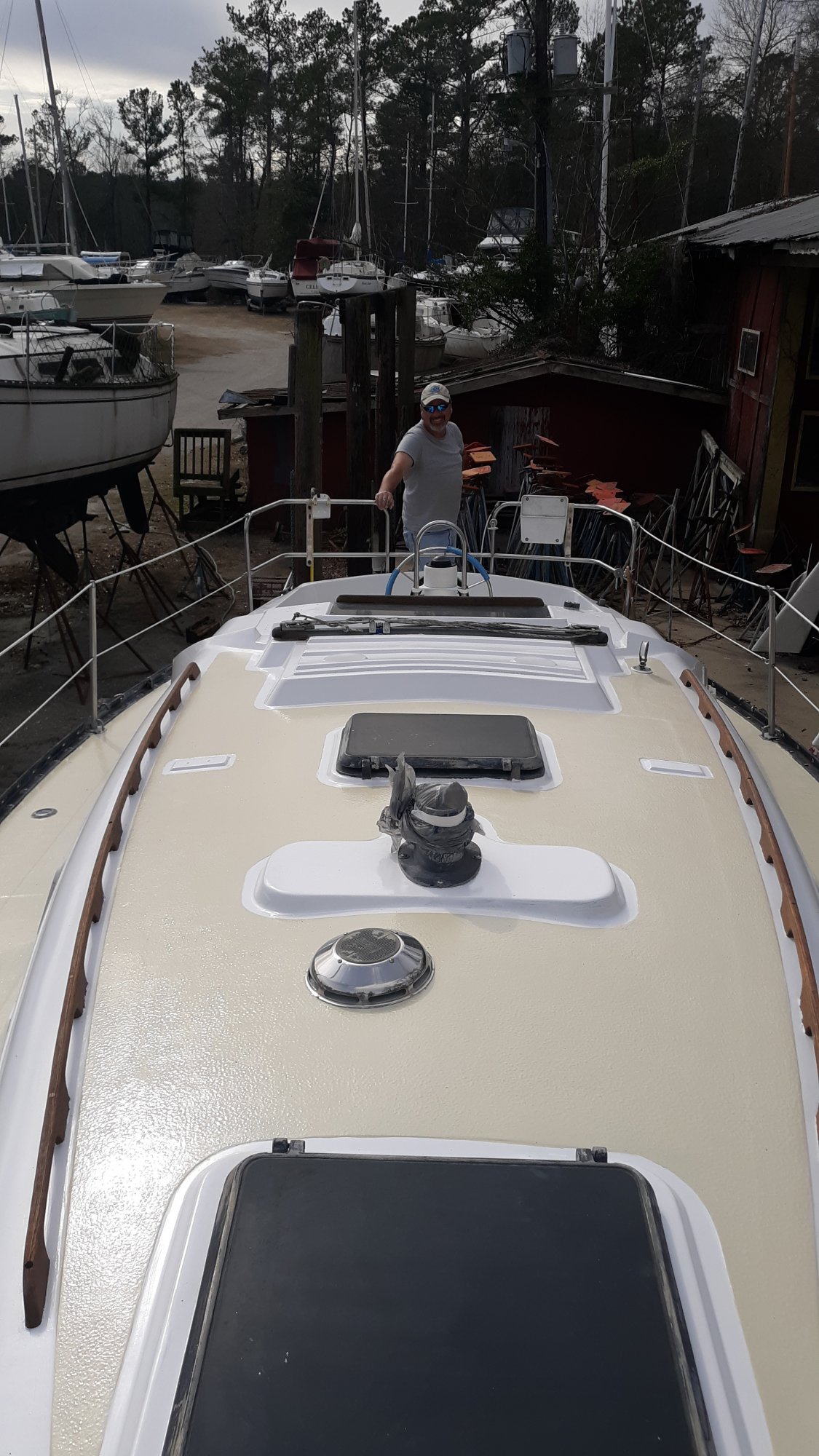

This is the third deck I have painted with this product, Rustoleum brand Topside paint available at Lowes. about $17 per quart. Took us 4 quarts, a handful of paint brushes and about 10 hours over two days with two people. I was surprised the first time I used this product and still impressed with it as a very economical way to get a decent finish on an old boat.

Nice. And I thought its pretty good paint too. you must have done all prep steps as it is cut in really nice nice straight lines

Beautiful job. Tell me how you applied your anti-skid? It looks pretty thick and well applied.

First we cleaned the deck really well, a couple times. All the nooks and crannies. Then we did some sanding. The edges of the toe rail, any rough spots. There were maybe a couple dozen nicks in the gel coat that I filled and sanded. Removed all of the snaps and screws for the dodger and enclosure. We will only use the bimini, the rest had a couple bad zippers, the clear parts weren't clear and I really did not like all the little twist locks mounted around the edge of the cock pit. They looked like bare foot / flip flop toe catchers to me anyway.... so they all came off and holes filled and sanded. The old SR Mariner depth and knot gauges came off and left 4" holes to be patched and fared. Then more cleaning. Then some fine sanding and a final cleaning / degreasing with Simple Green cleaner. We actually did not add anything to the non - skid. Then we taped up the toe rail, hatches, ports, companion way and a few pieces of hardware. We had already taken most of the cleats, winches, etc. off. Then we dry clothed the whole thing to get any grit or crevices missed. Then we painted, trying to be careful and wipe up any outdoor type dander that blew in. We had to quit halfway through the first day because of a swarm of gnats.
But very pleased with how it turned out. The last boat I did this with, I did not prep as well, and it still held up very nicely. I will keep a bit of paint on board for any touch up that comes along.
Highly recommend this if you don't want to spend a lot of dough on a pro spray job. Take your time, clean it well and prep it and paint it.

Very Nice job. The surface looks a bit glossy in some of the photos. How good is the anti-skid factor on these surfaces?
Not sure yet, we haven't tread on it much. Will be sure to update on that.

Looks great did you add the anti slip additive or just painted over old awl grip? Did you sand down to gelcoat. Is your color the oyster white or sand? My awlgrip looks like crap but not willing to pay more for a gallon of awlgrip than I did the boat. I dont mind sanding down if that's the proper prep I have many man hours I can put toward the boat but not alot of money. This paint seems like a good compromise. Thanks for sharing!

You can paint over your textured surfaces. They will maintain some of their texture / grip. Not like new, but no, don't sand it off. Clean, clean, clean the deck. Use a scraper to get in the nooks and crannies. All along the toe rail, get it cleaned out. Remove all the hardware, cleats, anything you don't want to tape and paint around. Its a good time to tear down your winches and inspect / replace pawls and springs, clean and new grease while you have them off. Then clean the deck some more, scraping any loose pant, etc away. Then use a good degreaser. Simple Green or Grease Lightning .... Then tape up everything. Ports, hatches, stantions. Then wipe it all down with a dry cloth, degreasing any spots you may have missed.
Paint it.
Ours is holding up well so far and looks nice.
