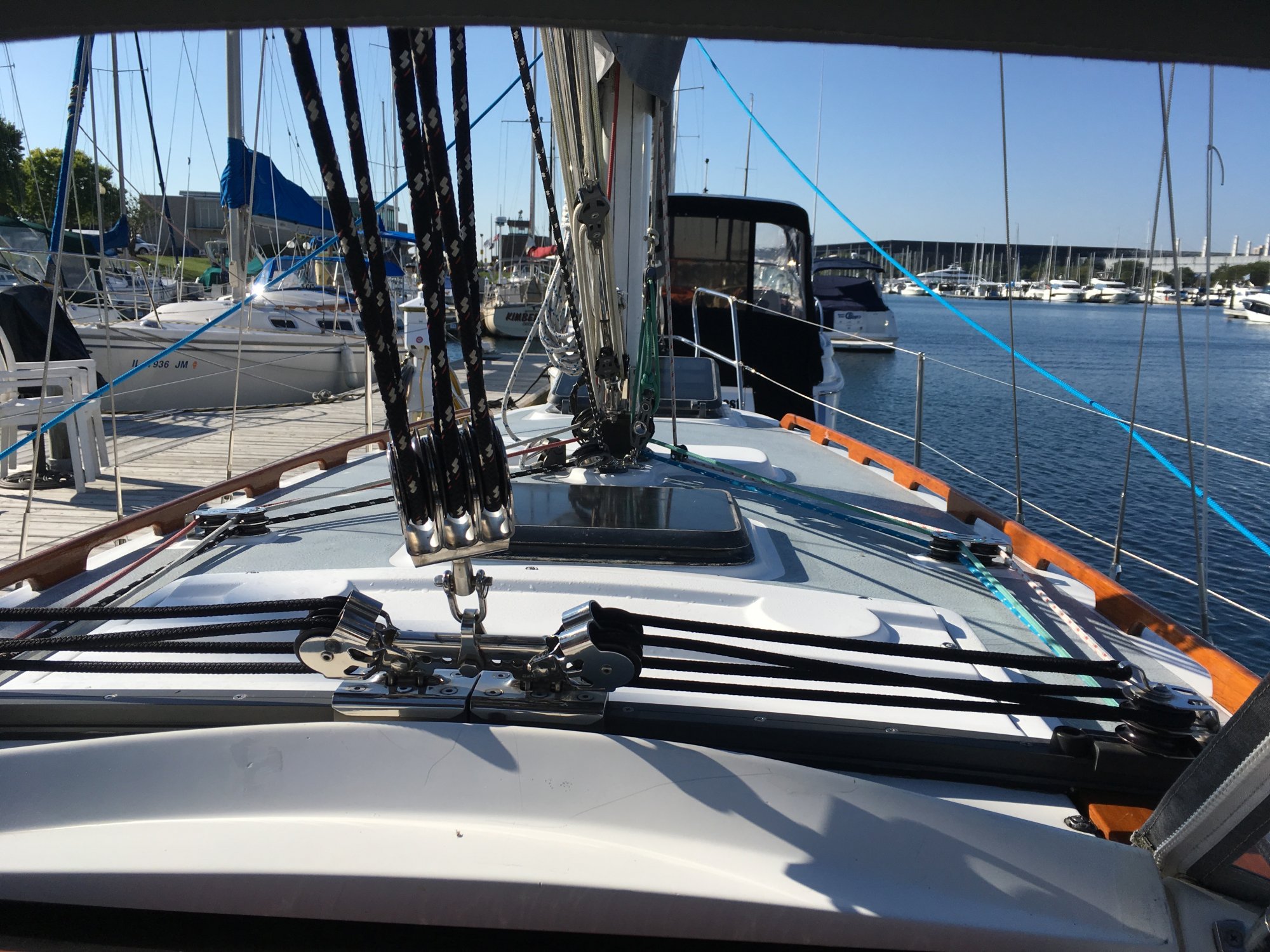

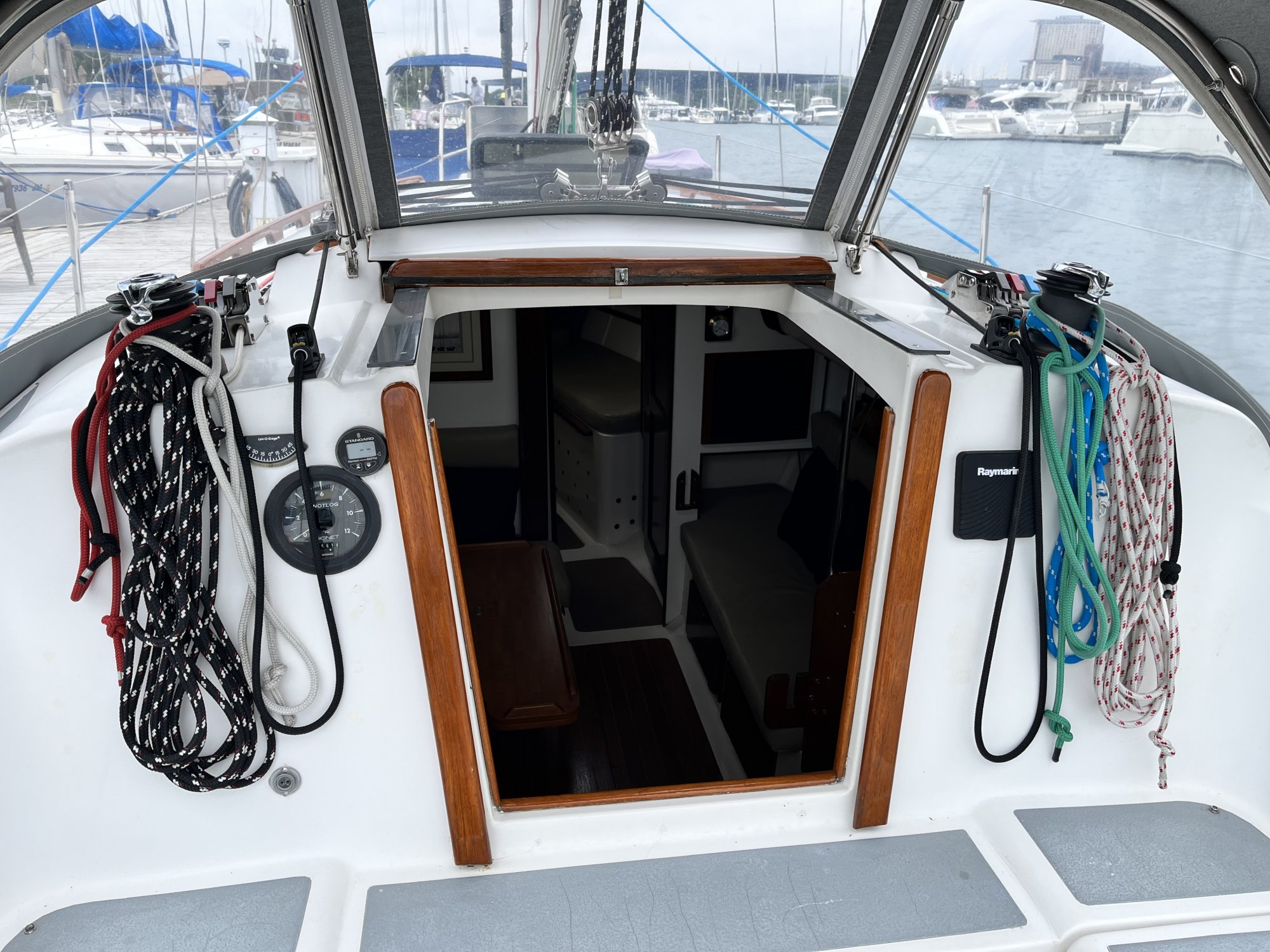

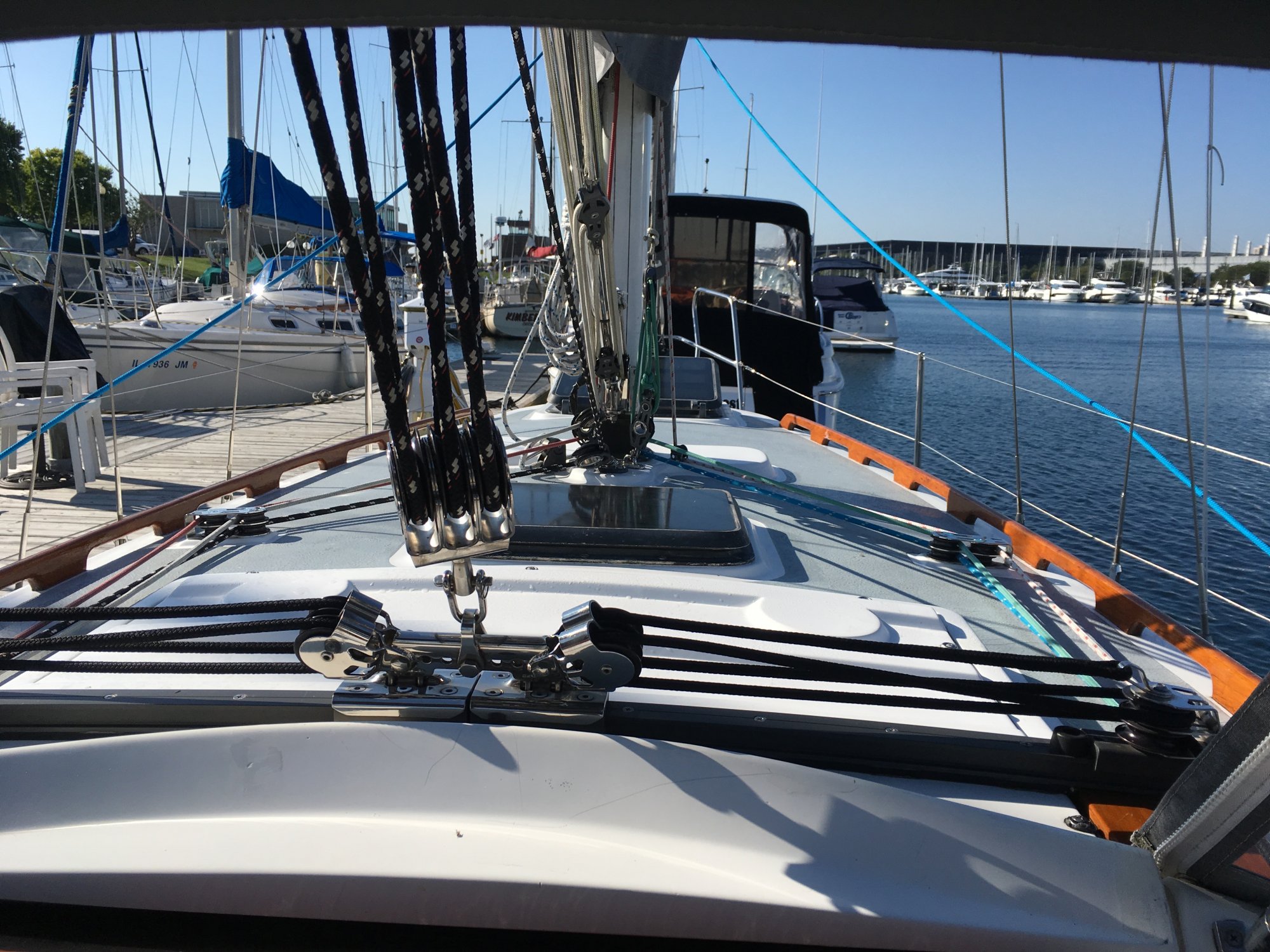

1,180
Hunter H30 1982 Chicago IL
I have the traveler on the cabin-top in front of the companionway on my ‘82 H30. It was long ago converted from the original “A“ configuration mainsheet to a cabin-top traveler by the previous owner and I upgraded it to a more substantial traveler with increased purchase and a triple block mainsheet. Both from Garhauer. The traveler lines come back to cabin-top Spinlock PXR Cam Cleats in the cockpit. This combination is very easy to release and adjust under load.
