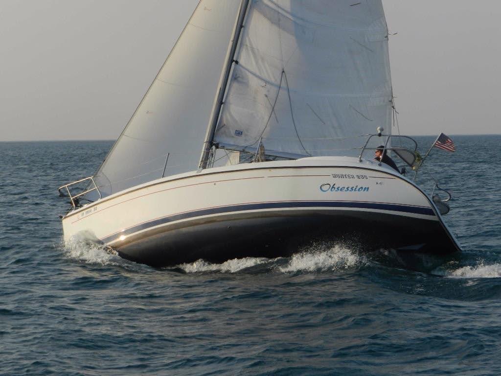

I had a Hunter 280, with the B&R rig (no back stay).
It was my first boat, so I was learning a lot, but she was capable and the lack of a backstay didnt really affect my sailing.
True, sailing DDW is not easy with the swept back spreaders, but all I had to do was sail just off DDW and it was fine.
The benefits of not having a back stay in the way is great and the B&R rig has proven itself…seems a bit odd not to have a backstay, but you don’t hear about B&R rigs crashing to the deck.
Lots of big Hunters have the B&R rig.
I had a lot of fun learning to sail on my H280!

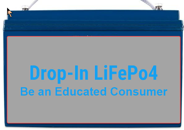

I've never cruised the Bahamas or the Keys, so I'm not really qualified to comment on suitability. But just for reference, I would note the 3'10" draft of the shoal keel, 40 gal. water, 20 gal. diesel, and 20 gal. holding tank. The chain locker has a pre-molded platform for a windlass, but I don't have one and just pull up my lightweight Danforth by hand. Also, the current stock power configuration includes two group 24 lead batteries with a stock alternator. No solar, no wind, and no generator. It's a bit anemic. If I were going to do anything beyond an overnight, I'd need to beef up those options. (Side note: I've been seeing recent options for 100 Ah LiFePO4 "mini" batteries that are looking real good.)
14,300
Your point about power is a good one. 2 Group 24 batteries will be inadequate for most and especially if there is refrigeration.
Do your research about LFP batteries. Many are advertised as "drop-in" they are "drop-in" for size only. LFPs have very specific charging and fusing requirements, if these are followed, they are great batteries. If not you'll be buying a new alternator in short order or worse.
