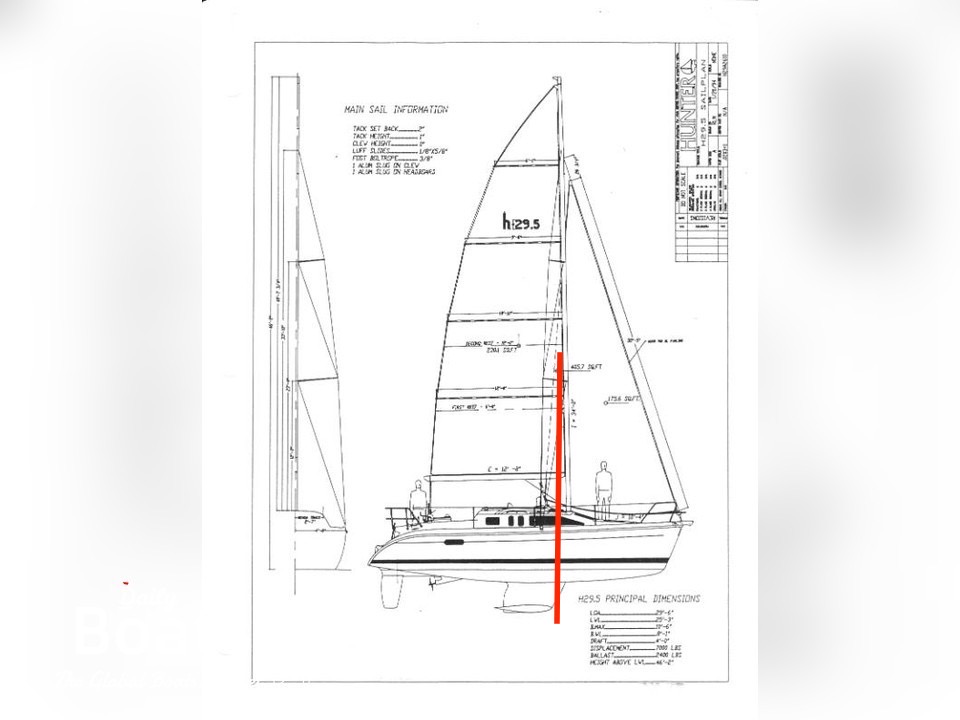

To be effective as a mid cleat used for docking and tying up to the dock with a spring line, you want to position the cleat about the center of the point of boat rotation.
This would be at the beginning of the keel. Here is a side view of your 29.5 Hunter. The Red line that I drew indicates where I would locate a mid cleat. I use the same technique on my boat, and the mid cleat works perfectly for docking safely single-handed.

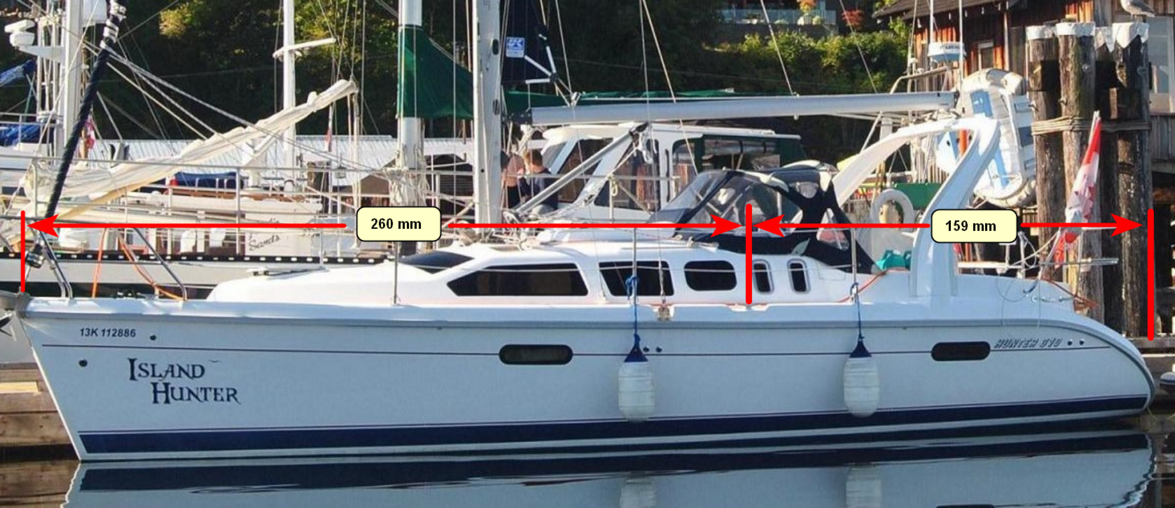

Close, but no cigar on that one. On this profile of my Hunter 310, the dimensions on my screen come out as shown :
Or on a 31' boat, the mid cleat was installed by Hunter at (260/419) X 31' = 19' from he bow. This is also, thoereticaly speaking, the horizontal measurement to the centre of gravity (CG) of the boat. The vertical position of the CG does not come into play. I also find this position works perfectly for hauling the boat abeam.
If you heave on a boat abeam in calm water and want it to come directly to you without rotating, you want to pull through the CG. You are moving sideways so slowly that the influence of the keel is minor. Strong winds, different story. Strong current, different story. Design to the average conditions.

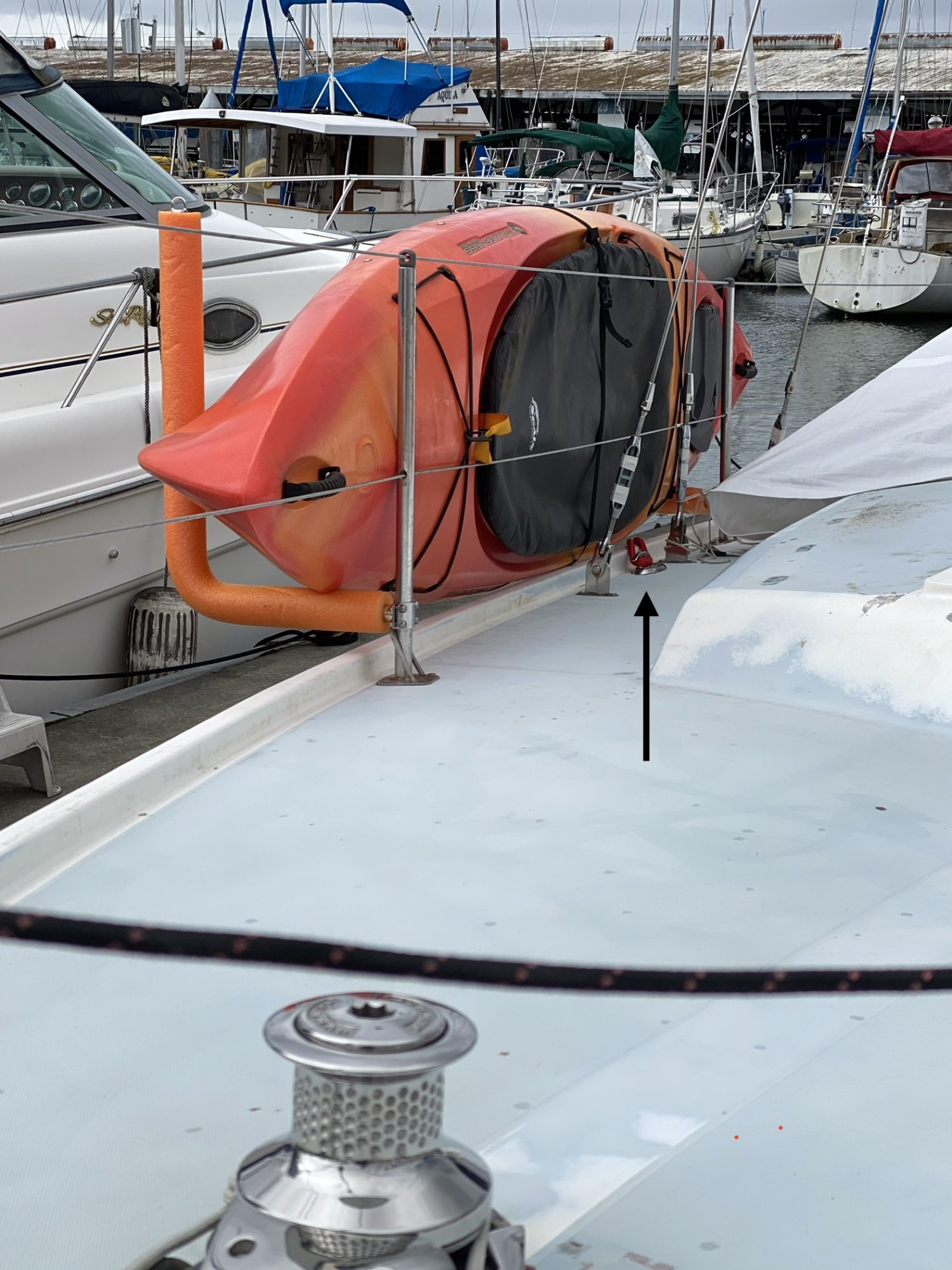

When I first worked with using the spring line to aid in docking, I used a soft shackle to hold my dock line with a spliced loop to the main shroud. This aided me in locating the point on the boat to control the boat. I was not looking for the CG of the boat, I wanted the pivot point of the hull and keel. For my boat this is where the forward root of the keel connects to the hull. You can try using points along the rail, but I think you’ll want to locate the cleat on the deck.
The folding cleat is located when the black arrow is pointing.
