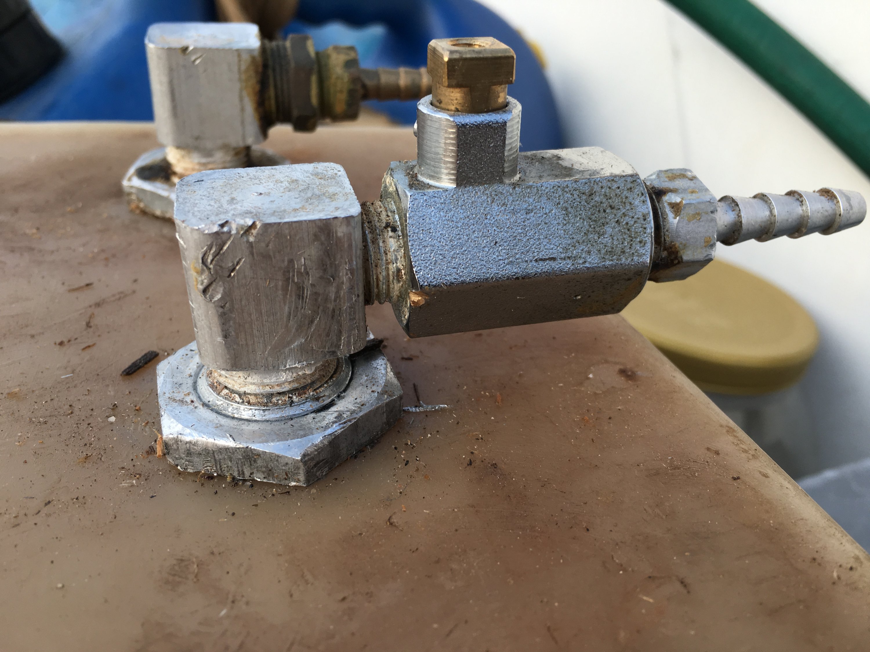

Ralph, I uploaded a pic of the tank fitting. The barb will come off easy enough. The collared nut seems to be nothing more than a lock to secure it to the plastic. While using a wrench the fitting just spins (quite tightly) in both directions. I'm wondering if there is some kind of compressed pressure requiring force to pull it out and then press it back in.
10,200
The little elbow part, the one that the valve screws into, It will unscrew from the compression tube being held in by the big silver nut.. Tighten that a bit, then hold it and unscrew the elbow out of the fitting.

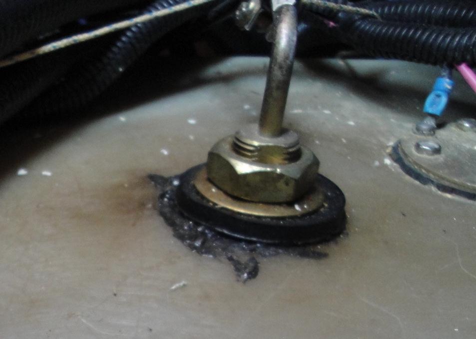

Go with Kloudie1's method first. If that doesn't work take a look below next :
This is the fuel pickup for the Espar heater. I recently re-sealed this because it was leaking from an overfilled fuel tank. Shouldn't have overfilled the tank but likewise, the fitting shouldn't have leaked.
In order to remove the upper portion of the assembly, the centre portion is held stationary and the nut is unscrewed. Pull off the metal washer and then the rubber gasket. The inside washer is a two piece assembly which does no sealing. Yours may (or then again) may not be like this one. What is important is the external rubber gasket which this time around, I sealed with Permatex #2, the only sealant which sticks to polyethylene (and everything else within a 100 yard radius). It's important not to grind the nut against the polyethylene as you're tightening but have at least a washer in between with a rubber gasket being better still.

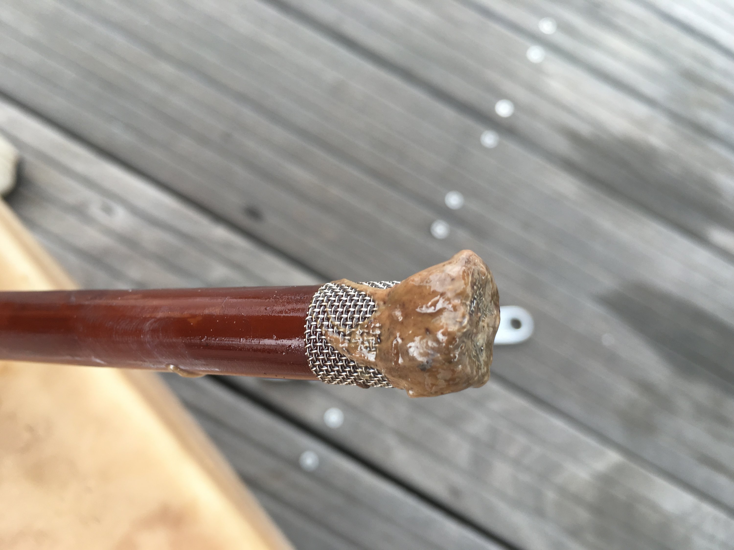

Ralph and Kloudie. I got it out. Had to build a slip-on wider washer between lock nut and plastic to keep the unit from spinning. Once it broke it came out easy enough. Uploading picture of the bottom of the uptake tube. Gummed up almost organic looking stuff. Was all over the bottom of the tank. Removed screen, cleaned the bottom, re/installed tank and I have flow. Phew. Thanks for your ideas and help. This is an INCA tank. Called their engineer four times describing my issues and never got a call back. Thank god for the kindness of strangers.

Rinsed with fuel four or five times and dumped from the input port. Gunk came out with the wash.
