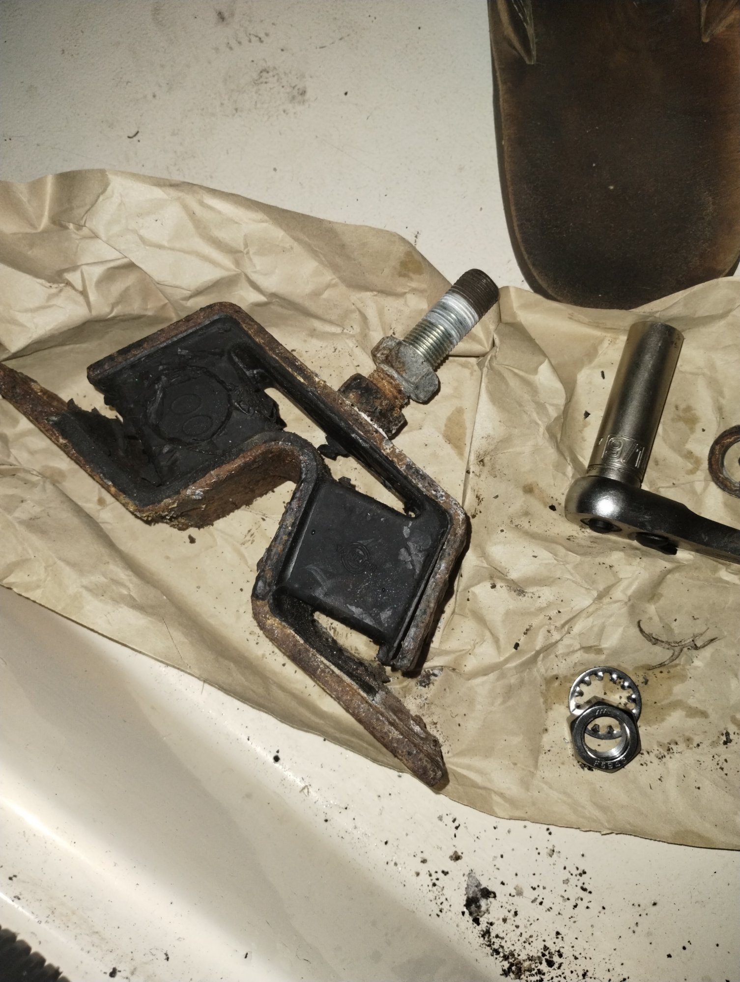

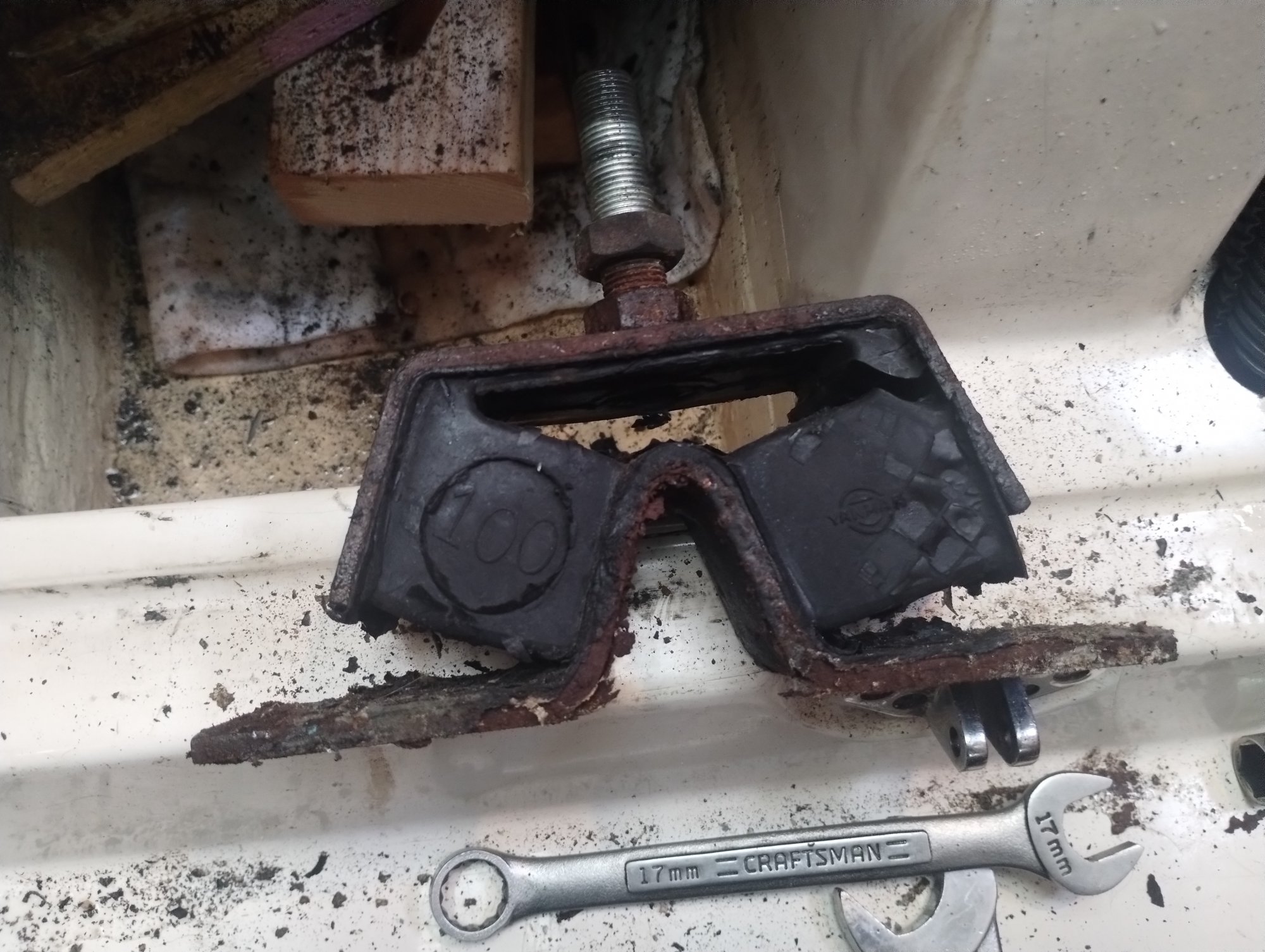

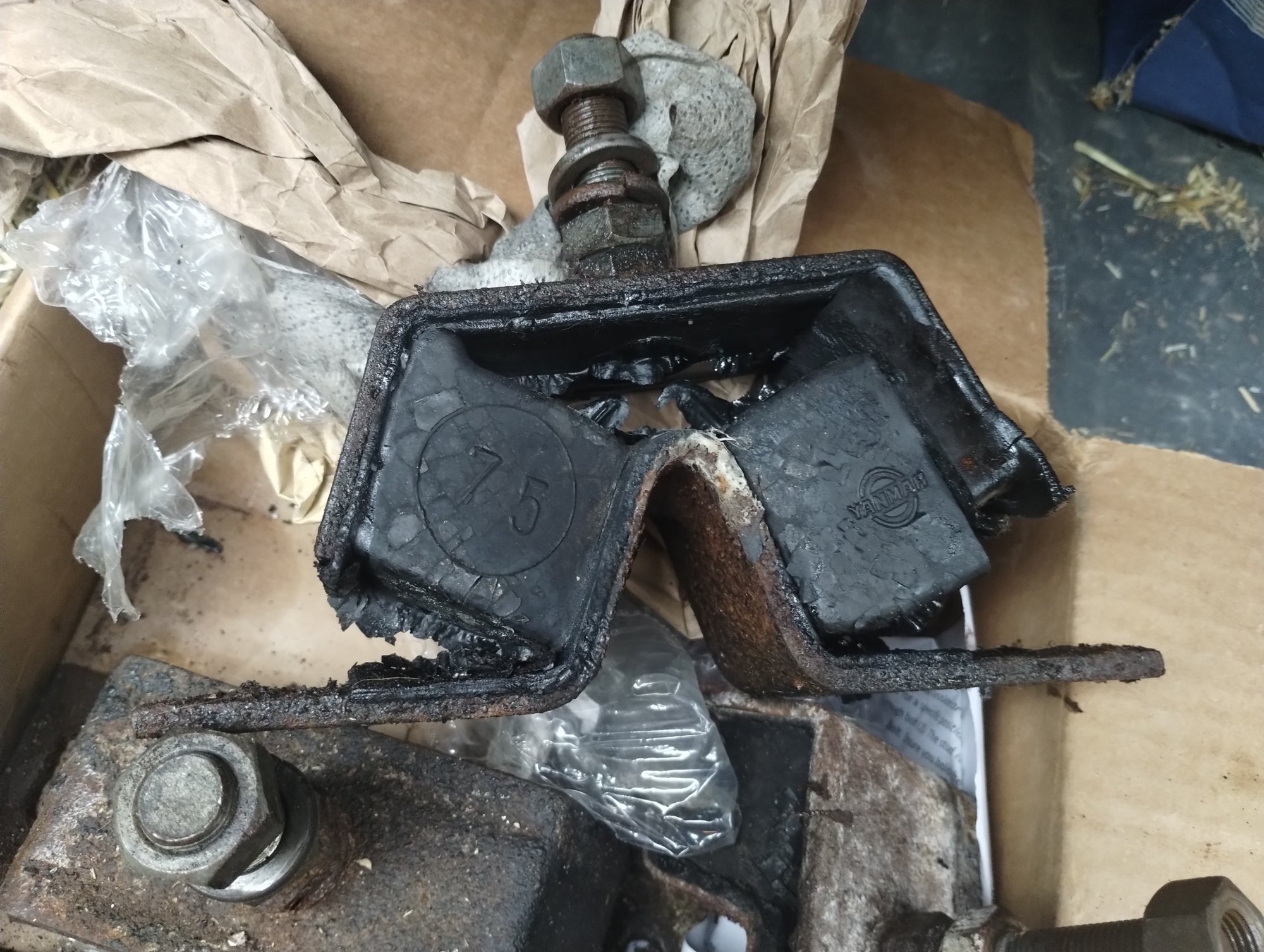

this was definitely my issue, all of them had rubber/metal separation and both starboard mounts had failed completely. I'm not sure how this guy was getting around, but the leaking gland and worn cutlass probably all caused by these failing.

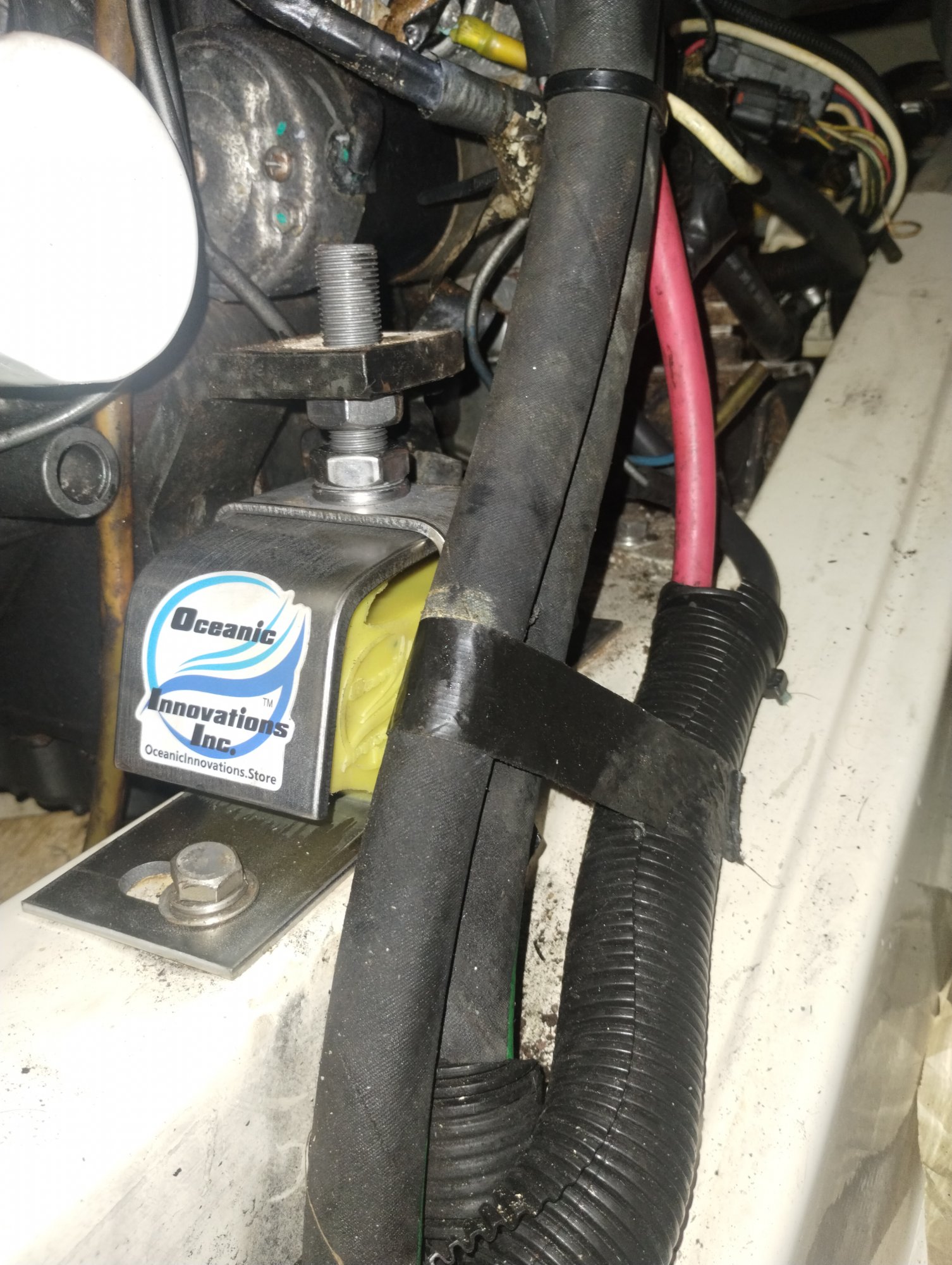

Changed out the mounts yesterday. Really not a bad job, couple hours including re alignment. I didn't need to disconnect the shaft.
I ended up using these mounts in all 4 corners - This mount design is already quite compliant; it's hard to imagine putting 2 slightly softer ones in would make a huge difference. I'll let you all know when the boat shakes apart .
No time to get out on the water yesterday , but motor operation in gear against the dock lines was vastly improved. Getting there!

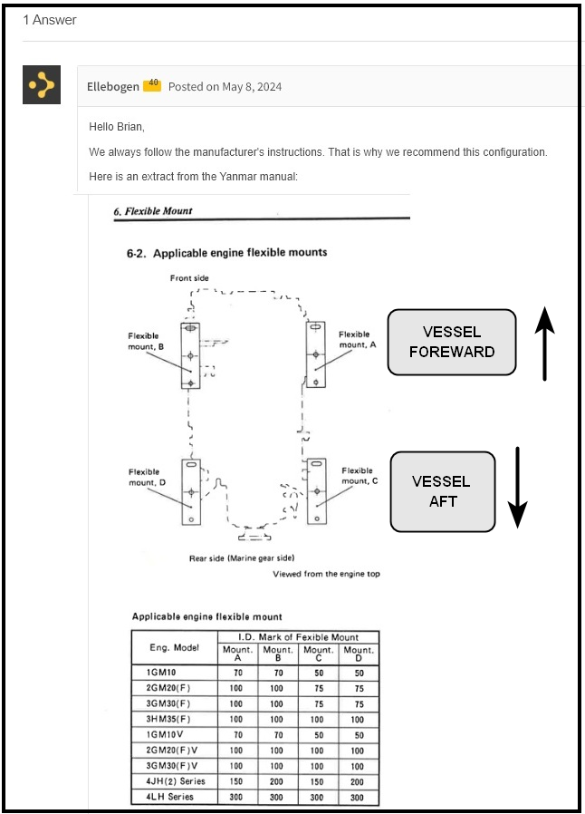

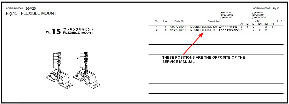

Based on specifications from both Ellebogen and Yanmar I offer the following :
Ellebogen
Yanmar Parts Catalogue
Purchase of Aft Starboard Mount in 2009
Check the parts numbers. My purchase in 2009 and the Yanmar parts catalogue show the same parts number. The Ellebogen parts numbers disagree. I am still looking for a paragraph in a Yanmar catalogue in which the Ellebogen and the Yanmar parts catalogue agree.

I came across the same discrepancy. The front mounts seem to be quite a bit more loaded than the rear, I would not put the soft ones forward despite yanmar and hunter documents that might suggest it.
I suspect the benefit of softer mount in rear makes the drivetrain more tolerant of misalignment, allowing the transmission to move around, or maybe some nuanced reduction in prop vibration to the hull.
I personally went with the 2gm20f(v) setup, 4x100, and can't imagine any significant downside, even though this isn't a vee drive. I certainly don't want it wiggling around even more than it can right now...

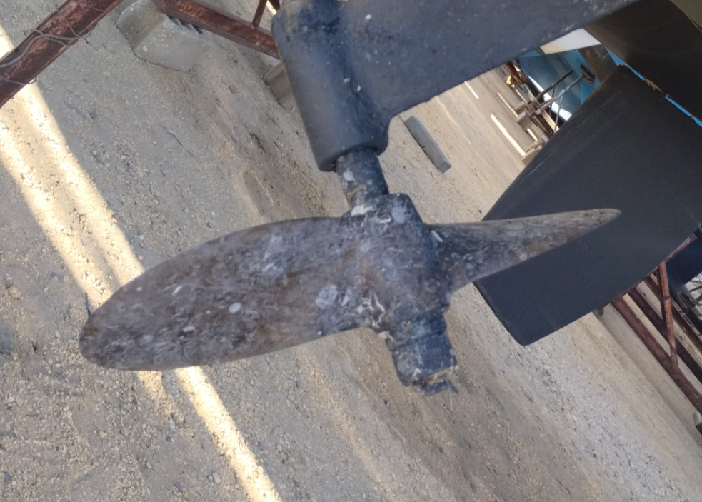

I also realize I stuck a zinc on the prop shaft well away from the cutlass, which is apparently not good, especially if there's any bow in the shaft. Also completely unsure if the prob is well balanced; I didn't do anything at all to it, even clean it, before launch. To make the situation worse, this photo isn't even the final setup; I'm fairly certain with everything in place there's another inch of shaft (making it closer to 3" total) sticking behind the cutless before the prop; far too much overhang for a 2 blade prop on a 1 inch shaft..

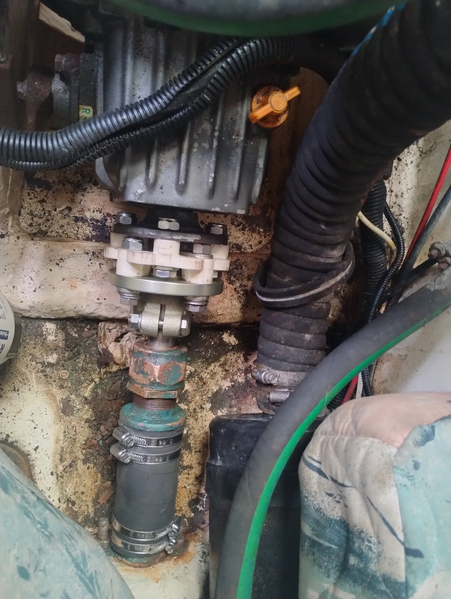

And just to make clear.. The reason I added a spacer in the coupling was to deal with two other issues, primarily that the cutless was beat, stuffing box was over tightened and wore a groove in the shaft. For a pre-launch job on a boat I bought end of season and didn't know much about (except that it leaked at the box), it's a huge improvement.
It's looking like a new shaft and maybe a feathering or folding prop may be in my future, though.

RD marine 4" flex coupler off ebay.
Easiest off the shelf solution, i probably could have shortened up the shaft log an inch instead but I already had the coupler and stuffing box installed before I realized my mistake.

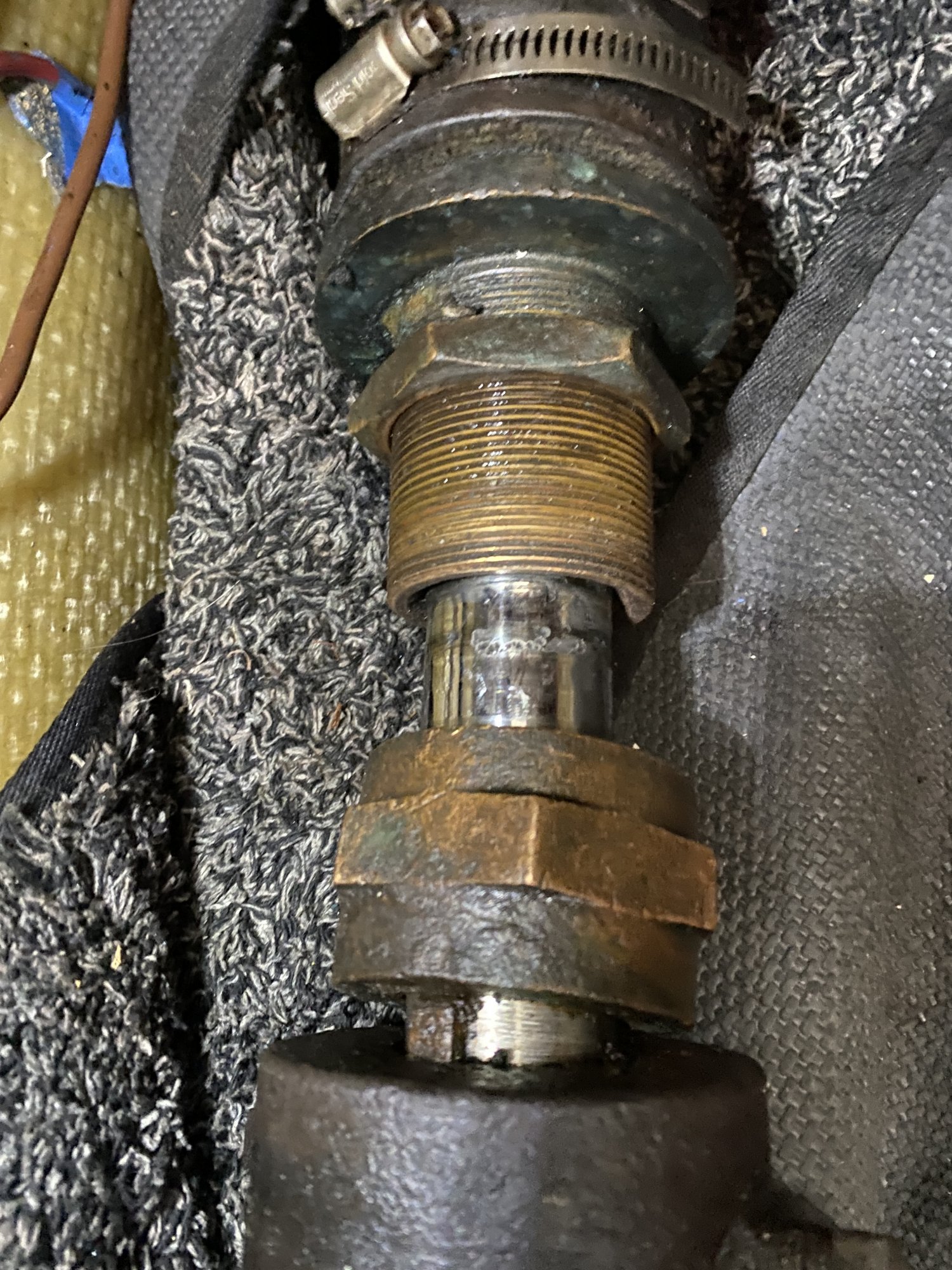

Can you ad more detail to the spacer ? Maybe a pic.
Not necessarily. The zinc needs to be spaced so that water can get into the cutlass bearing to provide lubricant as the shaft turns.
Jan 4, 2006
7,308
Holy great snapping horny toads. If that collection of loose hardware doesn't contribute to your vibration problems, I'd be greatly surprised.
Yes, I know the manufacturer swore up and down that it would take away your misalignment problems forever but what if your original misalignment problem was way outside the capability of this amazing little Rube Goldberg contraption. In fact, how could you possibly even do an alignment check without the prop shaft flange in place ?
I'm sorry to add to add further pain and angst to your collection of problems at this point. It looks like you've been through the wringer (both forward and back) with what you've done so far but maybe it's time to throw in the towel and hand this job over to a "qualified" pro and have the enire prop shaft renewed and at least have your prop polished and balanced by a prop shop to allow yourself to take a breather. Be sure that your shaft is done by professional shop and not some wharf rat. Believe or not, they can make your problems even worse, far worse.
Use the boat as much as you can fore the remainder of the season and see what you really want in a prop. Check the archives here under props.

The starting point here was completely thrashed everything. Motor mounts entirely disconnected so that the engine was leaping in the air, stuffing box leaking like a seive, huge amount of play in the cutlass. It's my first inboard boat. I asked the yard to do the cutlass back in November, by the time April rolled around they didn't even start.
I pulled the hub and shaft, cutlass done, new shaft log, put it back together, realized the stuffing box wasn't going to seal on the grooved shaft, tossed in that flex coupler and launched it, all in a week. I completely understand it's not ideal, but the alternative was getting into a whole new project. Haven't touched the setup since, just planning the next step.
I've got a perfectly serviceable boat with only the tiniest amount of leakage under power, very little time and money into fixing the issue, and now only some noticeable vibration that comes in at the top end of the power range (dramatically reduced since changing the mounts, which was the major problem)
The alignment is done by measurement of the change in gap between the two hub flanges with feeler gauges, at one fixed point, as you rotate through 360 degrees with everything bolted up. Definitely no idea what you mean about doing an alignment without the hub in place. It was pretty good at time of replacing mounts, though now with 2 months on the mounts it could surely use a tweak.

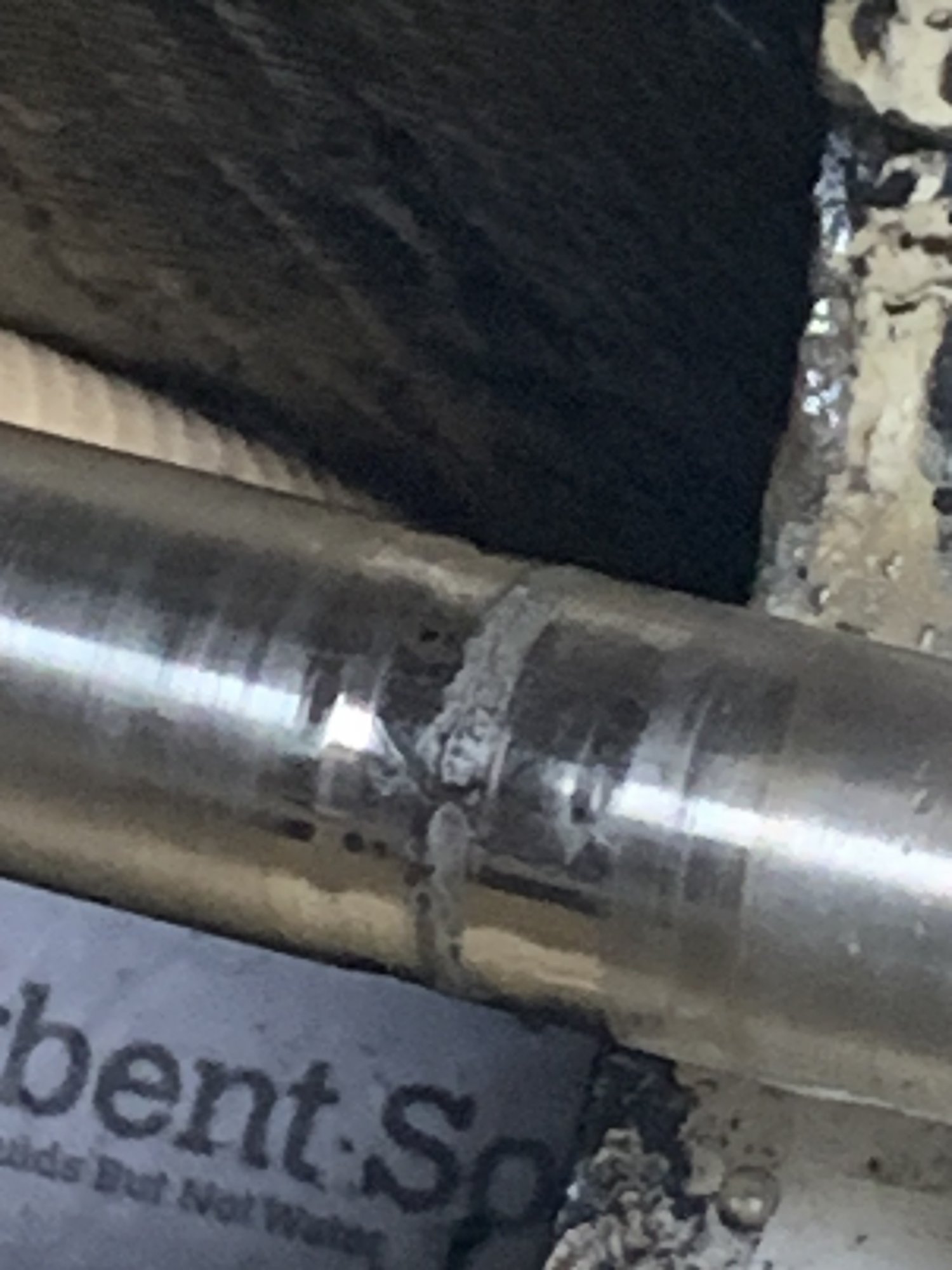

When I peeled back the stuffing box on my shiny shaft, I found the damage had been done over the past 9 years plus.
My first thought, well that is not too bad...
Then I opened up, and the rest of the story became evident.
Pitting corrosion on a 1 3/8 shaft.
My shaft was not leaking, but it was compromised.
It was time for this boat to get a new shaft, a trued shaft, and a new coupler that was "Faced and Fitted" to the shaft. The shaft was milled and prop fitted.
Took all the guesswork out of the equation. Once the engine/transmission was mated to the new shaft and coupler, the alignment went smoothly
