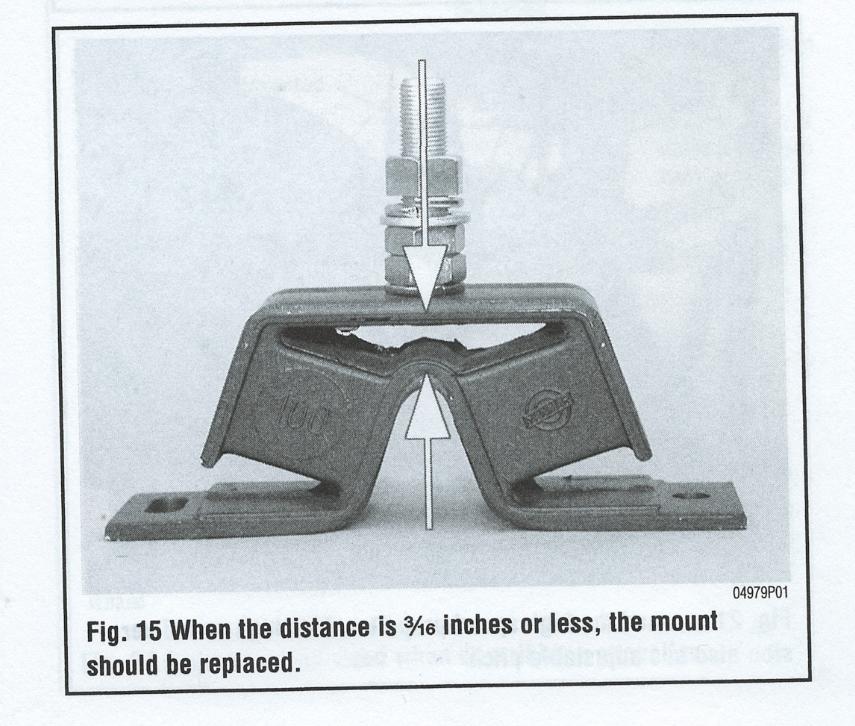

I replaced engine mounts a few months ago on my 3YM30 Yanmar. Excessive vibration in neutral idle, but not as bad as seen in your video. Huge improvement with very little vibration remaining. Be aware that Yanmar mounts will cost over one boat buck. I replaced with Ellebogen mounts from Spain at half the cost of Yanmar. Excellent product & customer service. Regardless of manufacturer, you will need to determine the rating of the rubber mounts for your engine. Mine had a rating of 100 for forward mounts & 75 for aft mounts. You should be able to determine that info in owner‘s manual or the numbers should be embossed on the outboard rubber surface of the mounts. See @Ralph Johnstone photo for rating number location.

Mine are original 1998 mounts that feel as smooth as glass under power. They are all getting down to just under 3/16" and I'm getting ready to change them next winter.
Primarily because they're looking at 27 years old but also I have no other projects lined up for next winter. Gotta keep occupied somehow.

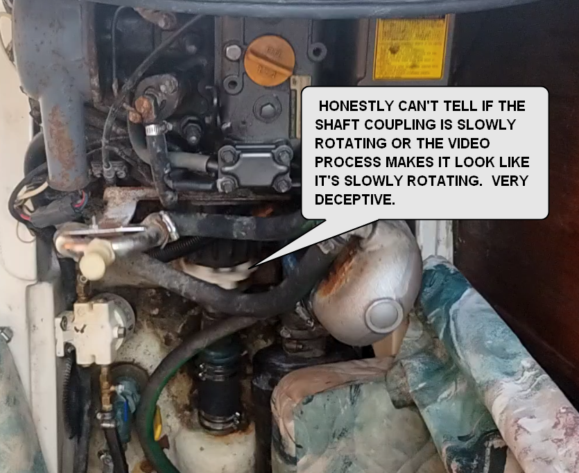

I'm not clear on this one myself. @Brian M H23 has not replied on this item and in the VID. it looks like the shaft coupling is very slowly rolling over :
vid. it
Either way, @Brian M H23 , we can't go any further until we get a video with the engine IN NEUTRAL and slowly rev the engine up and down. It's almost certain to have been the cause of the damage to the strut.
Thanks. This is the most interesting case in quite a while.
View attachment 231498vid. it
Ralph, engine was in gear in that shot, about 1200 rpm if i recall. I do have a video of idle but the vibration is less pronounced
I don't have much information prior to my work because all I ever did was motor it to haulout and a very short sea trial. I did very causally notice the mounts are rusty, ugly and very soft without knowing these are a common wear item. Next trip to the boat will be armed with new ones

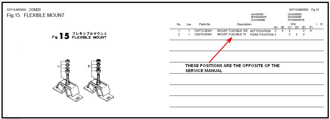

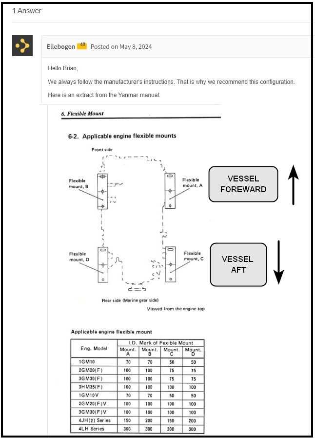

Based on specifications from both Ellebogen and Yanmar I offer the following :
Ellebogen
Yanmar Parts Catalogue
Purchase of Aft Starboard Mount in 2009
Check the parts numbers. My purchase in 2009 and the Yanmar parts catalogue show the same parts number. The Ellebogen parts numbers disagree. I am still looking for a paragraph in a Yanmar catalogue in which the Ellebogen and the Yanmar parts catalogue agree.
@BigEasy , I'm relying on you for the correct location of these mounts as I'm getting ready to replace the mounts on my 2GM20F with Ellebogen mounts next winter.
