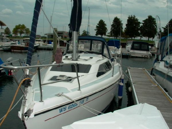

I just purchased my first sailboat! After a 2-year process, including obsessing over being on the water, investigating everything from a MacGregor 26M to an Oday 322 and finally purchasing my 1996 Hunter 280. During the process, I also took a sailboat bareboat charter certification class and chartered a 34' Catalina.
Been quite a long process, but can't wait for the ice to melt in Milwaukee (where my boat is currenty) so I can sail her down to East Chicago, IN where I will keep her.
