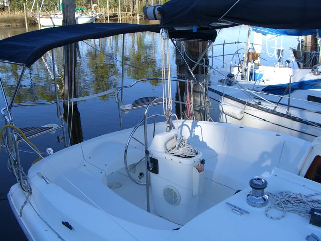

There were two speakers installed in the fiberglass pedestal when we bought the boat; one facing port, the other facing starboard. It would have not been my first choice location but they were already there. The ones that were outside had deteriorated pretty badly so I removed those and tossed them; moved the ones in the cabin to the pedestal and bought two new small box speakers for the vberth. If I can find some pictures, I'll post them.

I'm pretty sure the cutouts are just below that storage area in the pedestal. Our pedestal is protected by a wheel/pedestal cover AND a bimini so no water ever gets into that space. As to how the wires are run; I believe they follow the throttle/shift cable into the fuel and holding tank space then around the sides to the overhead console (where my unit is located). Another drawback to where my outside speakers are located is that they are kinda close to the cockpit floor and get tapped occasionally by our feet as we go fwd and aft in the cockpit.
This is a sister ship but the placement of the speakers are pretty close to where mine are.

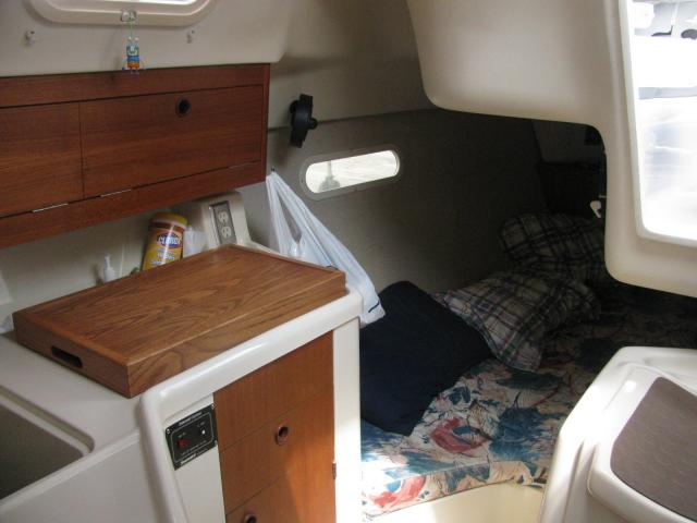

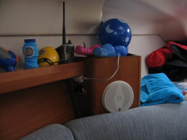

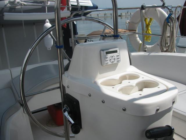

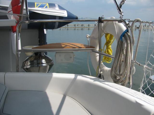

Here are some ideas I did on my 1996 280...
With the cubby's that hold your interior speakers do you still have the board that folds down to extend the V-berth? Also is there a back to that cubby that runs along the hull of the boat? I think I am going to build some but with the fold out V berth out it doesn't seem like there is as much room as yours but a picture can be deceiving. I have seen pictures of head units in them as well. If it's not too much to ask and you have time I would of love to get some dimensions from you. There aren't any I can look at in person.
