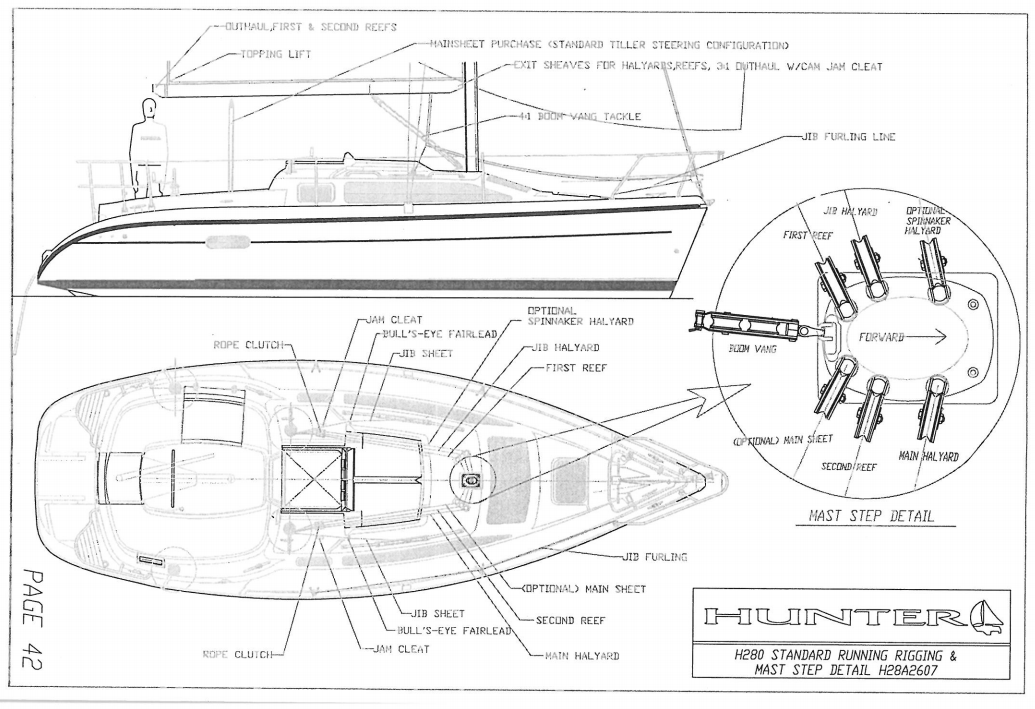

Hello everyone - this is my first post, but I've spent hours consuming a lot of helpful info on these forums. About two months ago I moved up from a 1986 Catalina 25 to a 1996 Hunter 280 and I've been working through a long to-do list while trying to sail her as much as time will allow. My C25 had hank-on headsails so I'm loving the roller furling while my wife is loving the wheel steering (C25 was tiller).
As for my question, the owners manual has a diagram of the standard rigging:
However, the previous owner had modified this a bit. Both my first and second reefing lines are simply coiled and hanging where they exit the boom next to the mast. Where the diagram shows the first and second reef lines, instead I have the outhaul and topping lift leading aft. I do have the optional traveler and spinnaker so I am using those two spots for the main sheet and spin halyard.
Before I change it back to the standard configuration, I'm interested to hear what you think about this setup and what others may have done. When reefing, I still have to leave the cockpit go to the mast to hook the cringle so having the reef lines up there isn't creating an unnecessary trip.....
What are your thoughts? Is it more important to have the reefing lines led aft than the outhaul and topping lift? If so, how/where do you tie/stow those when you aren't adjusting them?

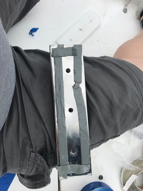

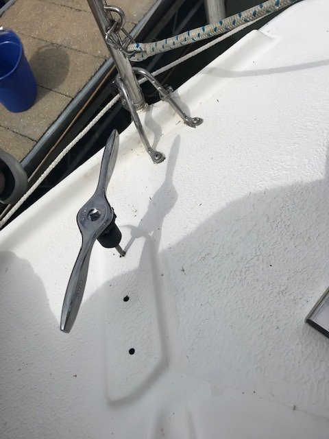

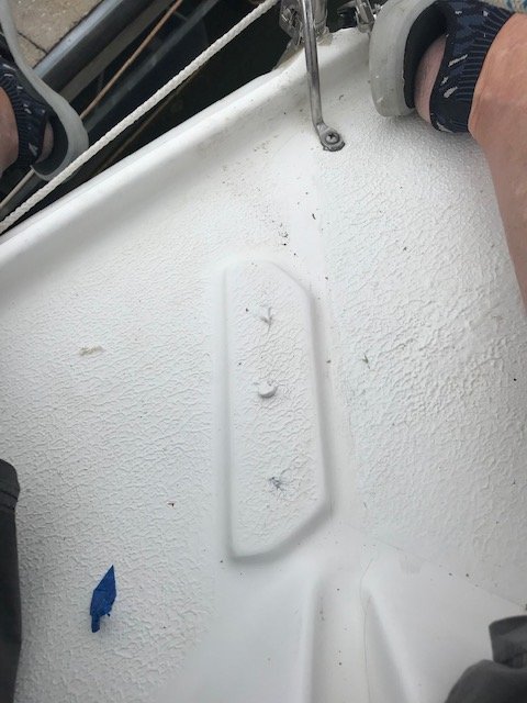

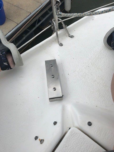

I had a similar desire for my H26 so I added a second set of 3 rope clutches and a second organizer on the port side. I couldn't find pictures of the clutches but here are a few of the orgnizer instal. On the H26 there is a glassed in aluminum plate for this purpose and you just need to tap some threads.... easy peasy. I can now run six lines back to my cockpit through the organizers plus the genoa sheets through standing blocks.
Starboard I have the main halyard, outhaul & keel lift line.
Port I have the topping lift, and the tack and clew reef lines.
It is a really nice set up. I really like being able to adust the outhaul without leaving the cockpit... and likewise on the reefing lines. @Dave Groshong helped me get the right size rope clutches and he was very paitient with me as I worked through the measurements.
Wow that's awesome. I'll have to check but I don't think I have those on the 280. I hope I do, but then I'll feel like the least observant person I know....
