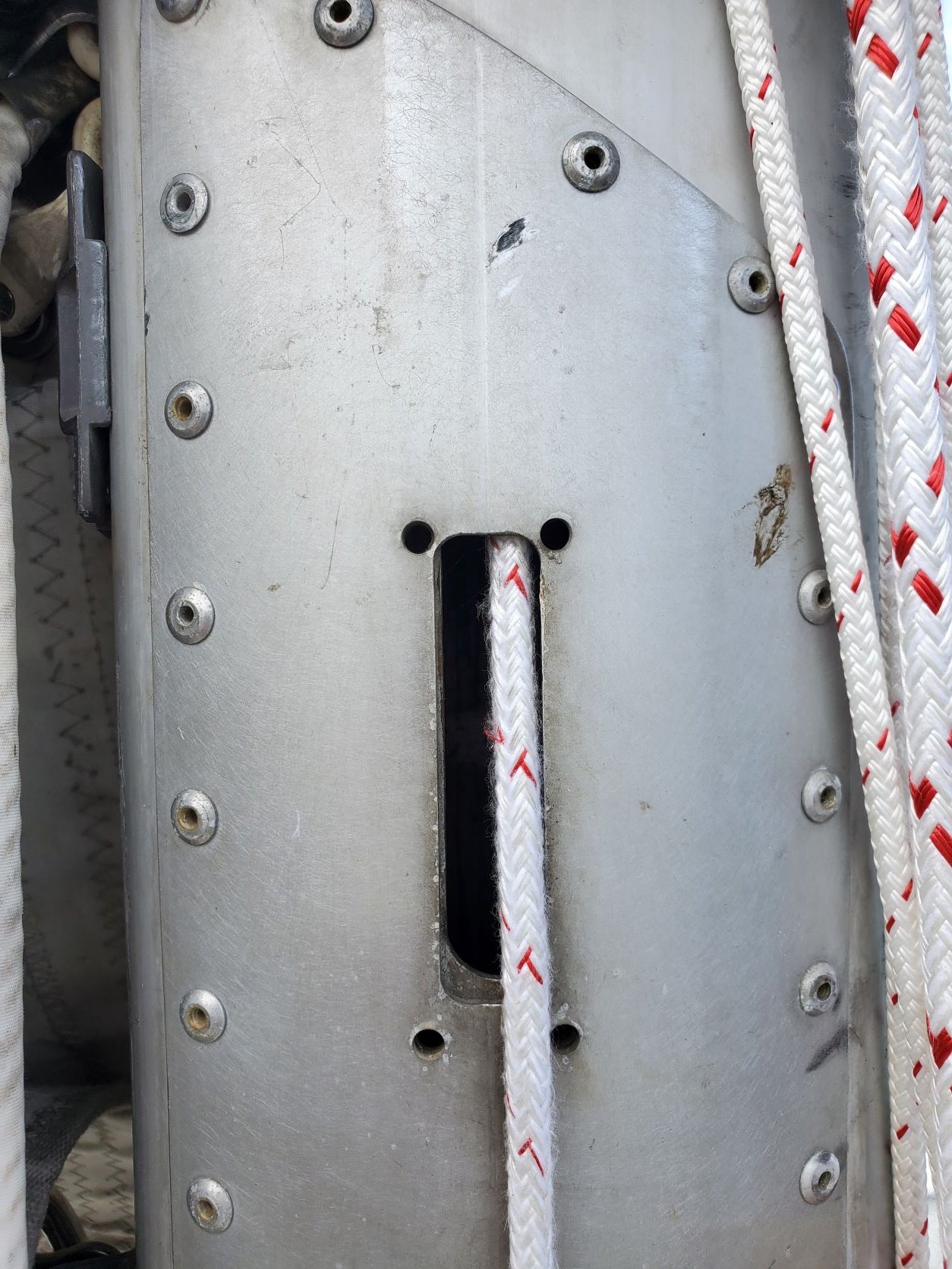

Sorry that I don't have a picture to post, but my Hunter 280 has a sizable hole in the starboard side of the mast where I assume that the Topping lift was meant to exit via an exit block then go up to a cleat. The hole is there with 4 mounting holes in a rectangular configuration but nothing remains of the block. Hoping someone will have a picture of the correct exit block.
Interestingly, US Spars says the mast should be a Z351 but that has round sail slides and my mast has a rectangular slot for sail slides so that would make it a Z301. What mast is on your 280? Anyone have a similar exit block on the starboard side?

Can’t tell you it is OEM.
Looks to me, to be a previous owners install of an exit block. The large size was cut to simplify the install of internal halyards.

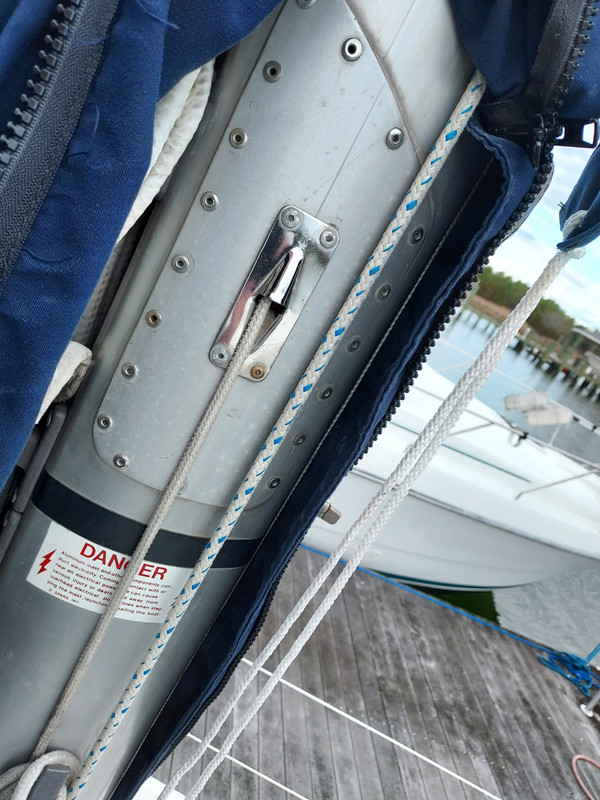

Thx for reaching @Tally Ho
Perfect timing too. I am off tomorrow and the marina is right around the corner. I will run by and get some pictures.
Aug 19, 2021
511
Hunter 280 White House Cove Marina
Okay, sorry about posting later than I intended. I swear it is just an "exit block" (@Crazy Dave Condon ) to prevent chafing.
We are under a small craft advisory today and and I did not break out the borescope and investigate more.
I hope this helps.

Yes there was a rectangular exit block offered by Z Spar.
Keep us posted on the exit block. As for the above picture showing doubled plated, I don’t recall that on the mast but inside at the bottom you can see the original mast which is curved!!
Thx Dave
If you look at the danger tag it is a Z Spar Inc. mast.
AND
I learned the proper name "Exit Block".
Life is good.
I hope this helps.
Yours does have the same reinforcement plate…I guess I wasn't that observant when I had my H280.
