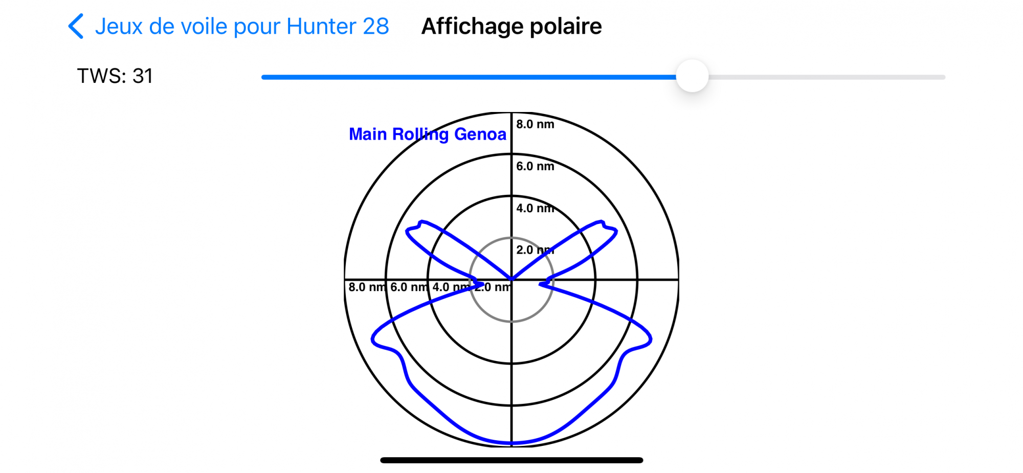

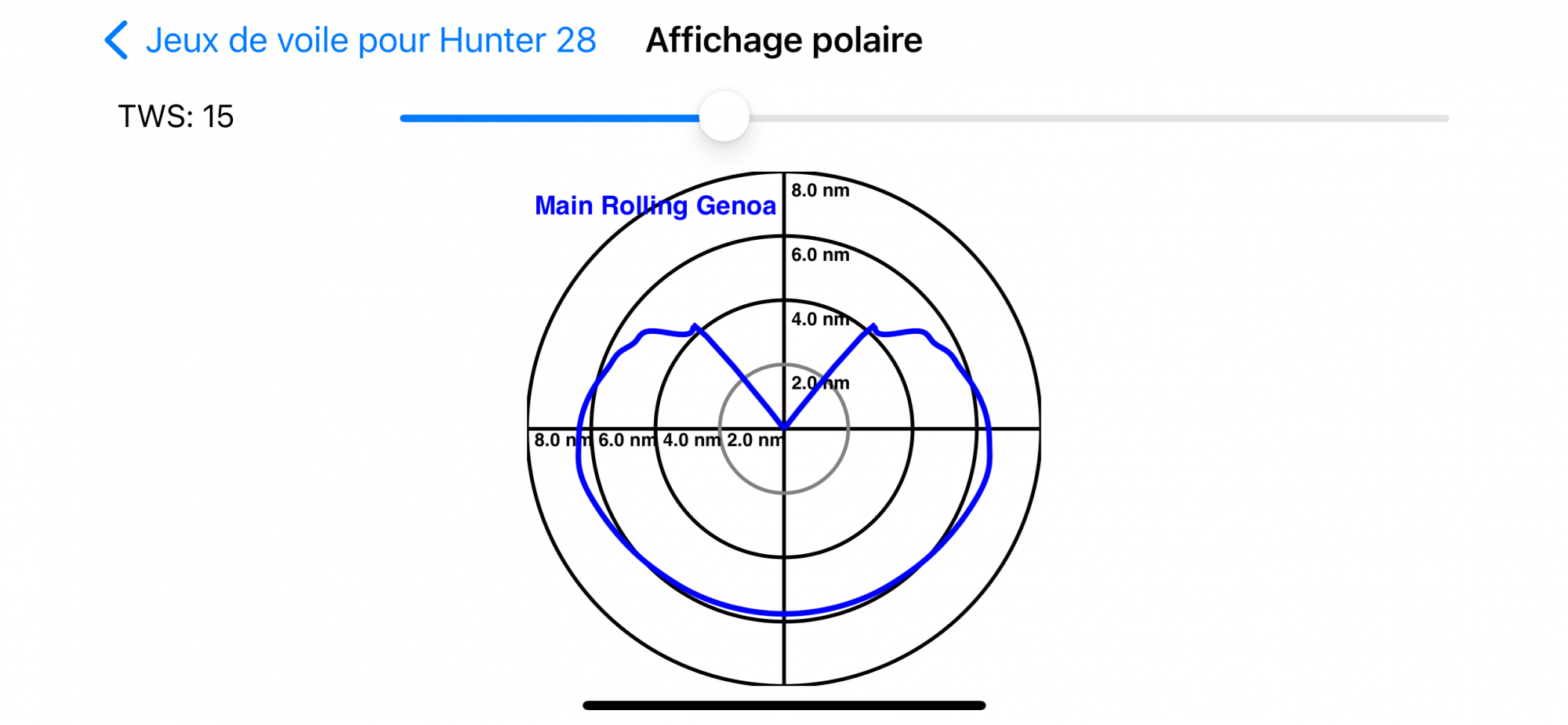

I really think something is strange with my polars. Below are two screenshots at 2 different TWS :

Are the TWS numbers in knots? The TWS 15 plot doesn’t look too wacky to me. In a good breeze like that it shows you close to hull speed on a reach or run, and 4 kts on beat, which sounds pretty reasonable to me. The TWS 31 plot does look a little wonky on a reach. But even that one looks pretty reasonable, except for the 90 degree point, considering it’s for a very strong wind.
Yes, they are in knots indeed.
I‘ve just bought the boat before the winter season and had no chance to sail on it yet. I think I’ll control the polars while sailing and eventually modify them if needed.
At least these “theoretical” polars I got from calculation using boat measurements will be a good starting point.
thanks.
