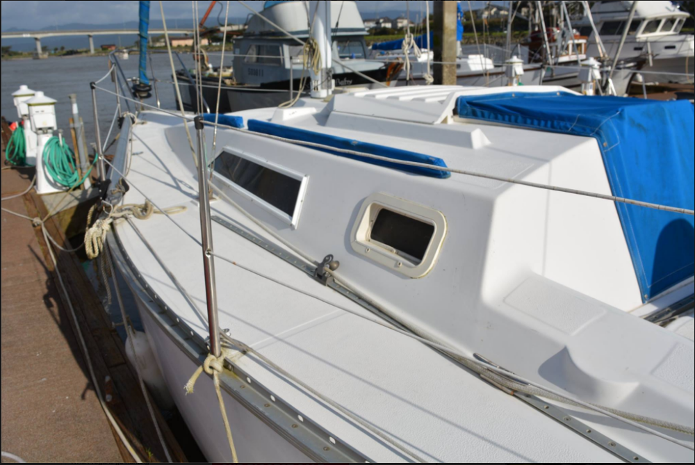

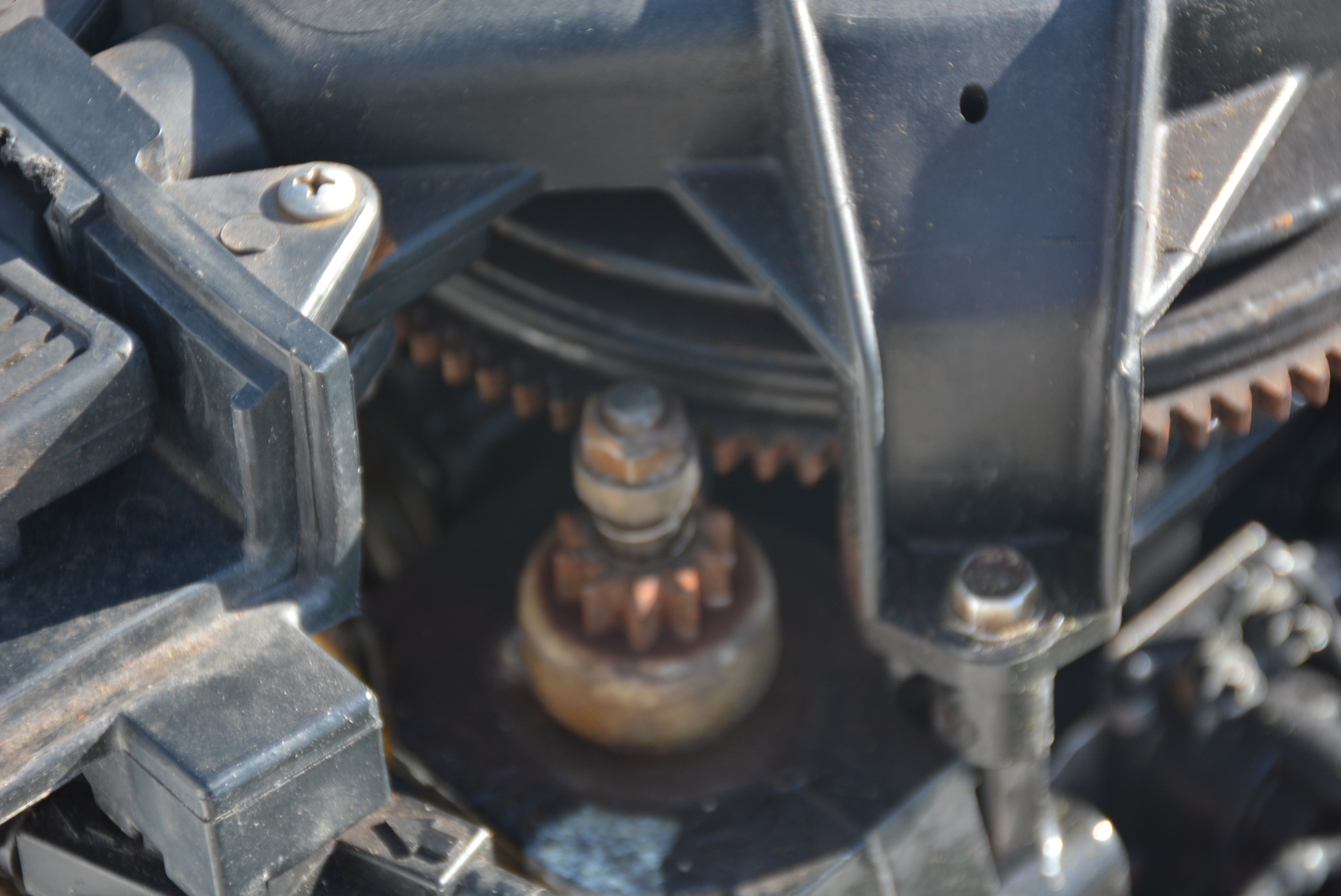

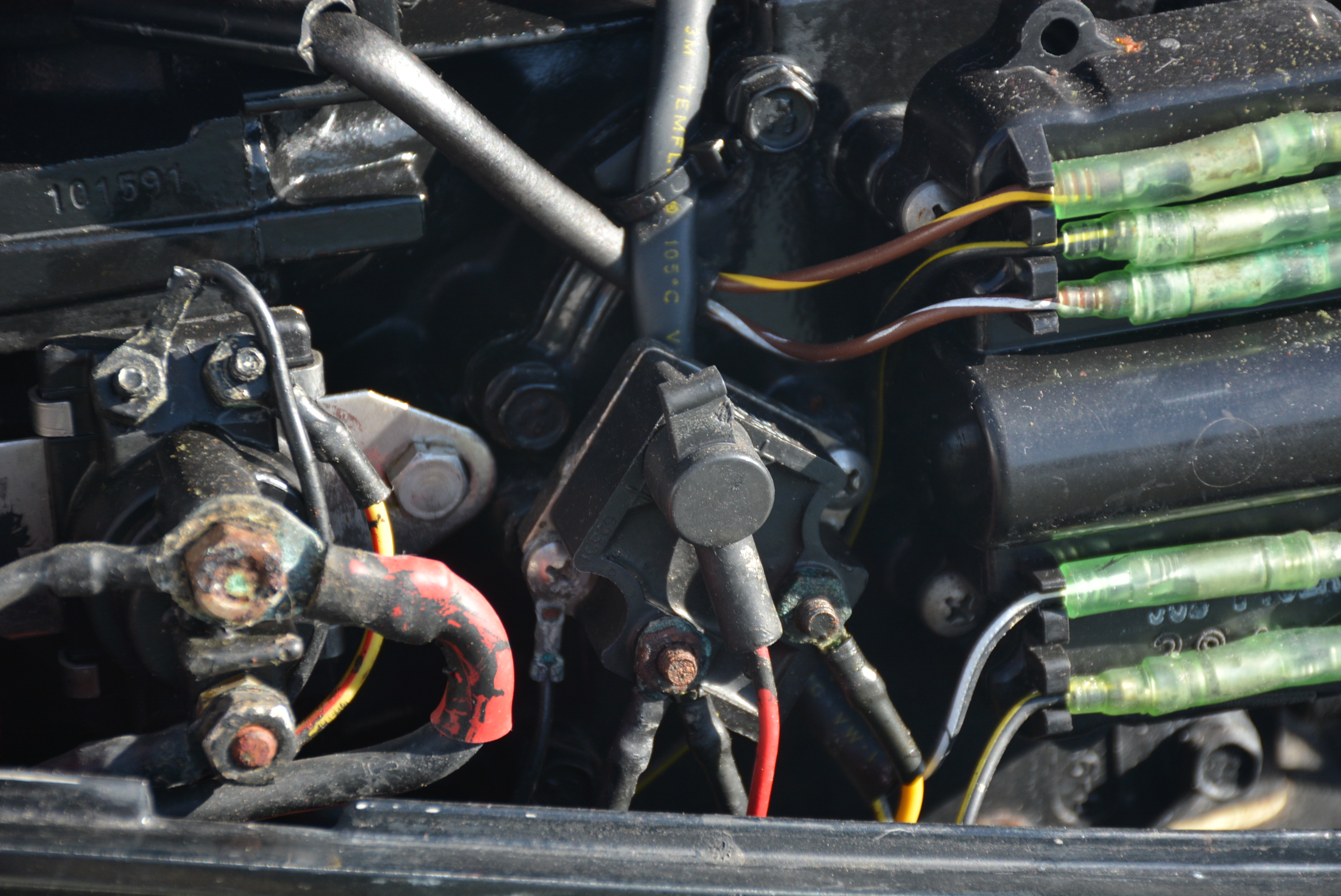

I popped the 'hood' on the engine the other day and found a few things I want to address.... the first of which is new spark plug wires... mine are dry and cracked!
Next is some corrosion in various places at electrical junctions.

Slipping in a little work on the o/b while working on the inside of the boat

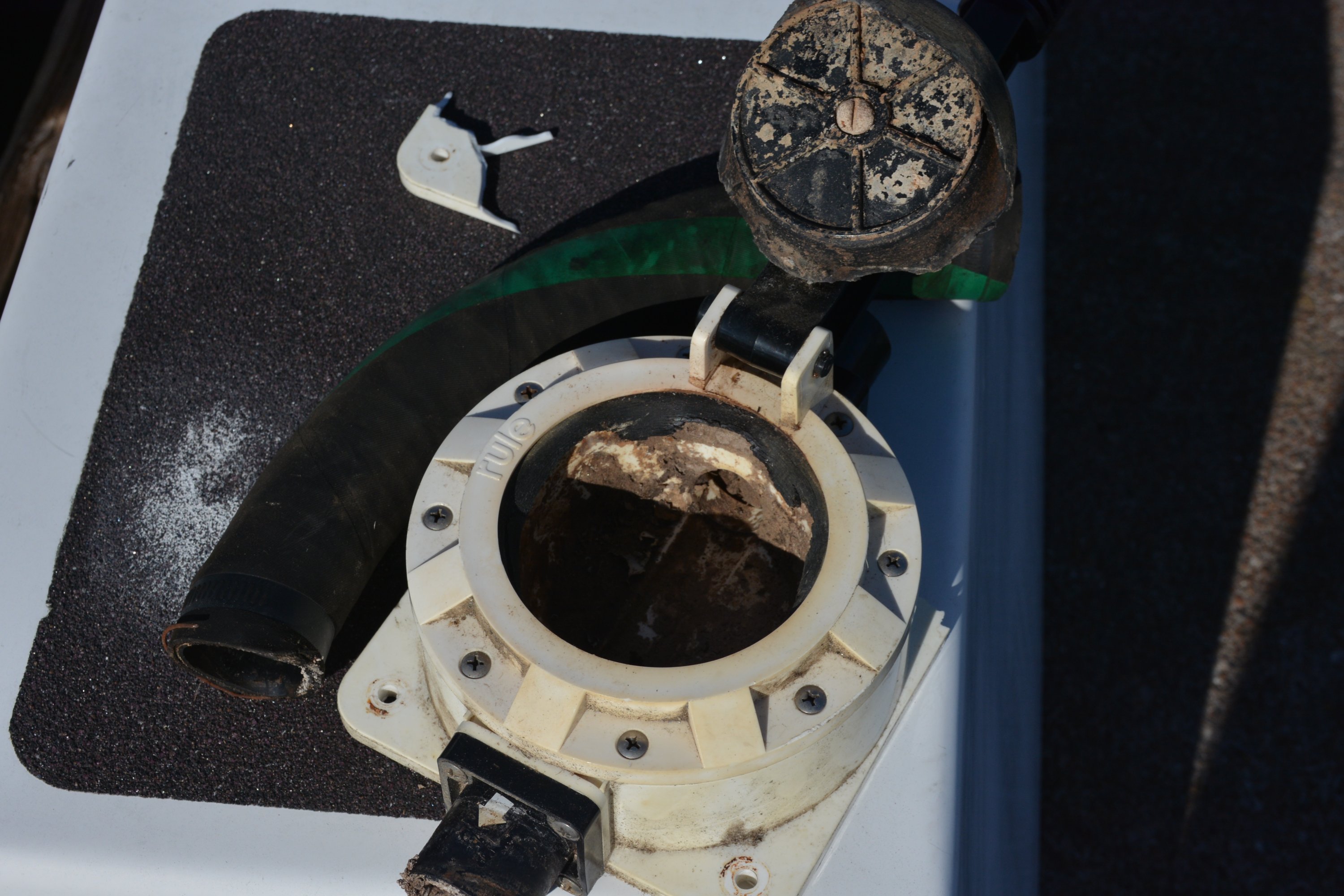

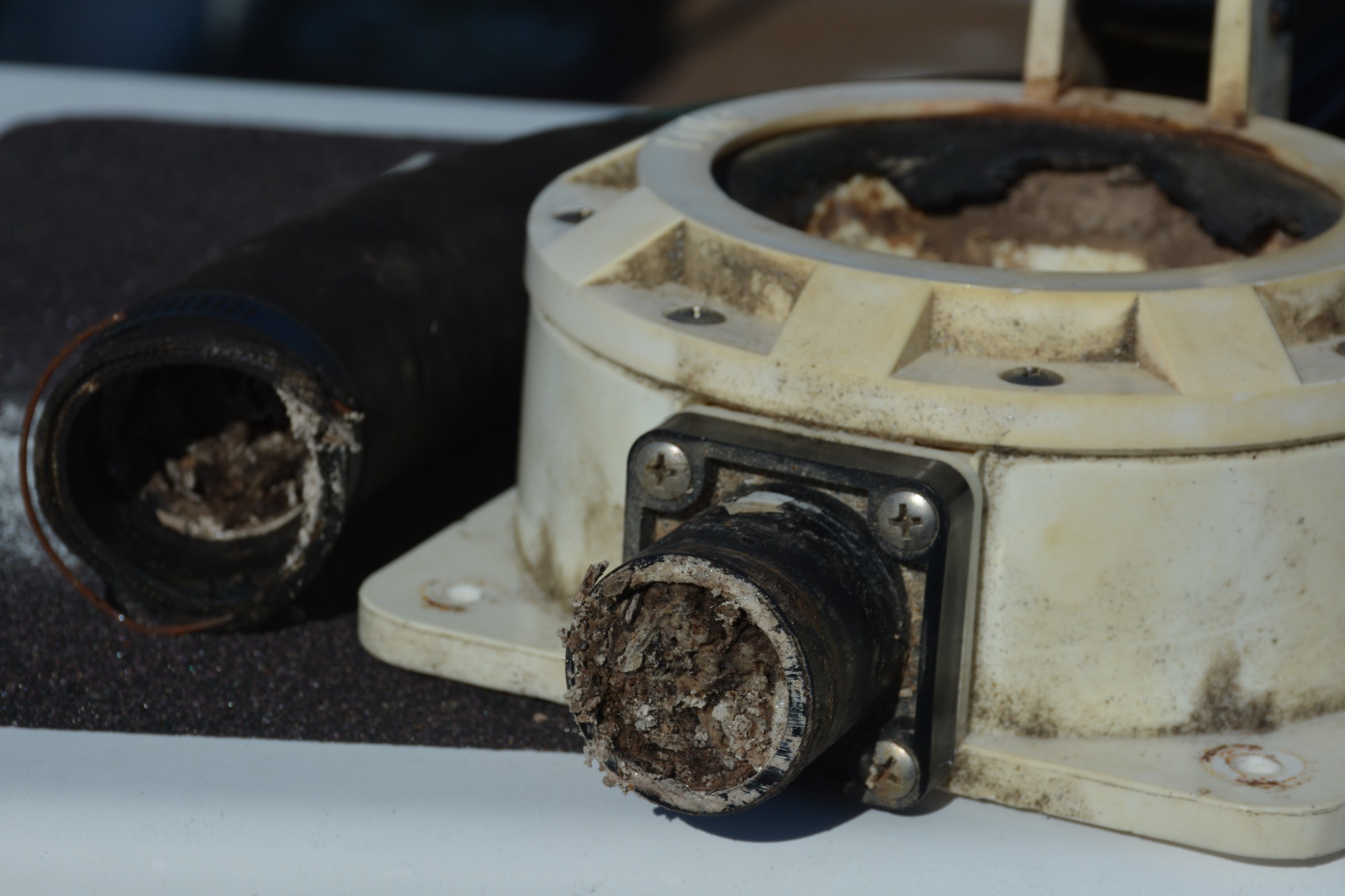

Yesterday I took some time to check out part of the waste system...
I knew the manual waste pump was shot... didn't realize how clogged up the pump and at least one hose were!
Guess I'll be giving the whole system a once-through!
Should get this resolved before I (hopefully... soon) get my o/b parts in and get the motor running again.
That way... once I have the ability to motor to the pumpout station, the waste system will actually be ready to allow a pumpout! :)

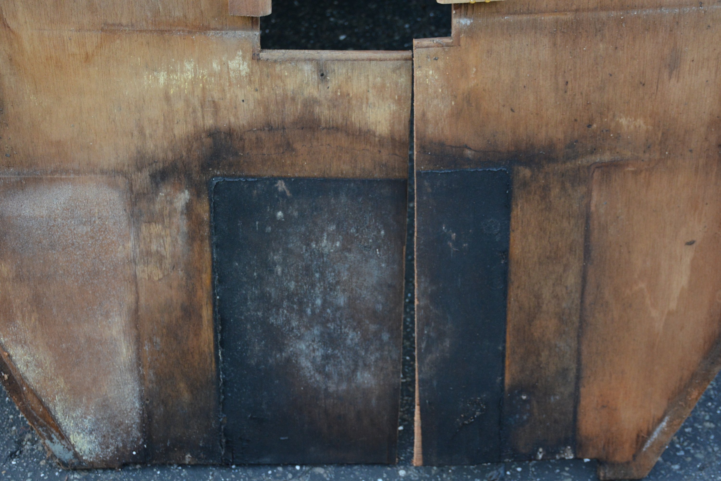

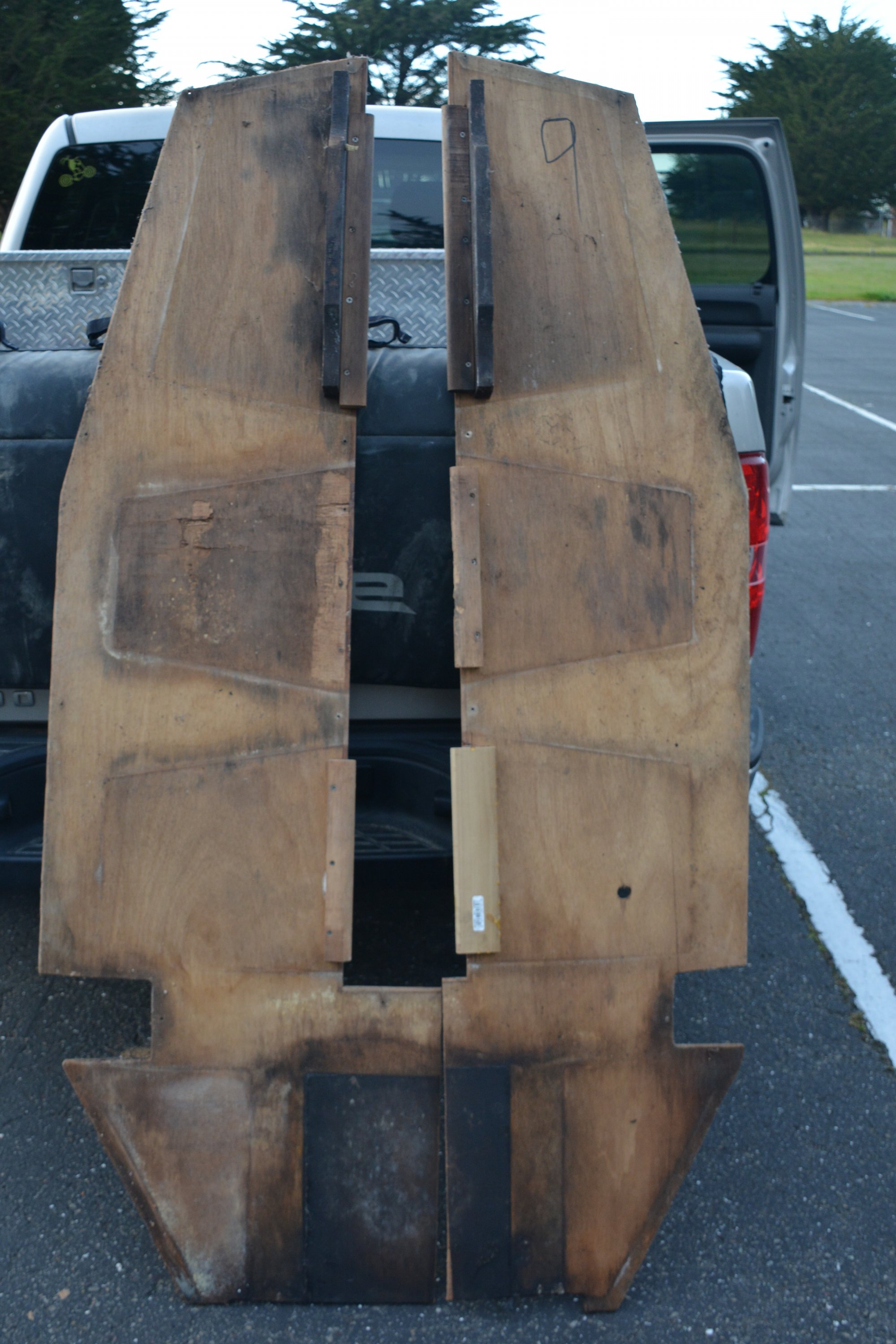

I also took out the remaining part of the cabin sole... the biggest part.
I wound up ripping it into 2 pieces to facilitate removal, transport, repair, and replacement.
The PO and the PO before the PO, apparently figured they could just put in some wooden wedges to keep a failing floor from failing totally... I, unfortunately, almost dropped my knee completely through it recently!
I have my plans for an attempt at saving this, we'll see how it goes, but I'll be open to options should this repair not meet my standards.

WSMac, I applaud your ideals.:clap:
Remember in establishing standards these are for a boat. One that will have a variable amount of use. What you put into it will be known and valuable only to you. The next owner very likely will have no clue as to the importance you have placed on the changes and improvements.
Boats often are not enginered to the same standards you would use on a land based dwelling. Different forces, level of use, and experienced conditions can lead to standards a house carpenter would see as poor, while a marine carpenter identifies as functional. Some of this is weight related. Small Sail boats are by their nature made of light weight materials where it is possible. So a floor that can hold the weight of a person or 2 is all that is considered in a boat, But on a back yard deck would be unacceptable.
Be careful not to make yor boat top heavy.
You are on a great adventure. I am enjoying your discovery. May the projects give you much joy. I look forward to you sharing your sailing stories. May they start sooner than later.
John
Remember in establishing standards these are for a boat. One that will have a variable amount of use. What you put into it will be known and valuable only to you. The next owner very likely will have no clue as to the importance you have placed on the changes and improvements...
John
I'll have to disagree with you on this one... I think once anyone on my boat sees the amount of GOLD and JEWELS I put into my head... they'll agree about the value! ;)

For the sole... same thing. I was thinking I'd just try and repair the bad spot on that one piece of floor... maybe glass it... but if that comes out poorly, then go to options I've seen other boaters take, here and elsewhere.
I'm all about keeping my boat from being a heavy old boat, and listing all the time.
