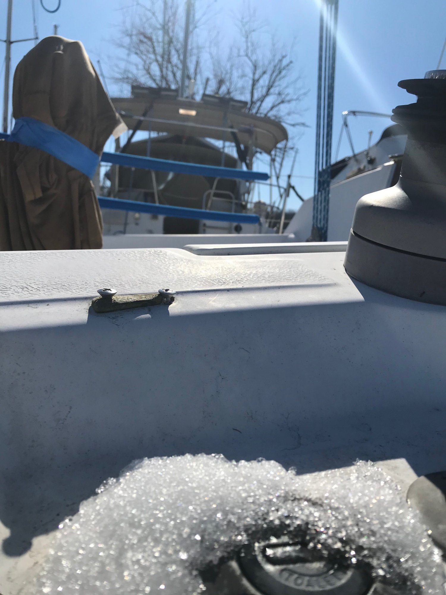

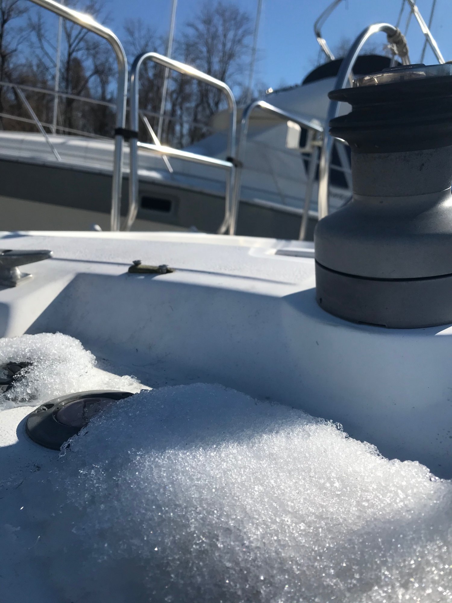

I have some photos of what remains of a fixture I found aft of my Jib/Genoa winch; this fixture is behind each of the winches. Any best guess would be appreciated.

It does not look functional. I would remove them and fill the holes as described in this youtube video entitled "Getting Rid Of Old Screw Holes In Fiberglass".

They may be the attachment points for a "Wheel Pilot". Over time they wear out and are discarded/stored for future repair. Can you contact the seller?

Maybe a tiller pilot....wheel pilots don’t mount on the coming.
But I agree, remove the screws and fill the holes properly.

Thank you for your best guesses, and for the repair video, will be a project for Spring, Yay!

The OP seems to have a wheel.
Maybe a tiller pilot jury rigged to hold a course on a wheel???

Looks like a wedge base plate for a jamb cleat put on backwards

Ding, Ding, Ding..
I think Mike is the winner!
I don't have any jam cleats on the deck, so it didn't register.

I think is old cam cleat base where po had a block on either side maybe spinnaker or just tweakers and po kept his blocks and cams
