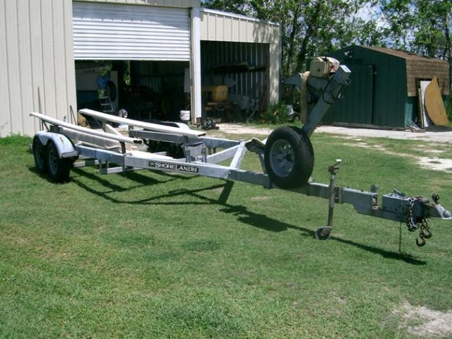

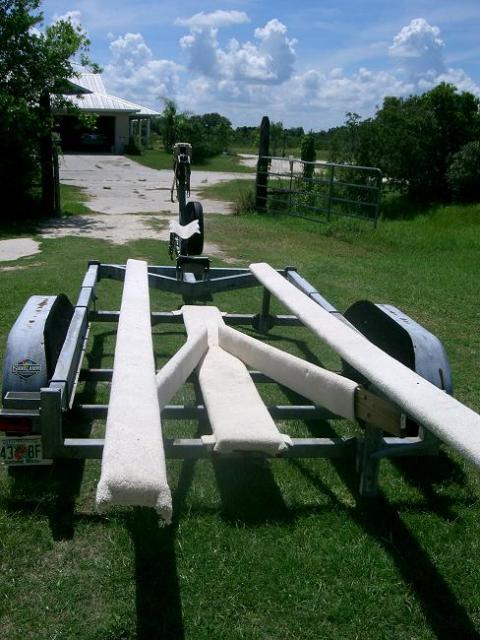

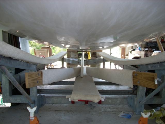

I'm pulling my trailer out from under our 260 next wknd to repaint the bottom so I can finally get it back in the water for our upcoming season. I can take some measurements from the trailer to get the angles you'll need. Here's a couple trailer images and a graphic that might help with documenting your dimensions in case you can find them somewhere else.
I believe the hull angles are the same with the exception of the 270 having an inboard diesel and a fixed keel. I can get the waterline to hull bottom dimension and you'll just add the keel depth. Either way if you weld up a basic frame and allow for at least three adjustable supports at the sling locations for a nice pad and a padded bow block you should be golden. When I have mine on blocks I like to get some support right at the stern on the hull/deck joint too. Distribute that load evenly.

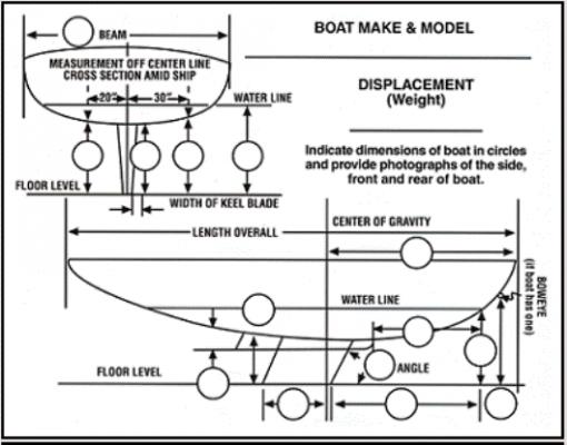

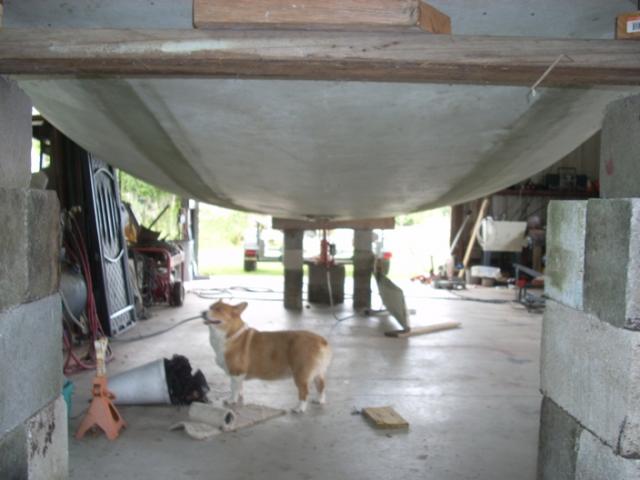

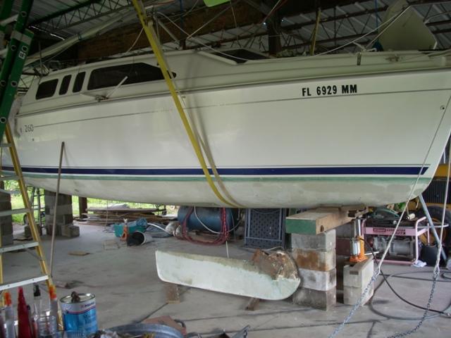

Here we go with the Hull dimensions/bottom lines for my 2004 h260:
"The qualifiers". From a point at the c/l of the stern running directly fwd to the bow as measured on a chalk line on the concrete floor following the keel line. The cross sections were checked with a plumb bob on a very consistent concrete floor and can be assumed within 1/4"+/-. There is NO allowance for the CB or a fixed keel, these are hull elevations only. The elevations outward from the keel line are typically where a trailer bunk should support the boat lengthwise. I'm posting the raw elevations just as my boat is hanging from the shop ceiling, so you can do the math that works for your need and I'll get back to paint;).
With the the stern c/l (known as cross sect "A" and 55 1/2" above the floor) also being a point on the floor known as "zero inches fwd", measure fwd 44" then port and starboard 30" at rt angles(this first intersection is c/s B). The hull elevations at these outward bound points from the keel were 47 3/8" high on both sides and the keel ht is 43".
The next cross section (c/s C, also the aft lifting strap zone on a w/b 260) from the stern is at 85" fwd and out port/star 31". The outward bound elevations were 42 1/4" and the keel ht is 37 1/2".
The next cross section (c/s D, at a point immediately below the aft edge of the 2nd small side window) is at 134" fwd and out p/s 30". the elevations were 39" and the keel ht is 35".
The next cross section(c/s E, the fwd strap zone) is at 212" fwd and out p/s 20". The ht was 39". The keel ht is 35 1/4" (this is typically a bow roller point on a trailer). (Edited for data correction 10-4-10 by MKS)
The next cross section(c/s F) is at 262" fwd. the keel ht is 37 1/8"
The next cross section(c/s G, also the overall length from stern rub rail to bow rub rail) is at 363" fwd from the stern and is 88" from the floor to the underside of the rub rail directly at the bow. The water line ht slightly back from this vertical point is 51" above the floor.
Hope this helps. Here's a pic of the way the dimensions were taken. Feel free to stop by for a painting/scraping party tomorrow;). I'd rather be sailing!

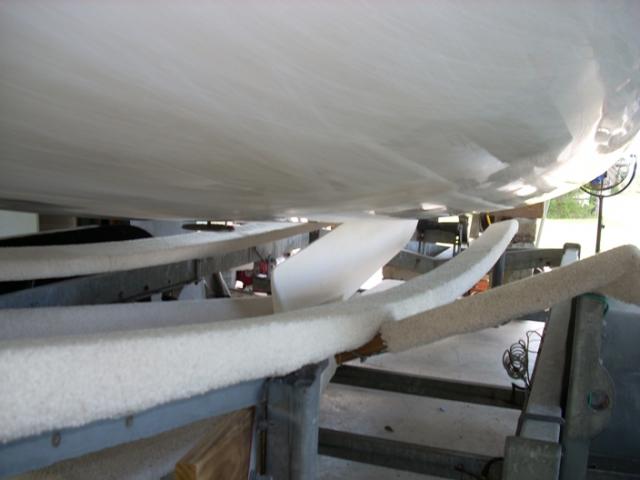

By the way, immediately forward of the "F" cross section I mounted a bow support shaped like a V that is carpeted(see trailer pics above). The "F" area is dense with glass and should bear the major load instead of the forward roller at "E" which imho isn't strong enough to support all the fwd weight of the boat on the limited surface of a roller.
