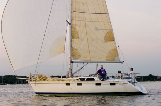

Poor man's bowsprit
Here’s an easy-to-make bowsprit, seats in the anchor locker.
This will throw the spin ahead of the main, less blanketing.
Tack line and 2 sheets permanently deployed for quick setup.
(Note that the link here has 2 pages of pix and directions.)
Typo correction: Eyelet should be 3/8 inch.
