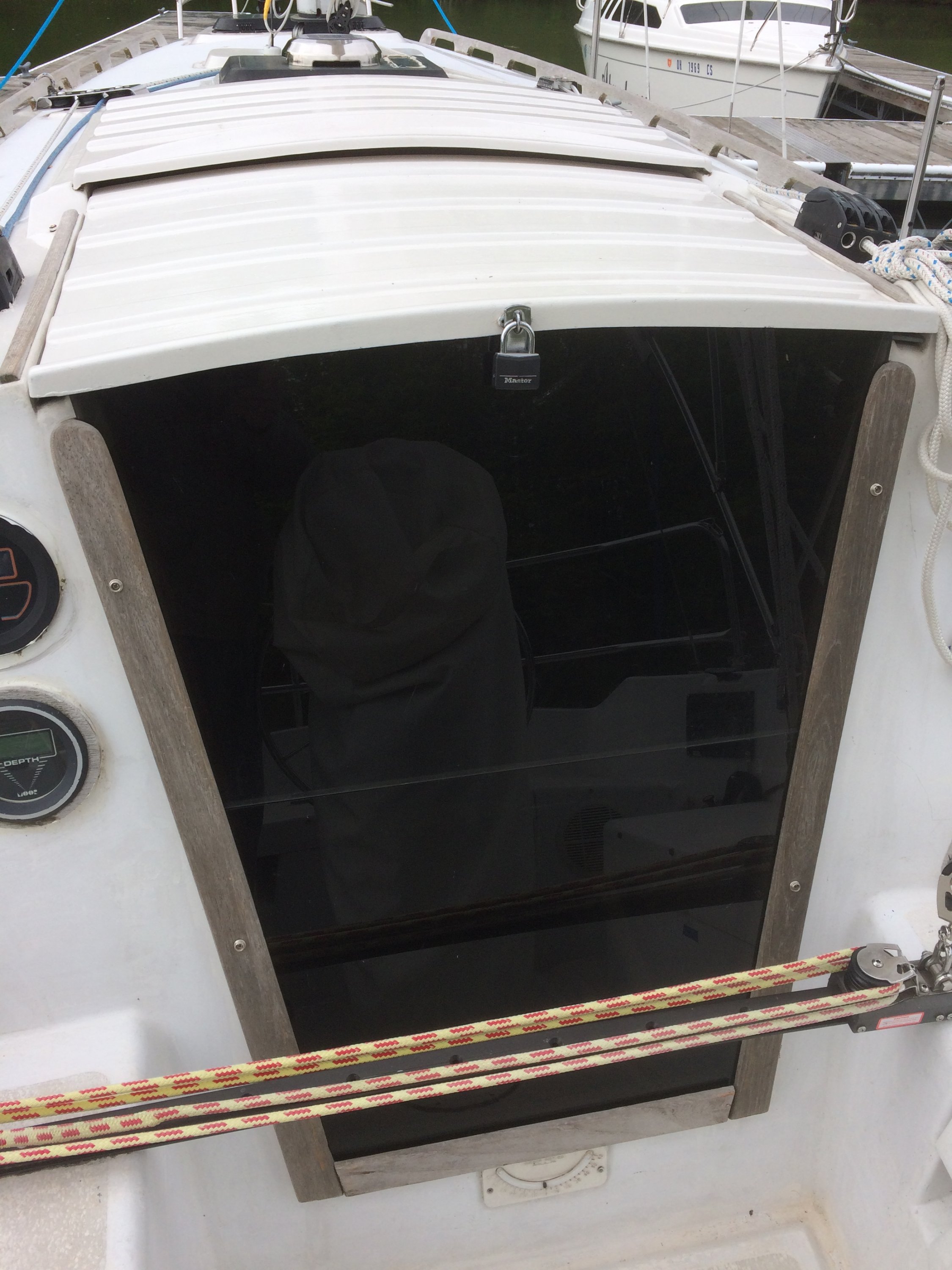

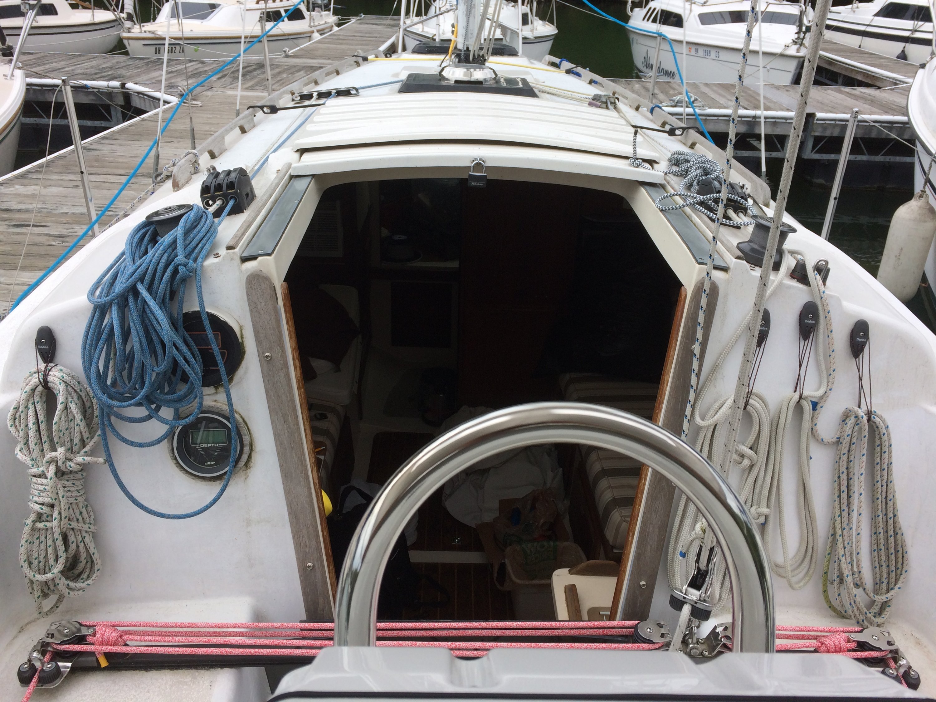

This is the hatch on the '81. My boards are maybe 1/4" proud. I lift the hatch slightly to clear, and they seem to nest just fine. There isn't really a mechanism; it just slides on the Teflon guides and is held down by the clamshell. The shell is pretty easy to remove, just a bunch of screws. I have to take mine off every year to clean it out and grind off some more of the front lip that scrapes when you open it and makes a heck of a racket!
