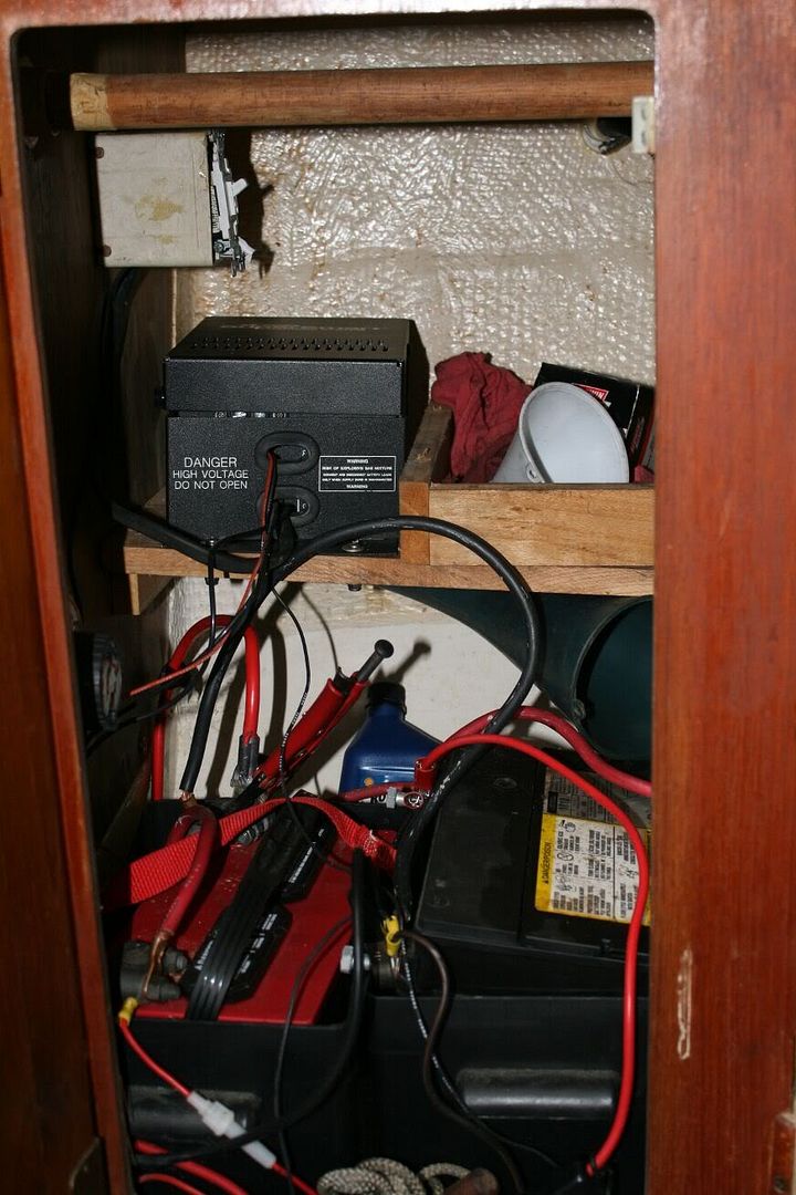

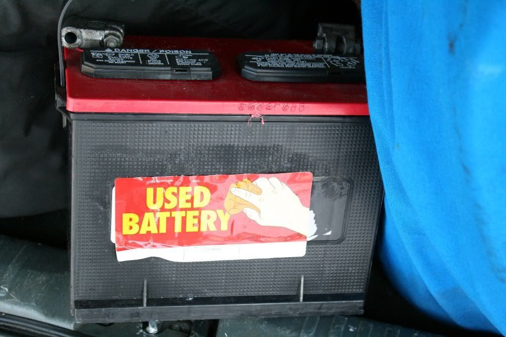

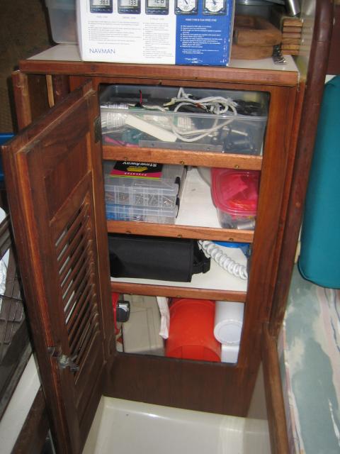

It's official, the boat is mine. I went down today to collect the sails, cushions, batteries,and begin the work. First of all, the electrical system is a joke, everything non-Hunter has to go. The previous owner may have been an excellent aircraft mechanic, and maintained the engine perfectly, but he knew nothing about boat electrical. he has 2 batteries in there, a Die Hard sealed car battery (11.5v) and a "USED BATTERY" No kidding! look!

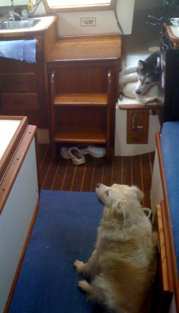

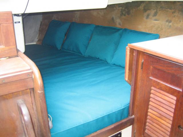

aaaHAHAHAHAHA! used battery. Gonna be used as a core for trade in along with the other one. This is where the batteries and charger were before I ripped everything out, this is under the chart table, in the 1981 and up models there is a seat here, I am going to convert this cabinet into a seat like this one here (2nd pic)...
1980

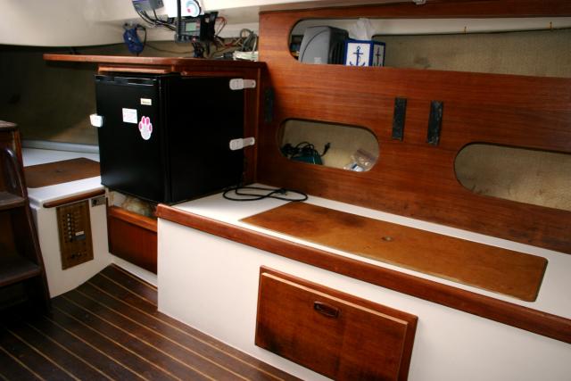

1981. This is not my boat, but one I tried to buy.
So I will be moving the batteries underneath the seat just behind the switch panels.

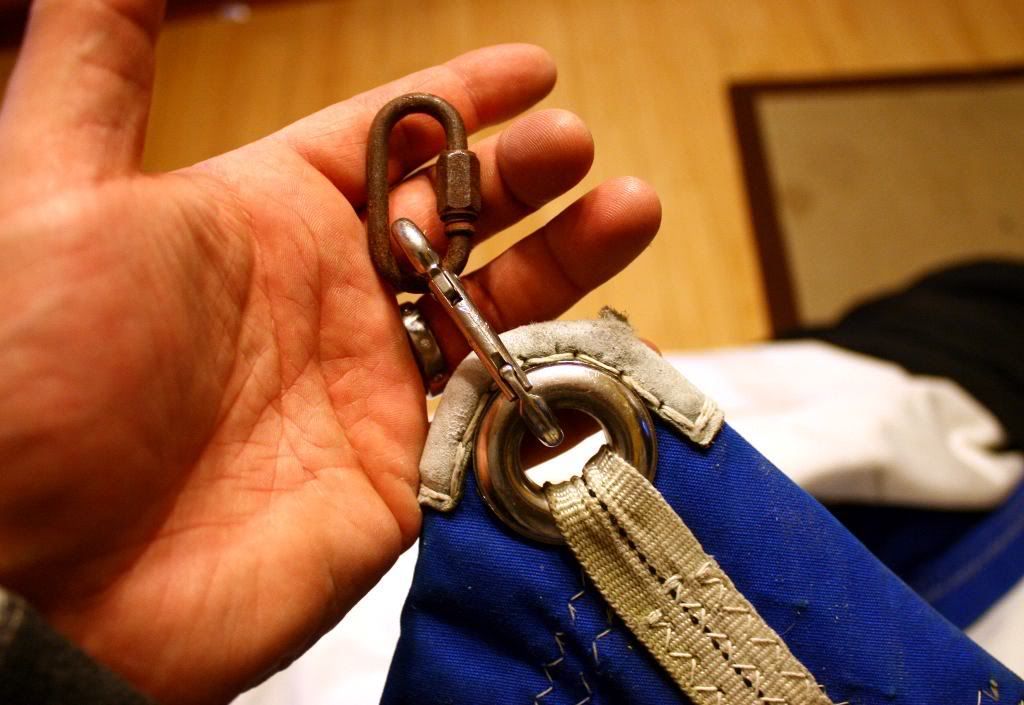

What is it with people and Home Depot hardware on boats? Unacceptable. This is the genoa clew. The genny is in pretty good shape, it's the only newer sail, rest are original. main and 2 hank on jibs, anyone want them?

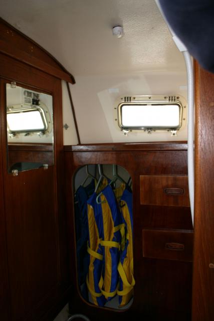

You are a lucky guy to be able to be messing around with your new boat. Some of us are stuck in several inches of snow. It isn't clear to me which pictures are your boat and the other boat. The two batteries in the bottom of the hanging locker, yours or the other? Where is that hanging locker on an H27? And you plan to have the batteries under the nav station? Surely there is a way to keep that space open for your feet.

I had to shovel a foot of snow off the boat to work on it :D The hanging locker is on my boat, it's in the same spot as the nav table on the other boat. The batteries right now are (or were before I got rid of them) where I want my feet to go. I want my boat to look like the other boat, I will be putting the batteries under the quarterberth where they were supposed to be in the first place.
Nov 8, 2007
1,618
Batteries
That's right, the battery(ies) go under the forward end of the quarter berth. Then the hanging locker with a stand-up (nav?!) table is between the quarter berth, and the port settee. Honestly, the best nav table on our '77 h27 is the starboard leaf of the drop-down cabin table. Good space on the table, good view out into the helm in the cockpit, and solid, secure seating.
But with a good hand-held GPS, most of the navigating has moved into the cockpit for us. I use the setup described above to plan a route, set up waypoints, etc. before getting under weigh.
But it is your boat, and your PO(s) have clearly taken some liberties, so enjoy yourself! Do get in some sailing time when you can, though.

Hanging locker?
Emkay & David,
So do you still have a hanging locker in the head? Our boat had a dorm fridge under the chart table (so the chart table is a great place to make a drink :dance:) It doesn't look like it was the seat setup so I wonder if it was also a hanging locker.
Emkay,
What's the light switch for in the locker?

I had a similar horror show with the electric and the under Nav station storage locker. Ended up turning it into storage shelves and rewiring the rest of the boat. I also lowered the nav station top and hinged the section hanging over the rear berth. Now all the counter top heights are at the same level and with the lid folded down there's more room in the rear berth. Still have to add the new wall liner.

Yeah, there's a locker in the head, and the switch goes to the battery charger. There is another mystery switch in there that goes to the inverter. I think they all had that locker until '81 when they changed the interior design. Does yours have the wood companionway steps?
