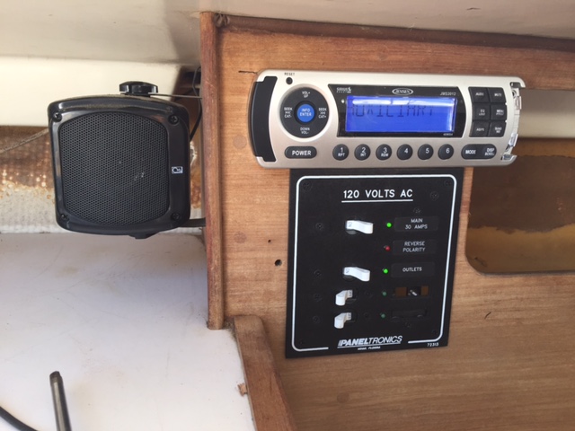

Ok. Getting there. Put in a new 110VAC Panel and all new lines. AC plumbing and thru hull is done. I mounted the pump and strainer by the shaft log in the little open room. Nothing like a full day working in a tiny access port.

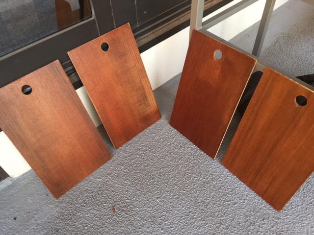

Also, the varnish is getting there. Doing everything on my terrace at my apartment in JC. I am going with a Satin varnish for the interior.
Is your radio and a/c switch mounted next to the nav table? I'd love to see another picture not quite so zoomed-in, I'm thinking of doing something similar...
Jul 21, 2014
61
Hunter 27 Cherubini Lanoka Harbor
Yes. It is to the right. I can get some better pictures this weekend.
The original breaker was 20Amps so I added in a extension to the new 30Amps panel.
This is the best place I could find and next is the DC panel but will leave that down by the battery. I also placed a Battery charger and blade fuse type 12vdc panel in the hanging locker.

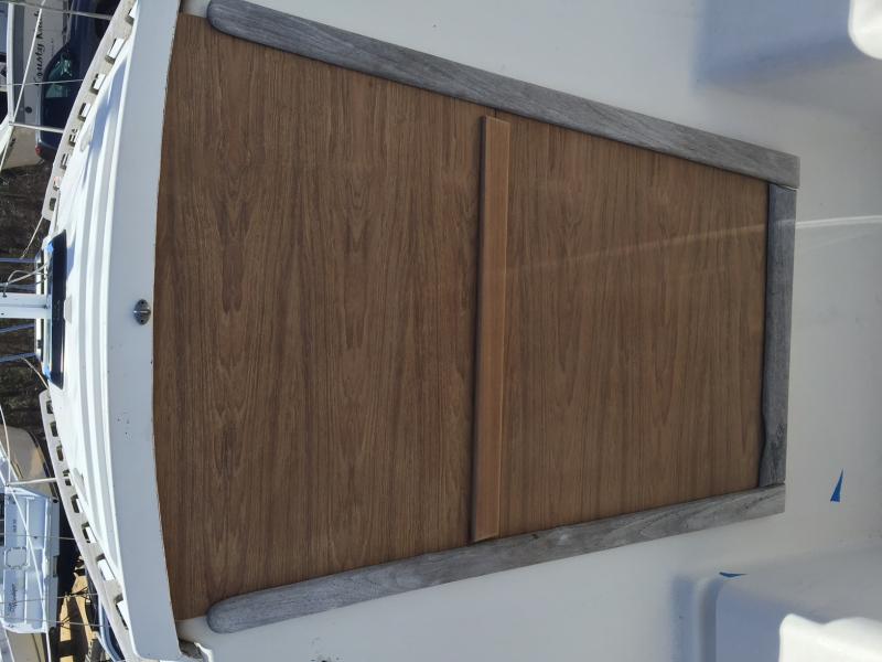

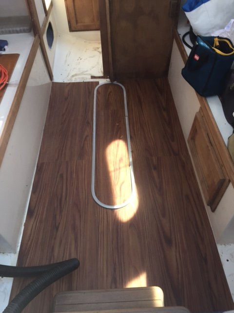

Ok. Update. Went with Vinyl teak floor (forgot pics). This is 3 hrs of my life i will never get back but looks great.

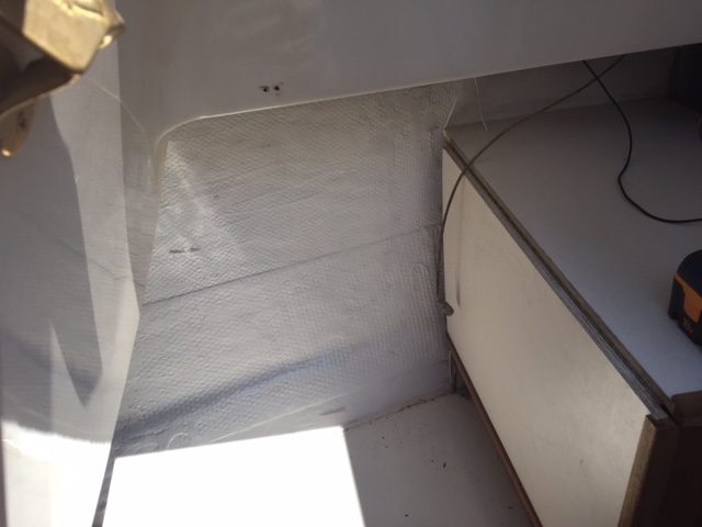

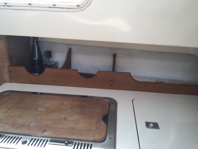

I see you removed the crappy textured "stuff" from your walls behind the nav station just like me. (I'm still vacuuming foam since the removal.) So you used Awlgrip...did you roll it on?? It looks good. I had thought about just using Brightside single-part paint, but after my recent experience with Interprotect primer I'm not afraid of two-part epoxy paint anymore...except maybe the price...
Jul 21, 2014
61
That foam was the worst. I ground it off with a high speed wheel.
Actually I used Jamestown Distributors 1 Part Paint. I did roll it on and brushed the finer corners. Overall I am shocked how much it changed everything.
