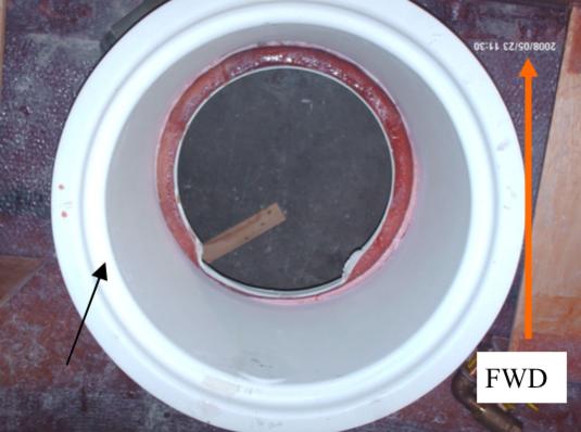

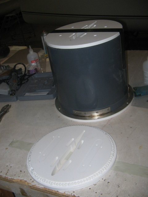

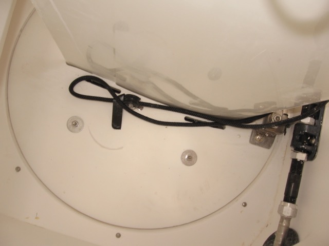

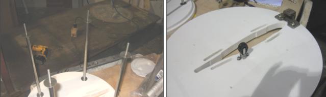

Attached you will find photos of the VARA RUDDER assembly of the Hunter 27 Edge . If you take time to look it should explain how this VARA RUDDER is put together.
The round drum is that of a 216 and the other pictures of a Hunter 27 Edge.
