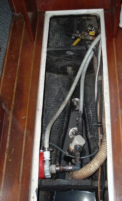

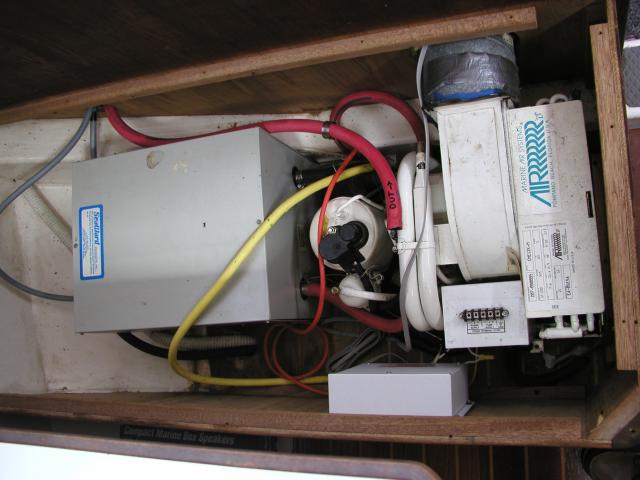

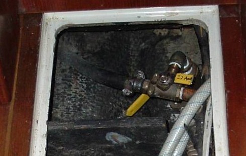

Install AC
this is in a Hunter34, but is posted for your perusal.. I used a 12000 BTU unit because it was the largest at the time that would fit in the locker. As ed suggests, I made a box the size of the unit and tried its placement in several areas before deciding on where it is. The 12000 is marginal for my boat (probably fine in yours) in bright sun when the ambient is around 95-100 F but still much better than none ! Night is when it gets used a lot and it will chill the boat as much as you'd want, once the major sun load is off. I have a seawater foot pump for the sink .. I teed into that line for water. I drilled the hole for the water outlet just above the waterline after very careful measurement. I fished wires under the sole using a piece of old lifeline.. I was able to run all wires and water hoses thru existing holes in the grid. Took me about 4 months of weekends to figure exactly how it would all come together..First picture is the space under a settee next to the water heater. Next picture is looking down on the installation before the cover goes on.Water heater had to be moved outboard a litttle and some water hoses had to be extended. Be patient ! and good luck.
