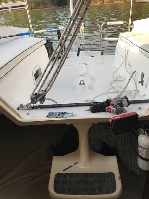

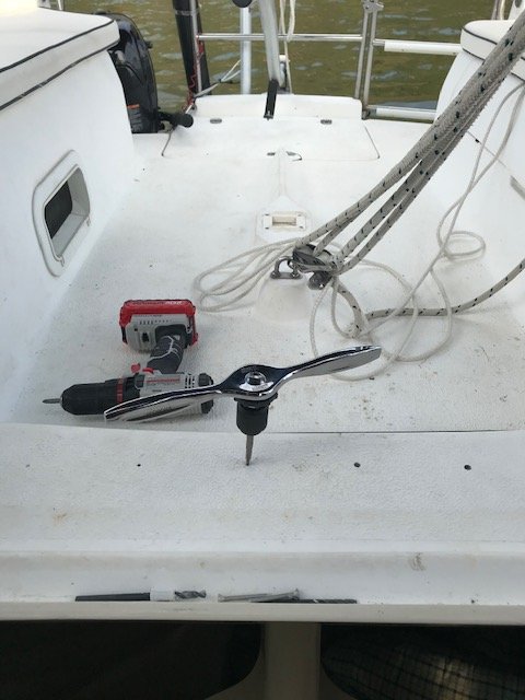

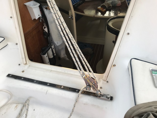

I had a Hunter 27-2 that I liked a lot after getting rid of the bridle. With the help of my rigger, we installed a Garhauer traveler as shown in the pictures. That was a great improvement.

Question for Jess: do you recall dimension between your bridge riser mounts.?
23,390
Measure your boat for the mounts. Get them as wide as possible. Remember this is a sail control piece of hardware. You will want to through bolt the traveler with a backing plate. Make sure you consider the inside required space and access to the bolts. Nothing screws up a good plan like not having the space inside the cabin to tighten the nuts.
Through the deck bolts need to be properly sealed so as not to leak into the deck.
Take care and the project should give you joy.

I added a traveler to an H26. If you think it would be helpful I’ll dig out those pics
Sorry
I forgot to dig out those pics... Here they are...
There is an aluminum plate under the bridge deck and I threaded and through bolted. I got a piece of genoa T-track off of eBay for a few bucks and made this traveler. It is not high tech but it certainly made the boat sail better.
