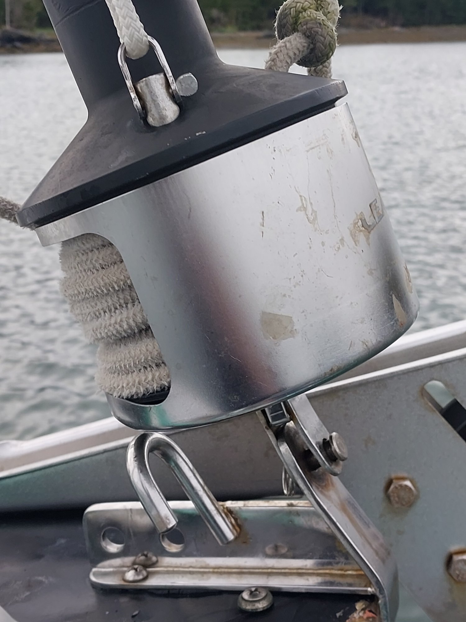

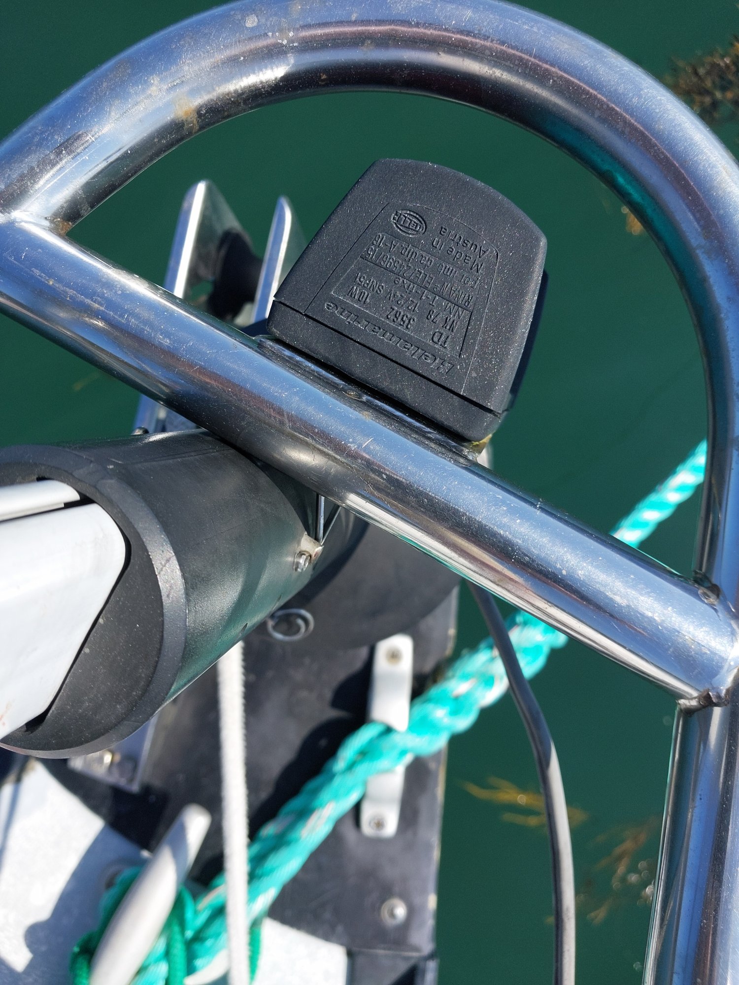

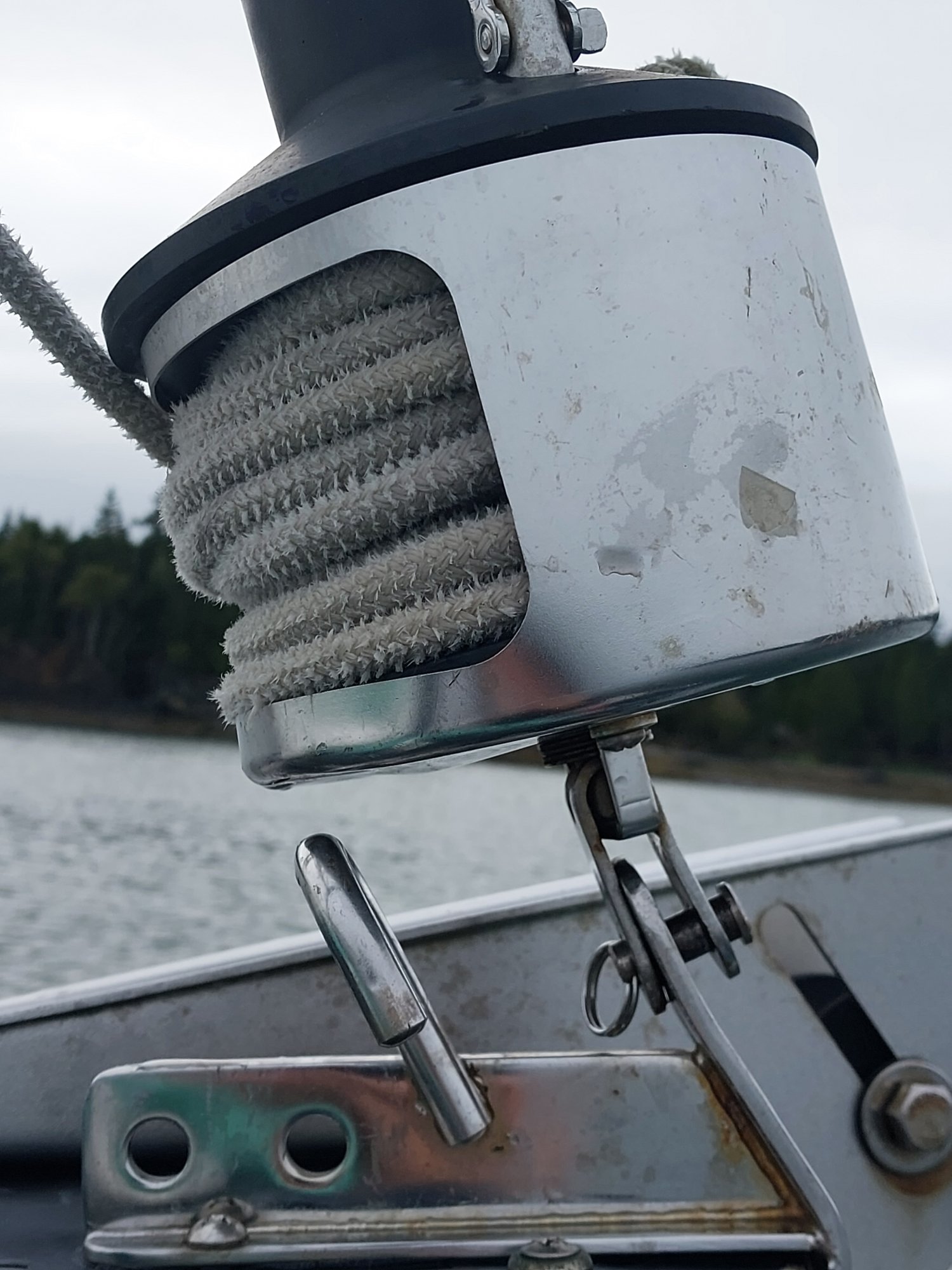

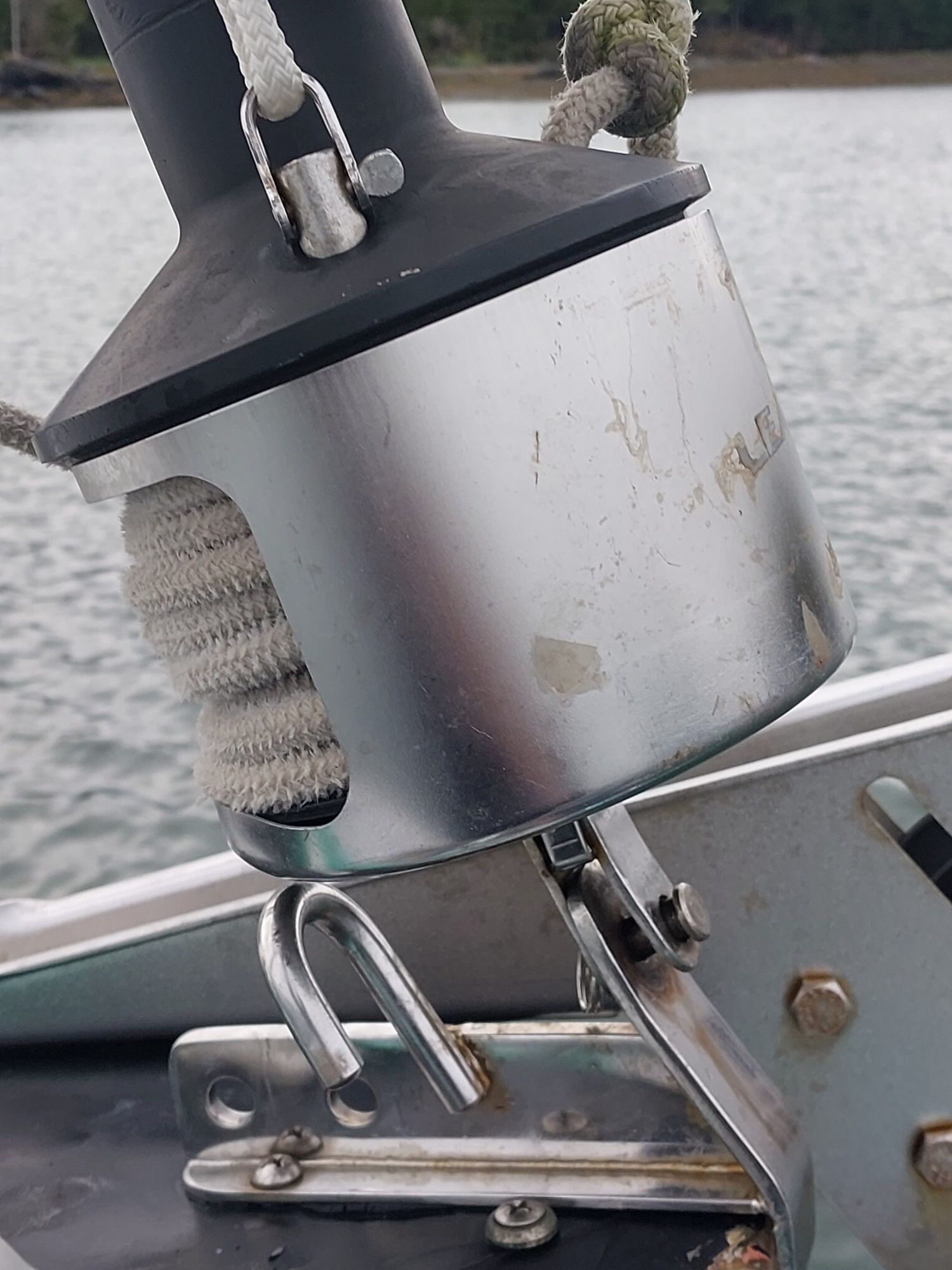

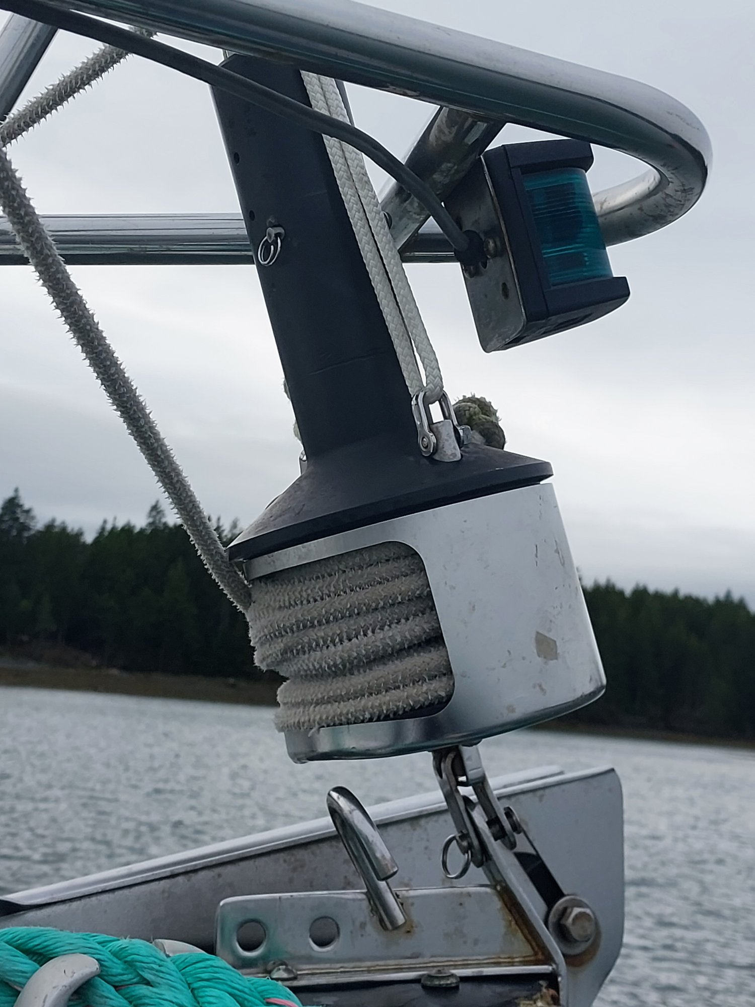

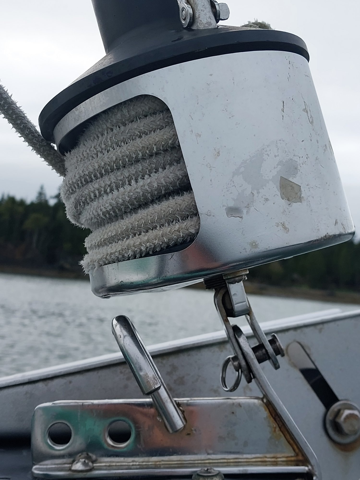

Hi everyone,
I recently purchased a Hunter 27 (1984) and have spent most of this season getting her back in shape.
The most recent issue I've encountered is the very limited clearance between furler drum-head and the pulpit. The clearances are so tight that during furling, there is standardly a complete stoppage. Not only is this frustrating, as single-handed sailer, it's just dangerous!
Does anyone have any ideas on how I might be able to effectively address this issue?

Just from the looks of it I would guess that the pulpit had been run into something solid, not that that would ever happen to a nice boat like that. a simple solution might be to tie a hard line onto the pulpit and back away from the shore based anchor point. I only point out this possible solution based on my extensive experience as a teenager. YEMV
I found a photo of a Hunter 27 from that era and the bent pulpit leg appears to be a design feature.
Given the age of the boat, I suspect no one thought about putting roller furling on the 27. I also don't know what the thinking was about the open front on the pulpit.
The only solution I see are modifying or replacing the pulpit or finding a roller furling unit that fits better.

Move the headstay attachment one hole aft in the bow fitting .. I see a hole just aft of the current hole being used.
maybe use vice grips judiciously and slightly flatten the aft side of that cross brace?

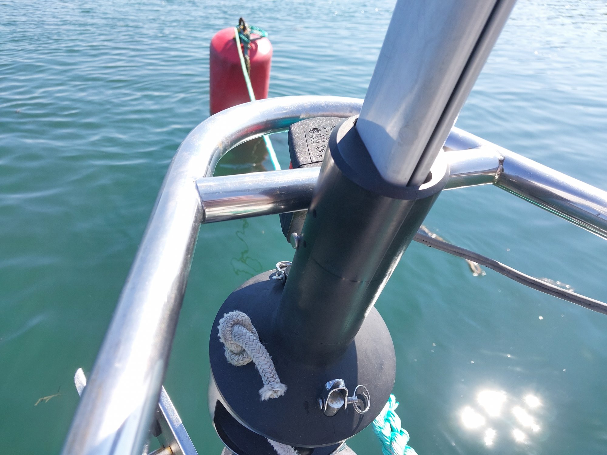

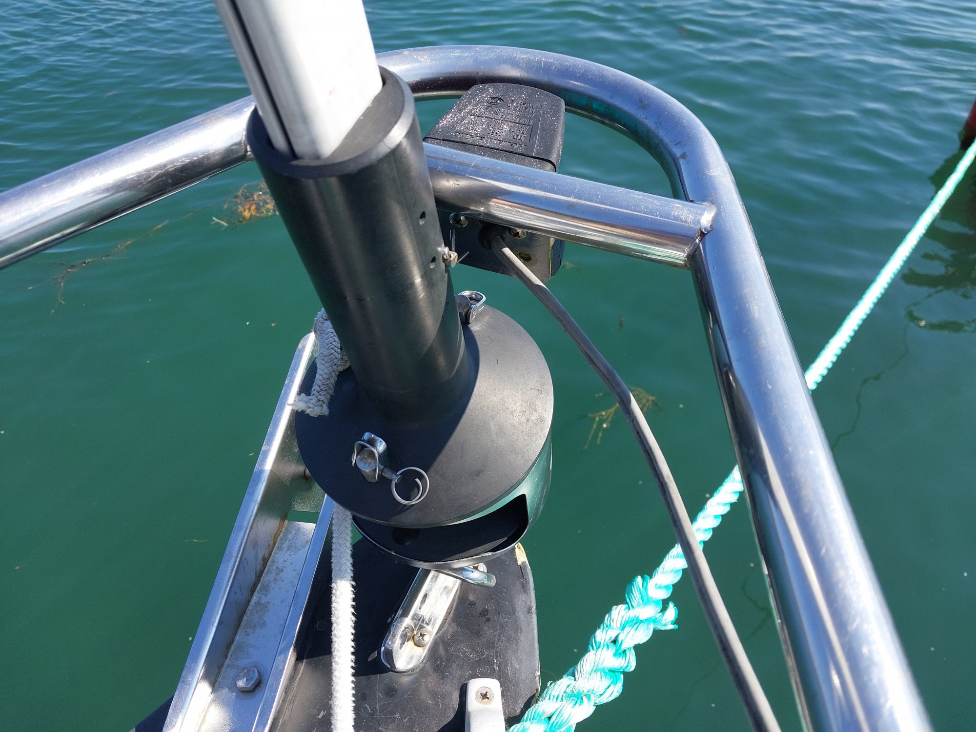

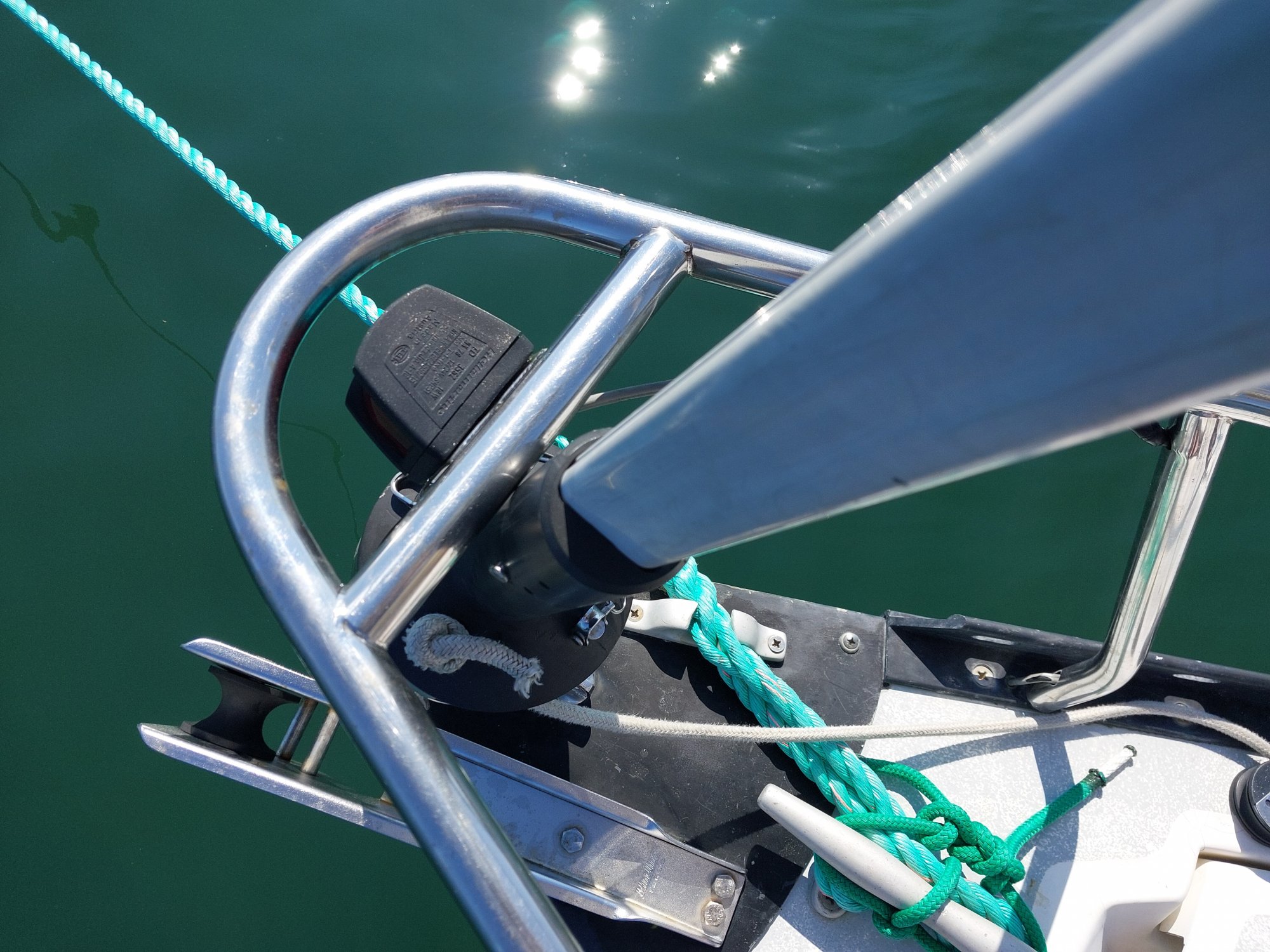

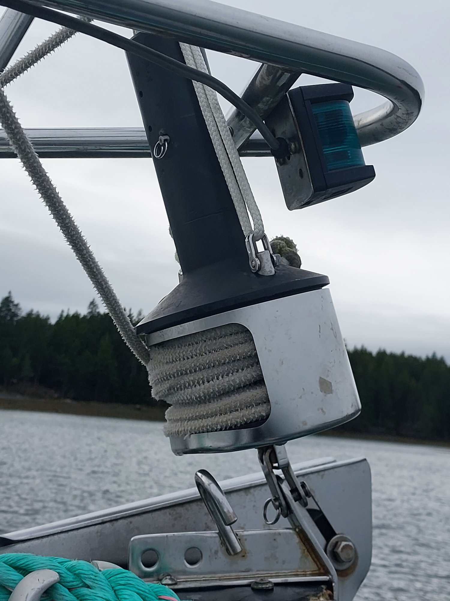

I can see the problem in your images. Looking for a solution the images all show the same parts of the furler. Can you post images of beneath the furler?
Often boats like yours have 2 or more spots to attach a furler on the bow stem. I think I see a bit of stainless beneath the edge of the furler drum. If so, I would look to attach the furler a step or two further back from the pulpit. Additional considerations with this solution is that the length will appear to be longer on the furler. As you move it away from the pulpit the distance between the bow connection and the top of the mast gets shorter. You might need to address that. I can not tell from here. The additional pictures may serve to help.
Good evening,
I appreciate your reply/insight.
I'd not considered that possibility and given the boat's age/experience, I should have. Acting on your suggestion, I've since inspected the pulpit much more closely. There is no obvious damage that I'd releate definitively to an bow area impact but I've not discounted the possibility.
I'll likely remove the pulpit this winter and inspect it's fasteners; I would expect them to be clearly bent if an impact of any significance previously occurred.
Thank you again; I appreciate your thoughts on this matter.

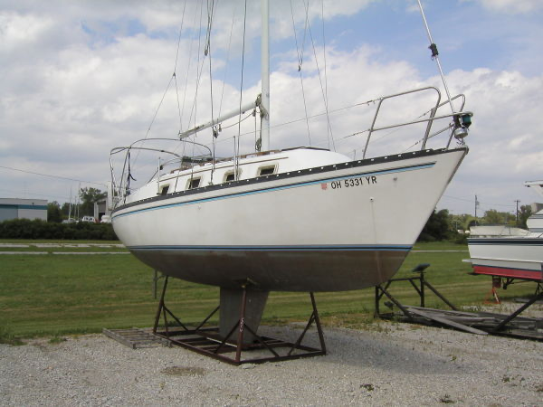

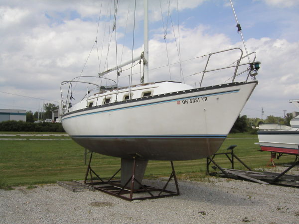

Hold on. Before you go cutting things off, do some more research. Here's photo of a Hunter 27 with a pulpit that looks similar to yours. That cross piece is not there just for looks and to mount the running lights, it is part of the life line system. The pulpit was likely orlginal to the boat.
The spacing problem is most likely one of two errors, 1) buying an incompatible furling system or 2) an incorrect installation. To rule out the second cause we really need to see how the furler is mounted to the stem head and to know the make of the furler. The second photo below shows an installed furler, sort of looks like a Schaeffer, but can't be certain from the photo. So furlers can be installed on an H27, just have to find the right one.
Likes: Sailor Sue
7,681
I think the pulpit of the OP and the pulpit of the Hunter 27 in post #14 are different. The difference being that the OP pulpit has a continuous top rail from port to starboard. The rail in post #14 doesn’t have that top continuous rail and the mentioned cross piece is the connection from port to starboard.

Before I make any decision to cut the cross-member, I am still doing research. I'm very new to sailing and this is my first sail-boat; needless to say, I am learning much!
Getting a second (compatible) furler system is the absolute final option; I can have a new pulpit fabricated for less than a new furler system (and would likely go that route before buying another fulrer system).
As you've already pointed out, there is a possibility the furling system is not properly mounted.
The furler system on my boat was manufatctured by CDI (Model No. FF4).
I've also attached additional photos showing the way my furler is currently mounted; any in-sight and/or thoughts you may have would be especially appreciated.

Yup. Move the forestay to one of the two holes behind the tack hooks. Since you have a furling system you won't need to use the tack hooks. You might need to get a couple of short link plates so the furling drum clears the two hooks.
23,540
Is the sail contacting the bar on the pulpit? It should not. The sail should be above the black round plastic piece of the furler base.
