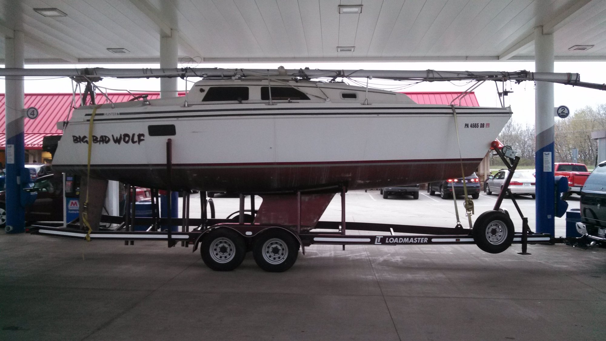

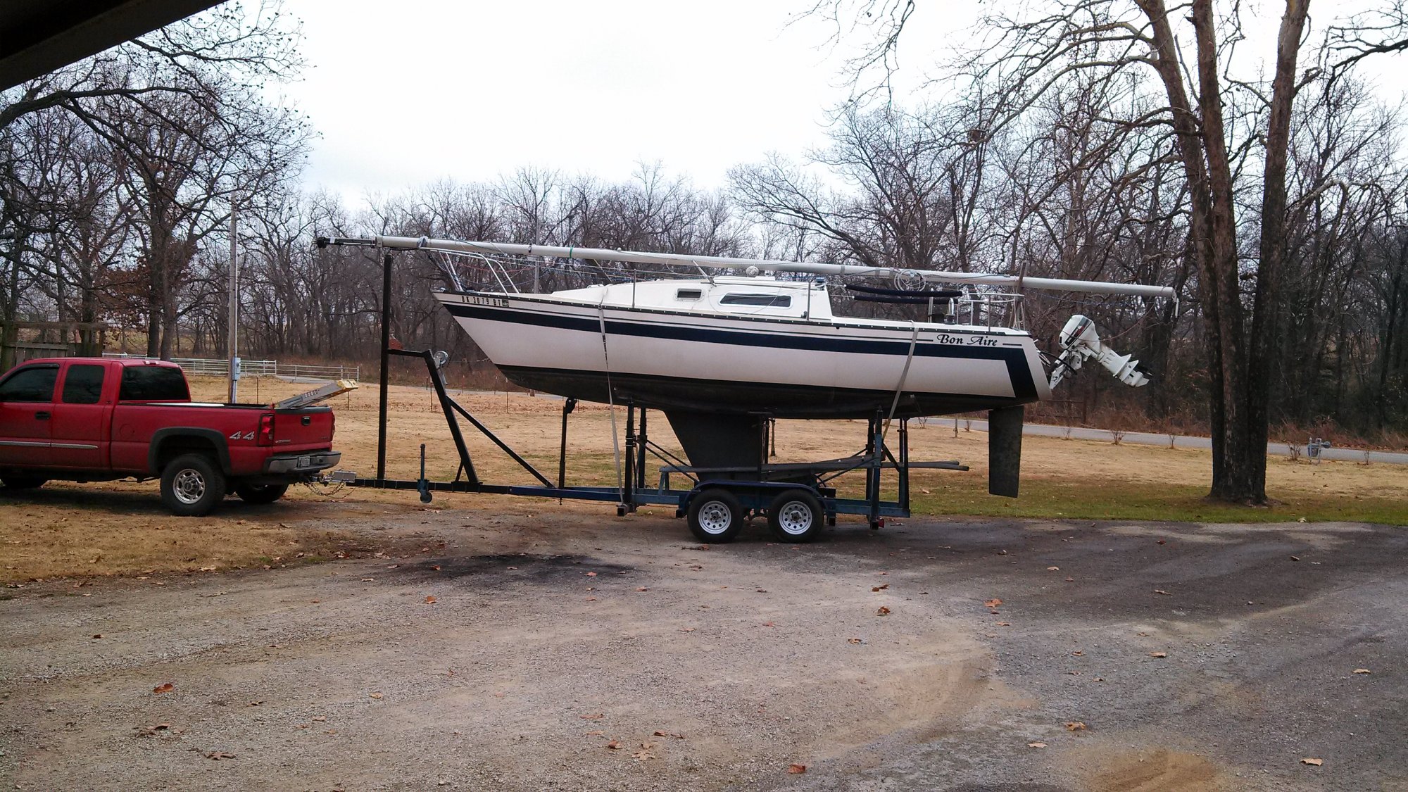

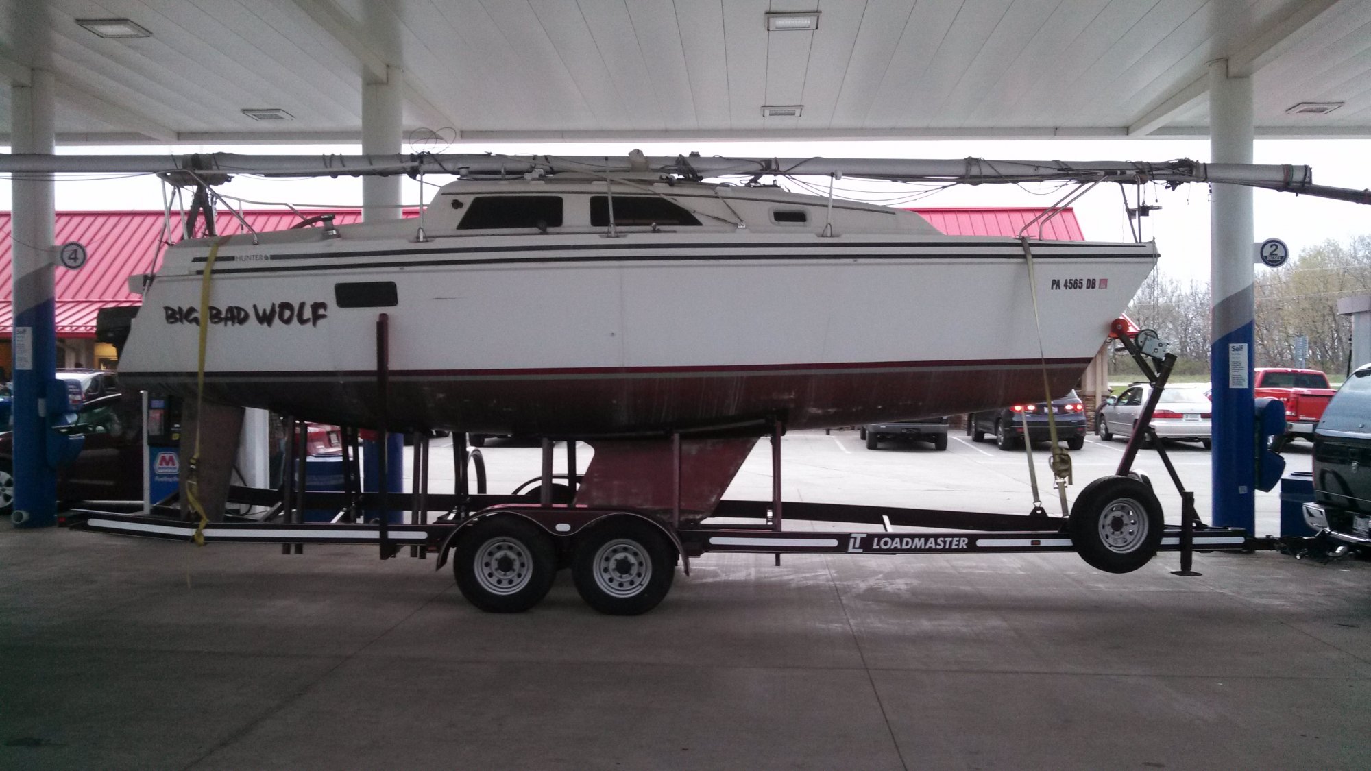

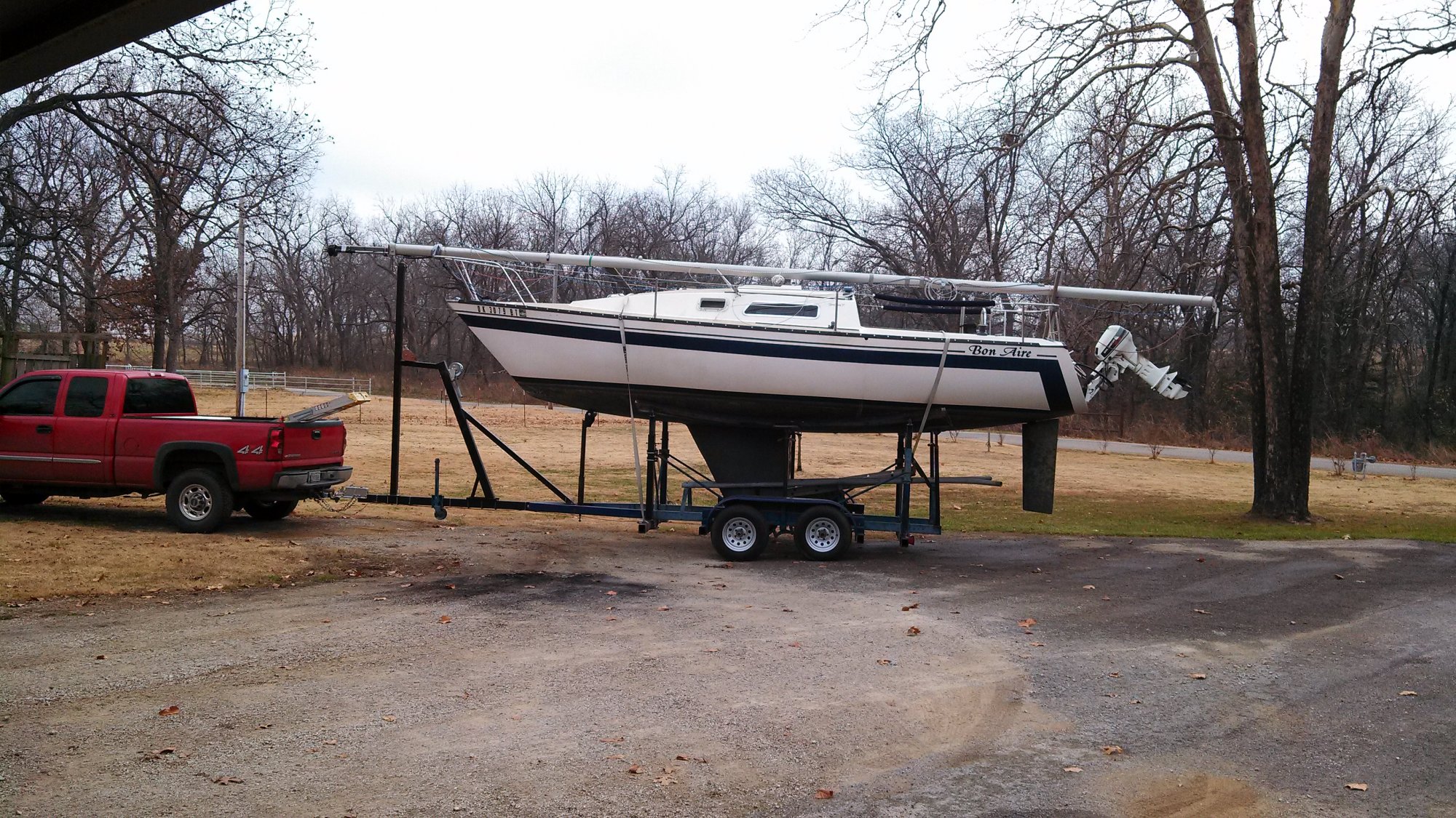

I trailered my 9.5' wide San Juan 7.7m home from KY. Once to Ft. Gibson lake, home every winter from OOlogah lake. Did that for years. Never had a problem. I wouldn't want to do it everyday though. It was also 12.5' tall. Seemed obvious to me that it was over size.
Hauled a friends Cal 27-2 home for him. It was a short haul but had a huge hill near his house, the hill was worse on the way down.
Also helped a friend tow a Humter 27 from Pennsylvania to Dallas TX. No problem, but I think we were legal.
If you plan to go very far you better research the route. Construction zones can get very narrow!

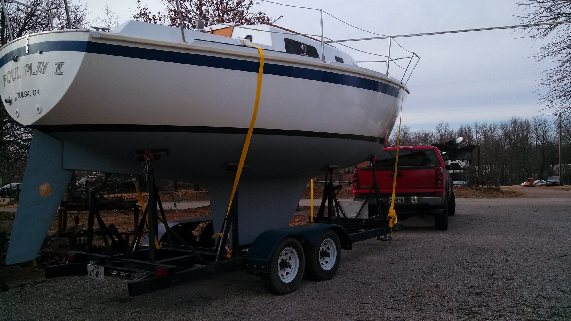

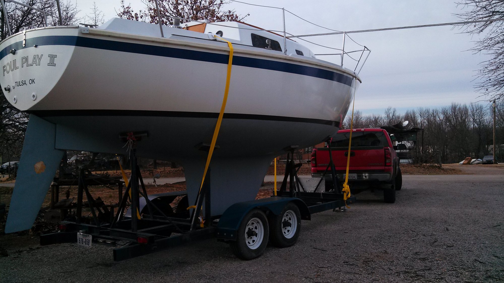

I have a 1995 Hunter 26. Boat has been trailered from east coast to Kentucky, and from Kentucky up to the Great Lakes more than several times. I've never been stopped nor do the signs bother me along interstates indicating wide-load restrictions in construction areas. These signs are for loads several feet wider than legal; our 5 inches are not going to make a difference. TRAILER AND SAIL ON!
