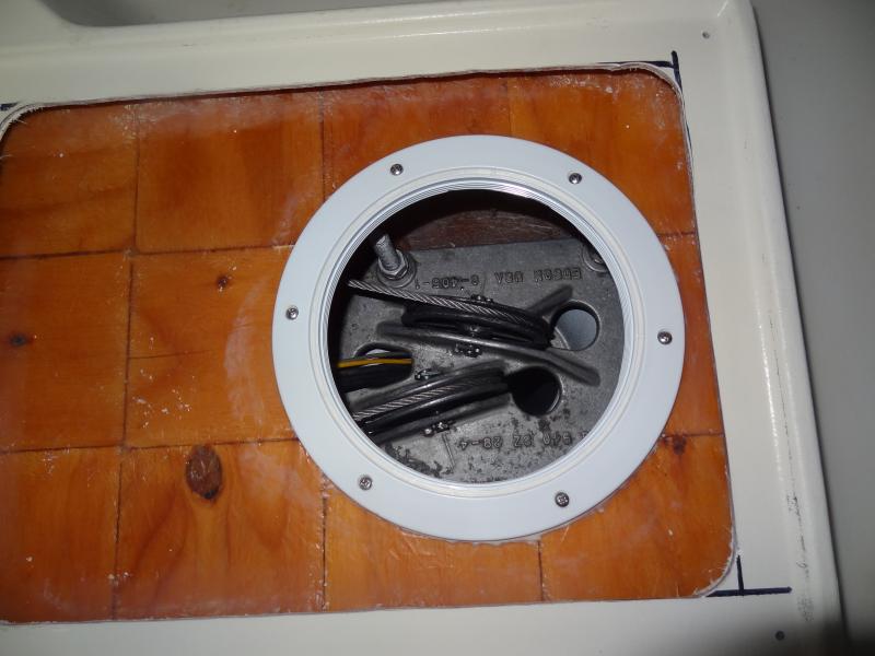

I jammed the wheel last weekend on heavy winds. I was able to put the cables back on the pulley blocks under the seat (thinking that was the only problem). However, it wasn't the only problem. Something is going on in the Edson pedestal....I took the top off and the chain can be easily lifted from the rack.....it looks like the cable is off to one side farther down and I can only turn the wheel a short distance.
Does anyone know how to fix the cable inside the pedestal. Any "watch outs" ? Do I have to take the pedestal off the deck?

Mark,

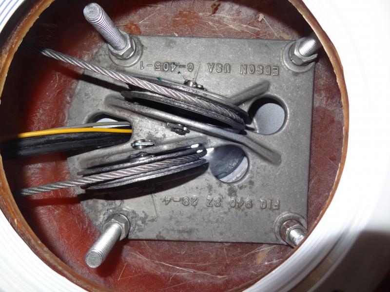

Here what I believe is happen to you: When the cables do not have enough tension they can jump off the pulleys and can get jammed under the pedestal. Picture 1 shows how it looked from underneath on my 2005 H260 after drilling the access hole.
In my case all pulleys were sized. I had to put that access hole to get too it, even removed the pedestal to dissemble the rollers and make them running smoothly again. As I reinstalled the cables one got off the roll track and jammed. And as more I pulled as more badly it got jammed.
I believe you have to drill an access hole to reach in and solve the jam.
See my thread “Pedestal Guard Installation”, under Smaller Boats http://forums.hunter.sailboatowners.com/showthread.php?t=159592&highlight=Pedestal+Guard
It will tell you how to cut the access hole and with what tool. Yes, there is some work in front of you but you will be glad to have a better control over the steering mechanism. Good luck,
