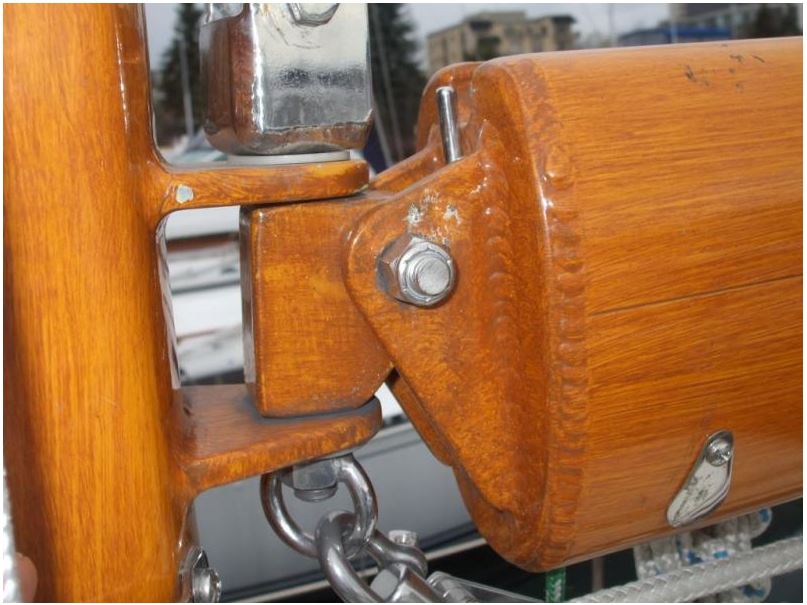

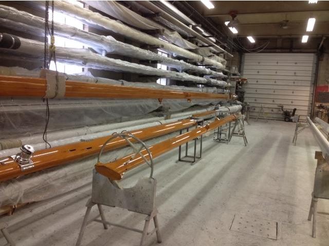

Our mast for our 23' O'Day was stolen over the winter years ago, and we commissioned a new mast from a local boat builder. It was expensive, but well worth it. Almost like having a new boat.
