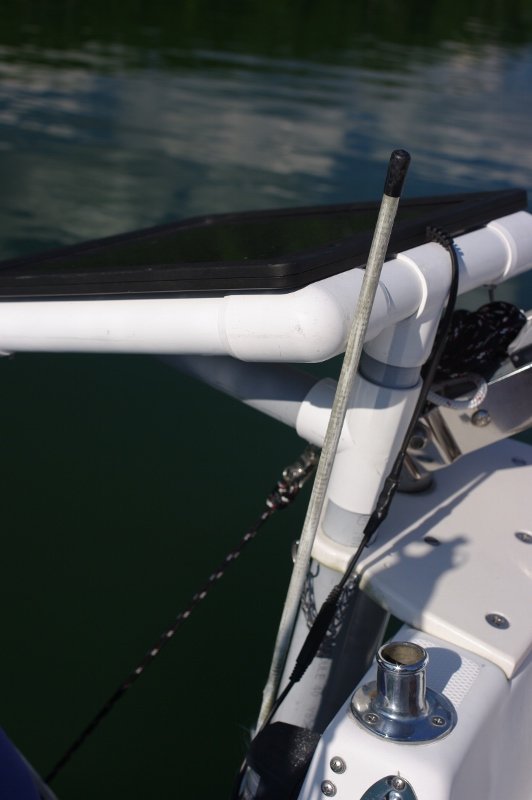

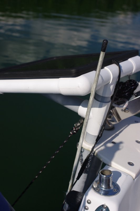

Not sure if this would work on a 260, but on my 240 I made a solar panel mount with PVC pipe and used the mast crutch holes to mount it. The panel is a 5-watt Sunforce I think. Has worked great for my limited power needs.

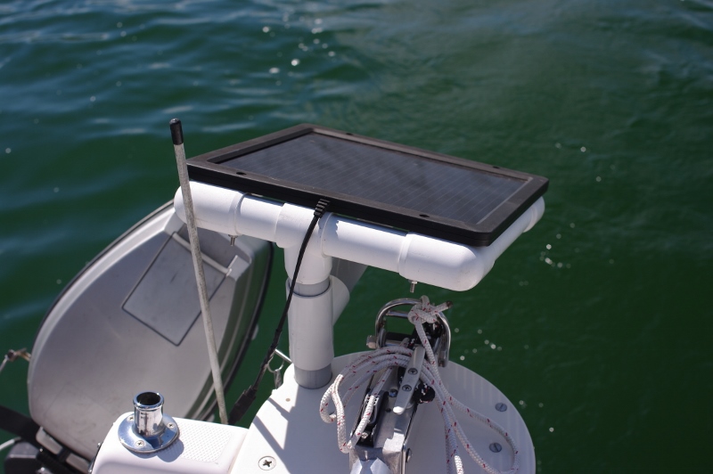

I mounted a solar panel over the rudder attached to the stern rails . I have to house batteries on the port side with a controller.
T9.9 outboard charges one of the batteries also. I have a battery charger but never use it as both batteries stay charged with my limited draw.

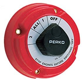

Do you have two battery system and if so a battery selector. When running, your engine if electric start will be charging what that battery selector is set to. Food For thought. NEVER SWITCH THAT SELECTOR WHEN MOTOR IS RUNNING!!!!!!

There's a picture of a selector switch Crazy Dave is referencing, attached.
