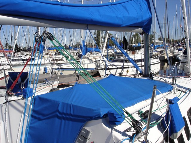

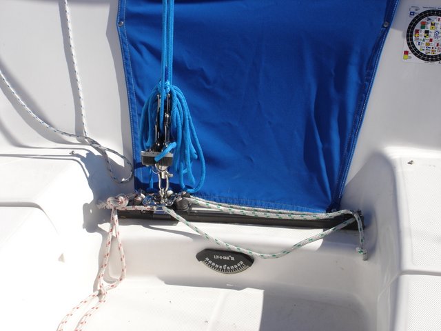

The small traveler made it difficult to center the boom when racing ..... even tightening the mainsheet excessively did not center the boom. I added the red & green lines and blocks(4X), attached to the strong stanchion bases, to center the boom .... this leaves the mainsheet free for optimal trimming of mainsail shape.
In the background you can see the "tenting" of the sliding hatch cover to minimize the chances of rain getting into the cabin. We added 2 "D" rings to the top of the hatch cover and use a bungee to pull the hatch cover up. The sliding hatch cover was made by the Sew Shop in north central Florida.
