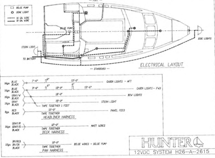

Looking for the best way to route the wire from our new motor with electric start to the battery which will be in a compartment below in the bow. Hunter 26

Welcome to the forum!!
From the Hunter 26 owner's manual attached the original wiring was routed in a harness above the head liner. If that is not possible, suggest routing it in the port or starboard wall.

I have a tohatsu 6 with an alternator wire. I put a small hole in the starboard side of the engine well and fitted a rubber grommet in the hole to keep water out. The wire once inside the boat was routed to the battery behind the aft bulkhead and was zip tied to other wires already routed in that same area.
