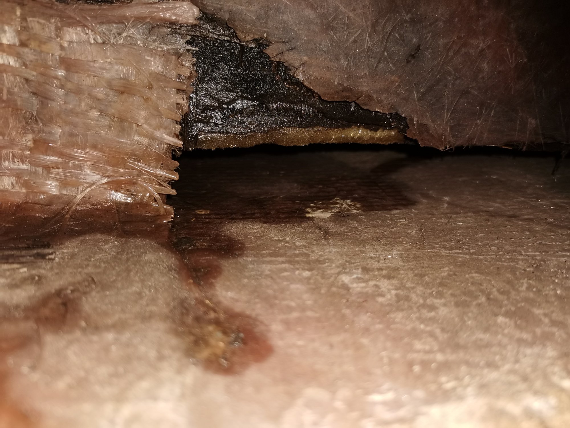

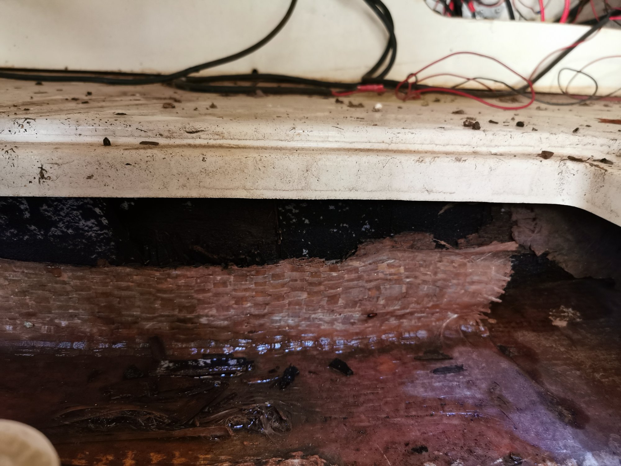

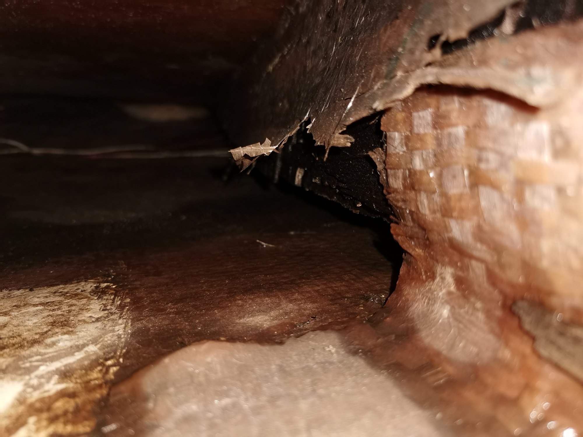

I looked at a 26 today. It's been sitting on the trailer for the past 5 years. The rear hatch leaked and the bathroom walls to the left of the door and adjacent wall are completely rotten. I can tear these out and replace. There is a piece of wood in the aft bilge area that is complete mush. I can't even figure out why it's there. It's aft of the bilge pump and between the decks. Was this just support for the fiberglass? It seems like it should have been glassed in? The rest of the boat all needs work, but it does have an almost new Honda and Edison wheel for $3500. I would love to hear people's opinions... PS love the boat, just don't want to jump in and get into 400 hours of work...lol

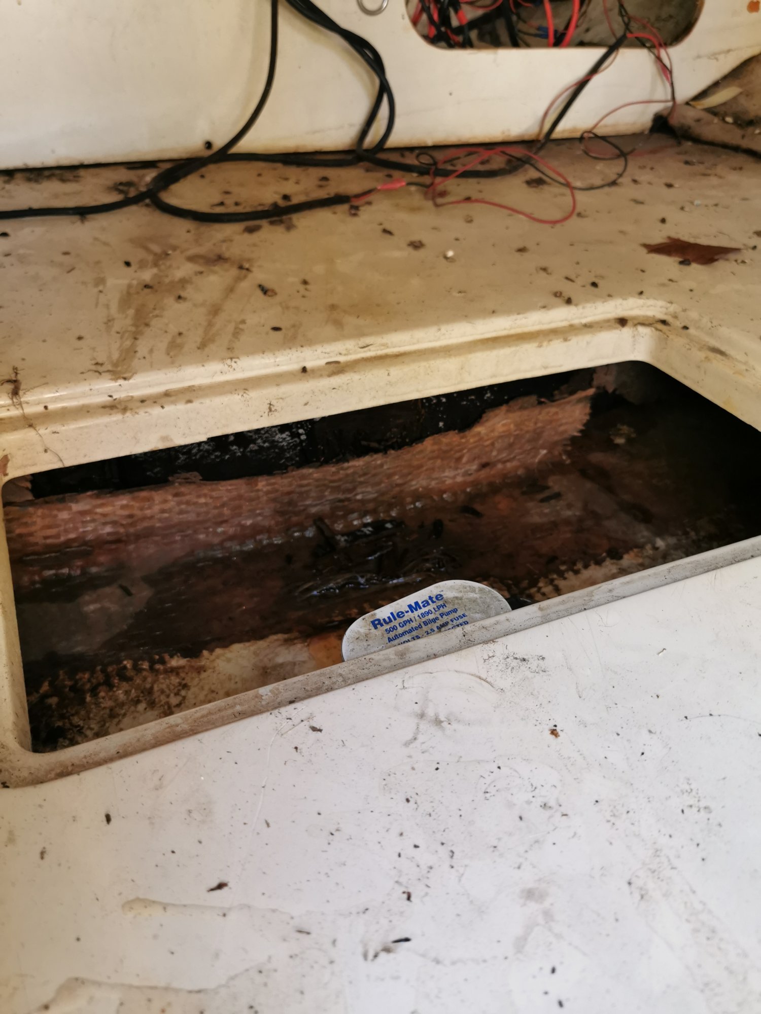

no it's a piece under the floor. it's about a foot behind where the pump sits. I think it may have been glassed in and maybe the current owner just broke the fiberglass off??? The current owner moved the batteries under the cockpit seat.

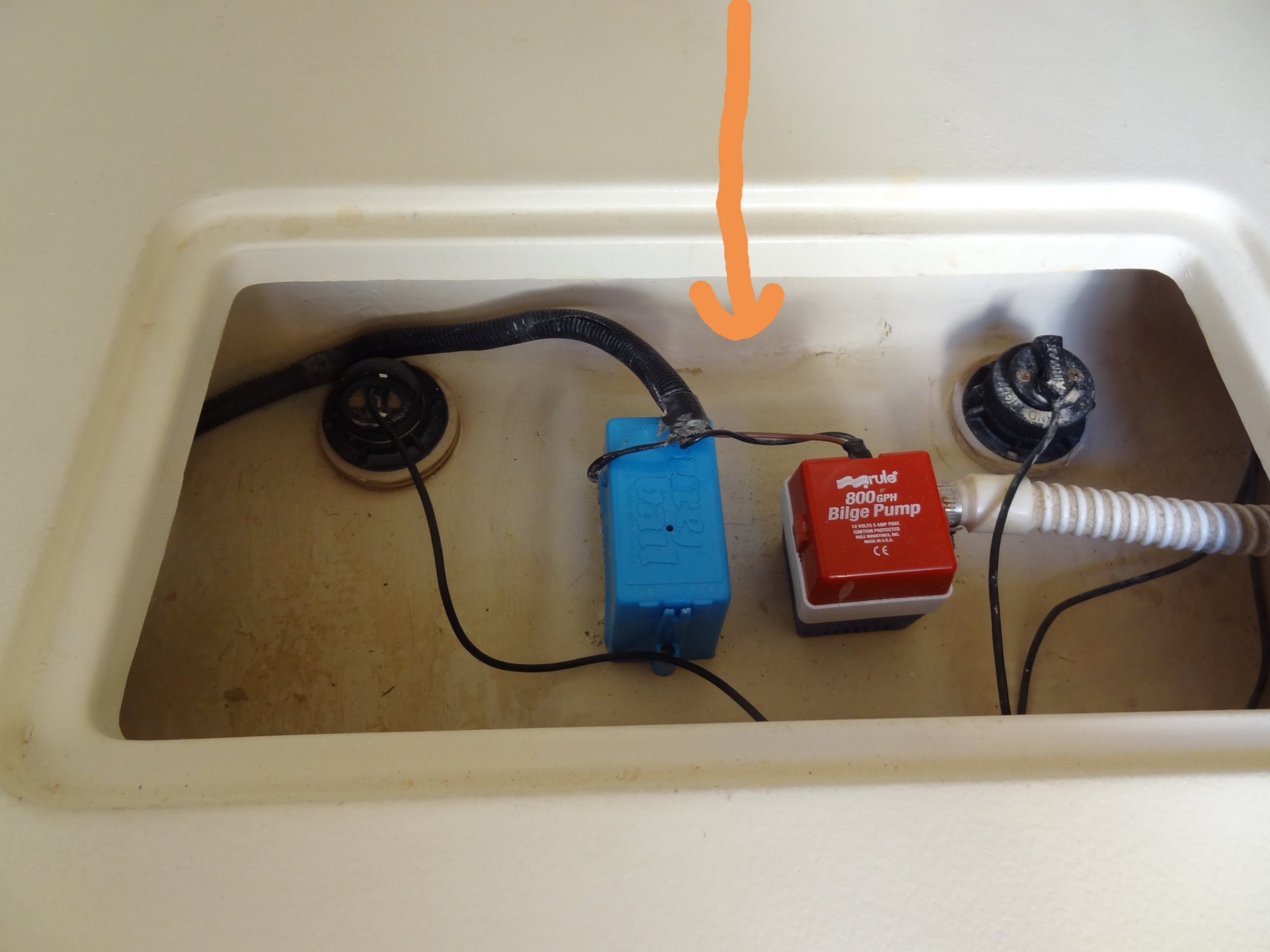

Oh boy,I found a picture of what that bilge is supposed to look like... This boat does not look like that.. The orange arrow points to the back wall, which is completely missing. Is the area behind that
just an empty cavity the whole way to the back of the boat?

So my memory is a bit fuzzy here but I think I am also missing the "back wall" of my bilge. I'm wondering if your P.O. just jammed a piece of wood in there because it was flexing and he wanted to stiffen it up. If that is the case, you could cut a piece of treated 2x4 and repeat and you would be okay for 10 or more years. If you keep the boat dry, it will outlast you.
Or you could do it correctly and glass in a stringer underneath. If you have never done that sort of work, start a new thread. A lot of us (myself included) have experience with glassing stringers.
Regarding the bilge on a H26. It really isn't a true bilge. How much water would you have to have in your boat before it even reaches the bilge? My bilge stays dry and when a little rain does get in the boat, it accumulates against the sink in the head compartment. I sponge it up and squeeze the sponge out in the sink. The H26 bilge is more of an emergency bailing device in the unhappy event that a big swell comes over the transom.

thank you! I'm guessing water leaked in the back cockpit hatch and has been sitting there for quite a while. it all makes much more sense realizing there isn't a real bilge area. with no below water thru fittings I don't see how anything can get wet.

7
